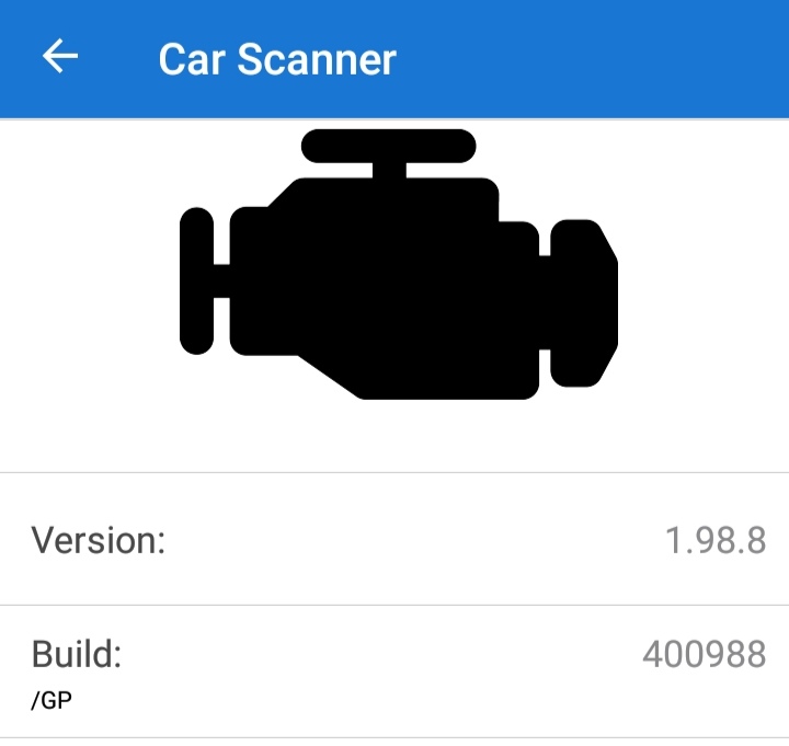

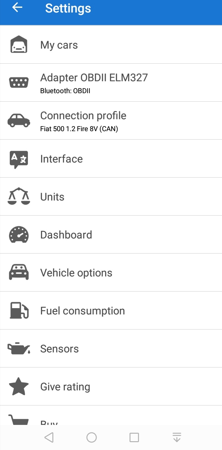

If your ELM is Bluetooth and you have an Android phone "car scanner" works on my phone(set as a 500), and "torque lite" works on a different android phone

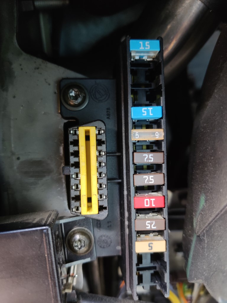

Thank you for the replies so far! The pins on the OBD socket looks fine.

Right great feedback @ArttuNaattor 👍
Everything else is canbus
Sounds like software and adaptor are all okay but you have no communication on pin7 K-Line the ECU
Factory radio or aftermarket
Measure the voltage between these two pins
Just touch the top of the pins with the probe
If you jam a probe in it will damage the pins
