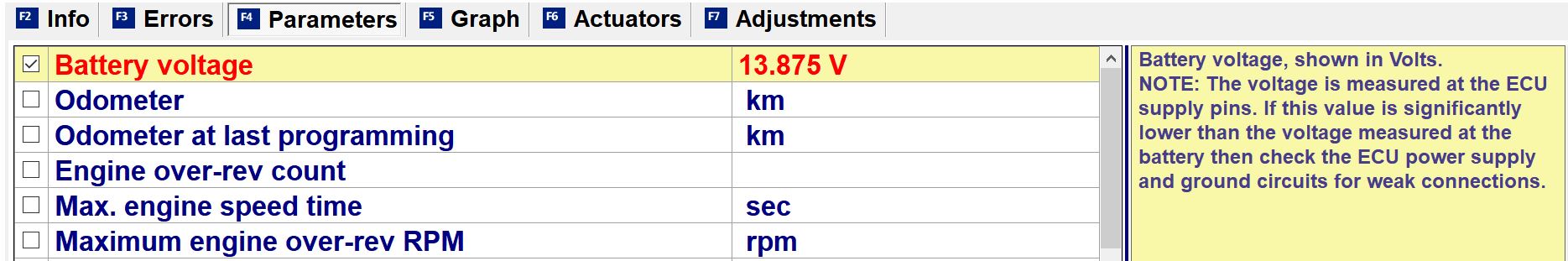

TLDR - Startup issues at cold engine/cold weather, multiple codes. Wiggle injector plugs to get it starting. Low and unstable battery voltage measured at ECU, good stable voltage at battery and chassis.
Summary
  • Bat Voltage at ECU fluctuate between 13.7 - 14.0
  • At battery and chassis, stable 14.4

Battery voltage inconsistency
With Multiecuscan, Battery voltage measured at the ECU is fluctuating and significantly lower than i measure at the battery and between batter and chassis.
  • At the battery and chassis I see 14.4v stable on my multimeter
  • At the ECU its fluctuating between 13.7 and 14.0v

Just took it out for a drive and connected the pc again.
When the engine is warm, battery voltage readout on the ECU is more stable at around 14.2. Still 14.4 at the actual battery and chassis.
I'm struggling to wrap my head around this. As long as its warm outside or engine is warm, no issue.
I had 1 incident this summer when leaving north Norway at the end of July, it was around 5c and had few engine halts, also code P0200. But once warm, the entire trip back to Amsterdam went without incident.
Its not so cold now, but this is how it reads on cold engine
Completely off battery 12.95 (Its almost brand new battery btw)
Ignition on, engine off:
Battery 12.37
ECU reads stable 12.125

When you get multiple unrelated electrical issues/warnings, this can be a sign of a problem that is common to several circuits. The main examples are power feed wires, fuses and switches that have multiple "customers". Equally, ground points may serve several unrelated circuits.
The ECU to injector wiring has "flow" and "return" wires for each injector. The injectors are almost completely independently wired (Injectors 1 and 4 have one return, Injectors 2 and 3 another) so I cannot see any single connection failure that would stop them all from working properly.
The ECU is grounded by several pins, which join together in the wiring loom to a single large (6 square mm) black wire that goes to the Left Front Earth C010. I recommend you check this earth is OK, as any problems here could cause all sorts of issues. The location of this earth is on the Right of the vehicle as you look at it from the front, and low down in the engine bay. Sorry I don't have more detail, the drawing in the manual is not very good ! I also don't know if it is to the body/chassis or the engine block. This C010 earth is also used for headlamps and the glow plug module.
The earth strap from engine/gearbox to body/chassis is a known weakness. They look OK but go high resistance when corrosion starts within the crimped end lugs. A good strap is about 0.001 ohms, so ordinary test meters are nowhere near good enough for checking.
As has been stated the engine/gearbox to chassis earth strap is a known weakness of the x250 Ducato.
The use of a jump lead between battery negative, and an engine lifting lug, is a possible way to eliminate the earth strap as the cause.
I am not familiar with the x250 wiring, as my vehicle is an x244. However I note that the ECU earth point C010 is in the same location on both models. On my x244 the earth point C010 is easier to see from underneath.

Last year I did replace the earth strap from battery to chassis under my seat, which should be a decent job. (It was very bad) I had very bad voltage from the Alternator. Went from 13.8 to 14.4 after this.
I also added a second strap from chassis to the underside of the gearbox (35mm²), I am less confident I did that good. Obviously also very exposed.
I also did replace the original braided strap with a35mm² crimped cable. The original one was pretty bad. All crimped myself using a heavy duty crimping tool. (also used for my camper build-out)
I am reading about adding a another strap from top of engine to chassis? Is that a good idea? And any tips of where i would fit it exactly? Min cable dimensions?
I will try to inspect the ECU earth point C010 (If can find it) and perhaps a closer inspection of other wires under the headlight.
