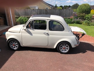

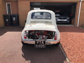

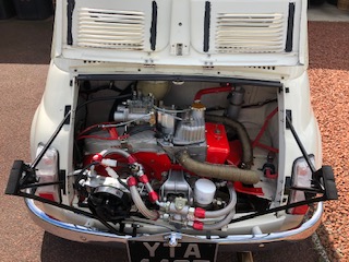

Hi, I have a modified engine and gearbox on my 500. I have found that with heat wrap on the exhaust downpipes the engine bay is cooler, but I have the addition of a thermostatically controlled cooling fan on my oil cooler and the engine bay lid is propped open to the horizontal. the fan helps draw air into the engine bay and even on a hot day I can maintain 90 to 95deg C oil temp - even if I press on (y)(y)(y) A fan on the engine bay cover would be difficult to secure and the power cable could cause problems. My fan is mounted on the rear crossmember (see pic) and draws air from under the car.
Ian.

Hi Bleeding knuckles, your car looks awesome! I have hinged my boot from the top with just 3" opening at the bottom , so I thought I would mount the fan on ourthe inside of the boot lid drawing air through the grill on the manifold side & blowing into the manifold. Don't know if it will have any effect!

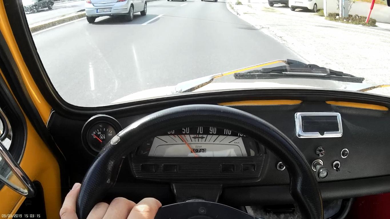

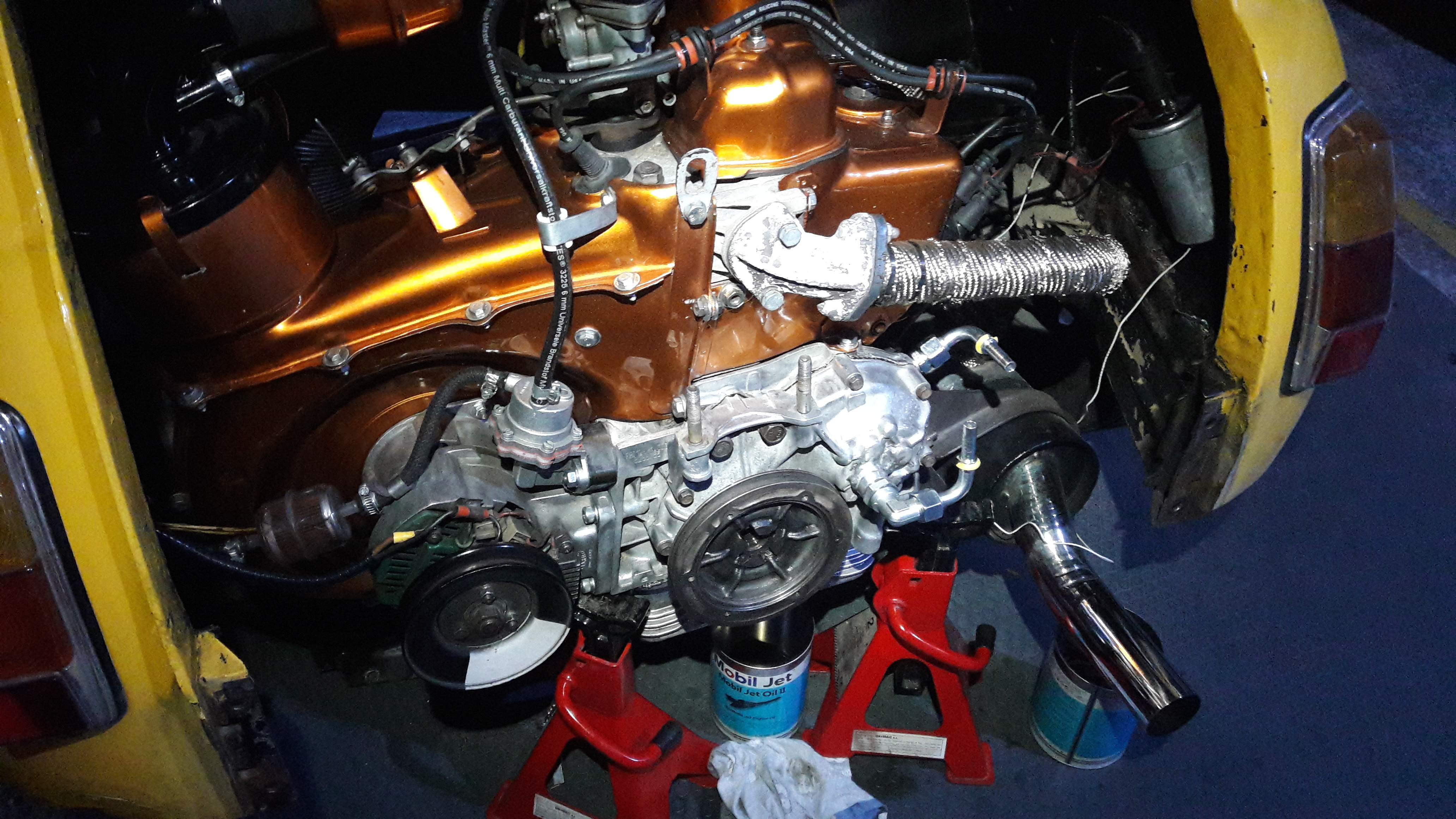

I think if you have reverse hinge your hood and you let it open from below hot air is going out of the bay when you are moving and this is enough. I am opening mine during summer. I have also wrap my pipes with special titanium tape and that reduces heat(y) but most important increases sound and backfiring:slayer::slayer::slayer: Here is my poor mans temp gauge installation since i can't afford abarth instruments:D
