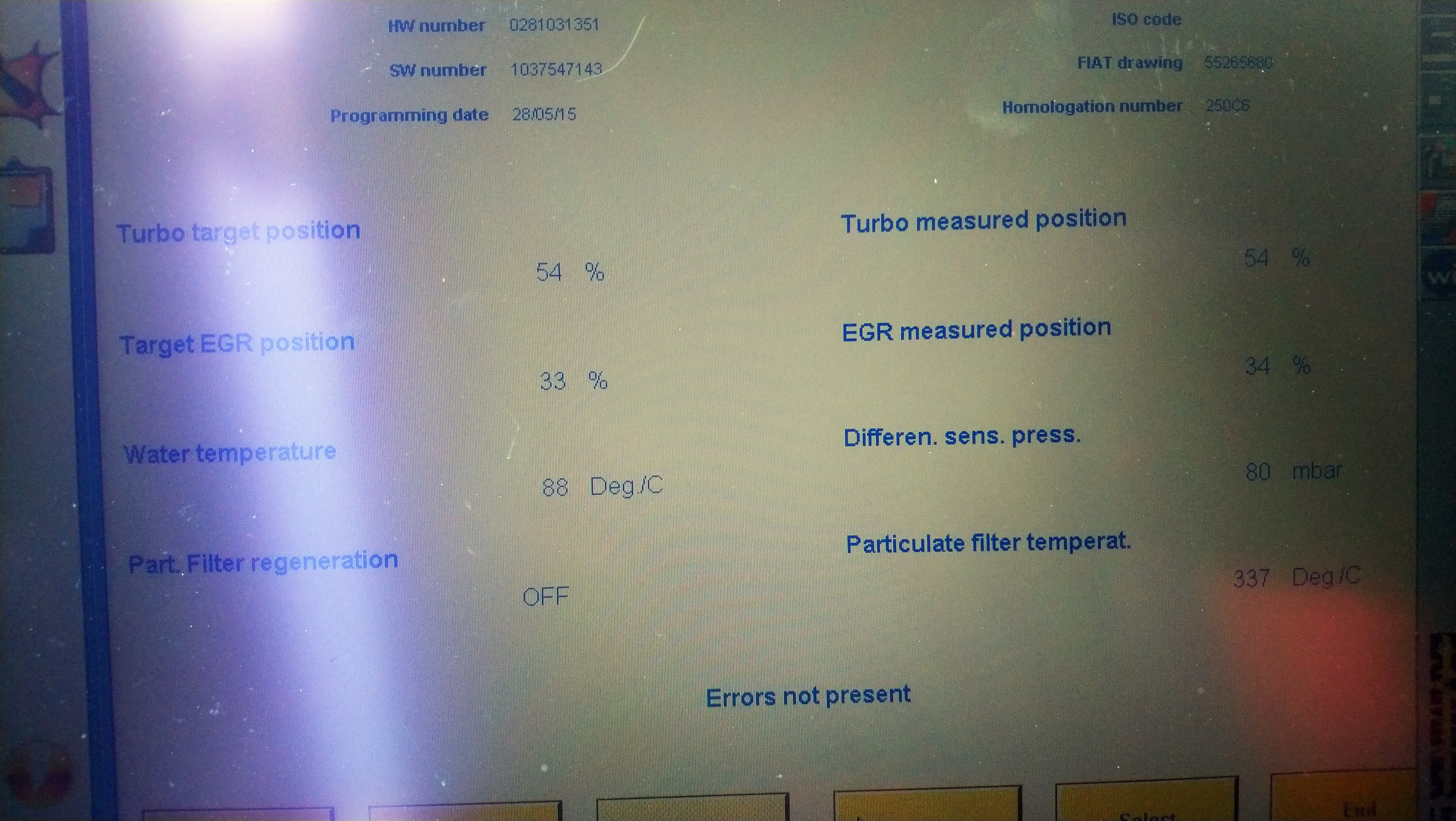

Have you rescanned the live data? Did you actually see the actual actuator line depart from the demand very much? Scope the air pressures too, on my van they follow exactly unless you coast the engine.

Service had been done previously that was my first port of call. Live data says that the air and fuel are OK. Done an actuator test on the turbo, tuobo position sensor says it is ok, done a command test on the EGR valve it is opening and closing, stripped the wiring from the EGR to the ECU all 4 wires are OK. I know what you are saying about logging a fault code but none are logged and none pending. I am using a fiat dealer diagnostic system. I WILL get to the cause of it eventually lol ?
