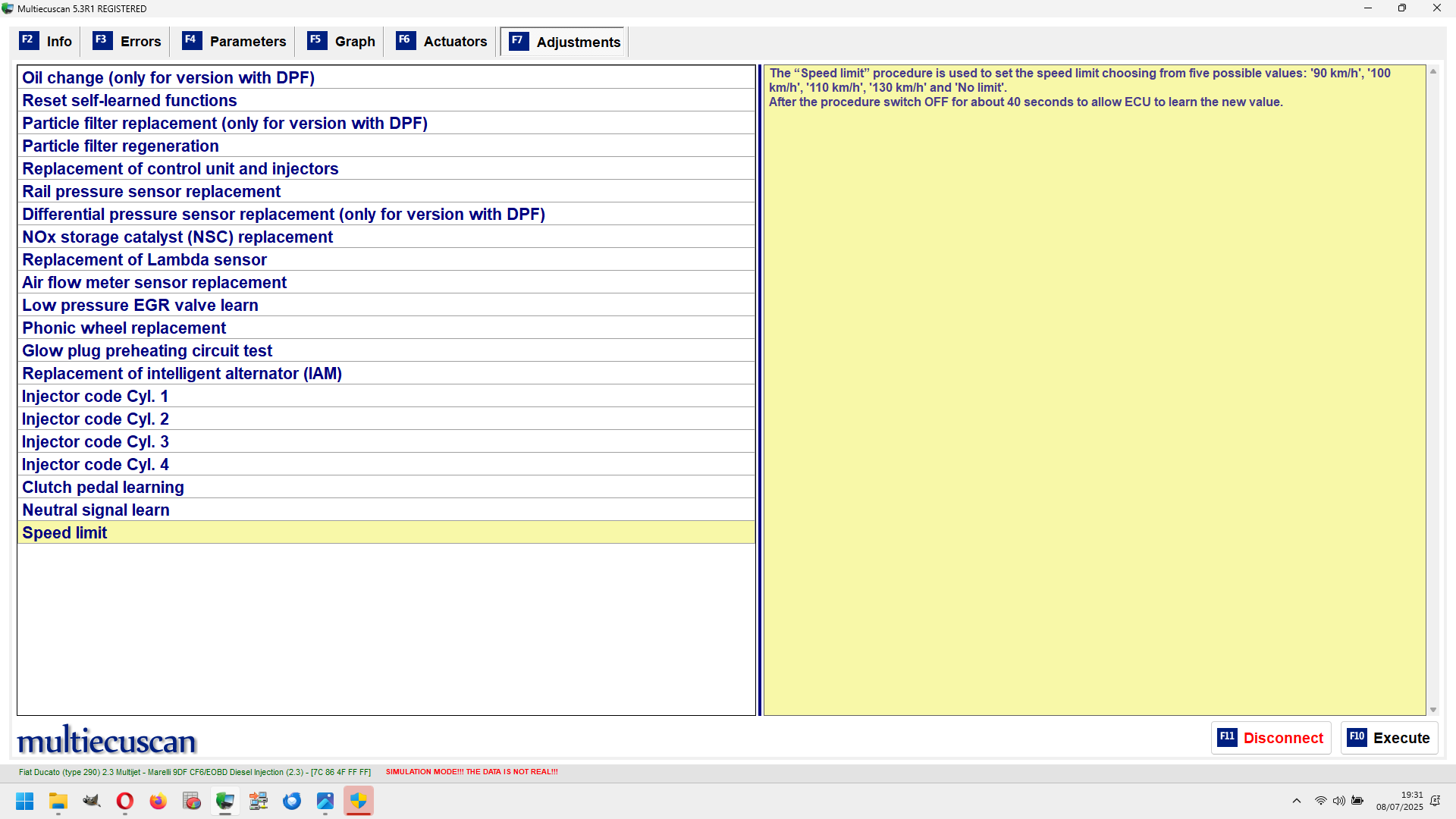

Hi thanks for the reply. I have mulitiecuscan and have unsuccessful tried to alter the speed.
How can I tell if i have a security gateway affected vehicle, I can remove fault codes etc?

You don’t have a security gateway otherwise you wouldn’t have been able to access the fault codes etc.
I think you need a cable with a resistor to be able to bypass it the details are in the Gendan site.
See the link above in @bugsymike post.
tWIN egr models did not have the SGW, manufactured sept 2016 to sept 2019, even later supply date for Motorhomes. 2.3 Adblu 2019 on may have the bypassable SGW. the 2.2 will have SGW in the BCM. I wish Gendan would update their website as opposed to the general SGW were introduced from 20xx. (initialy only on Fiat 500's.)
@proppb
you do not have a SGW.
Multiecuscan(to best of my knowledge) cannot reverse any speed restrictors.
@proppb
