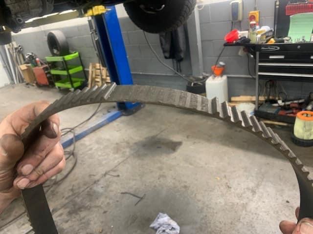

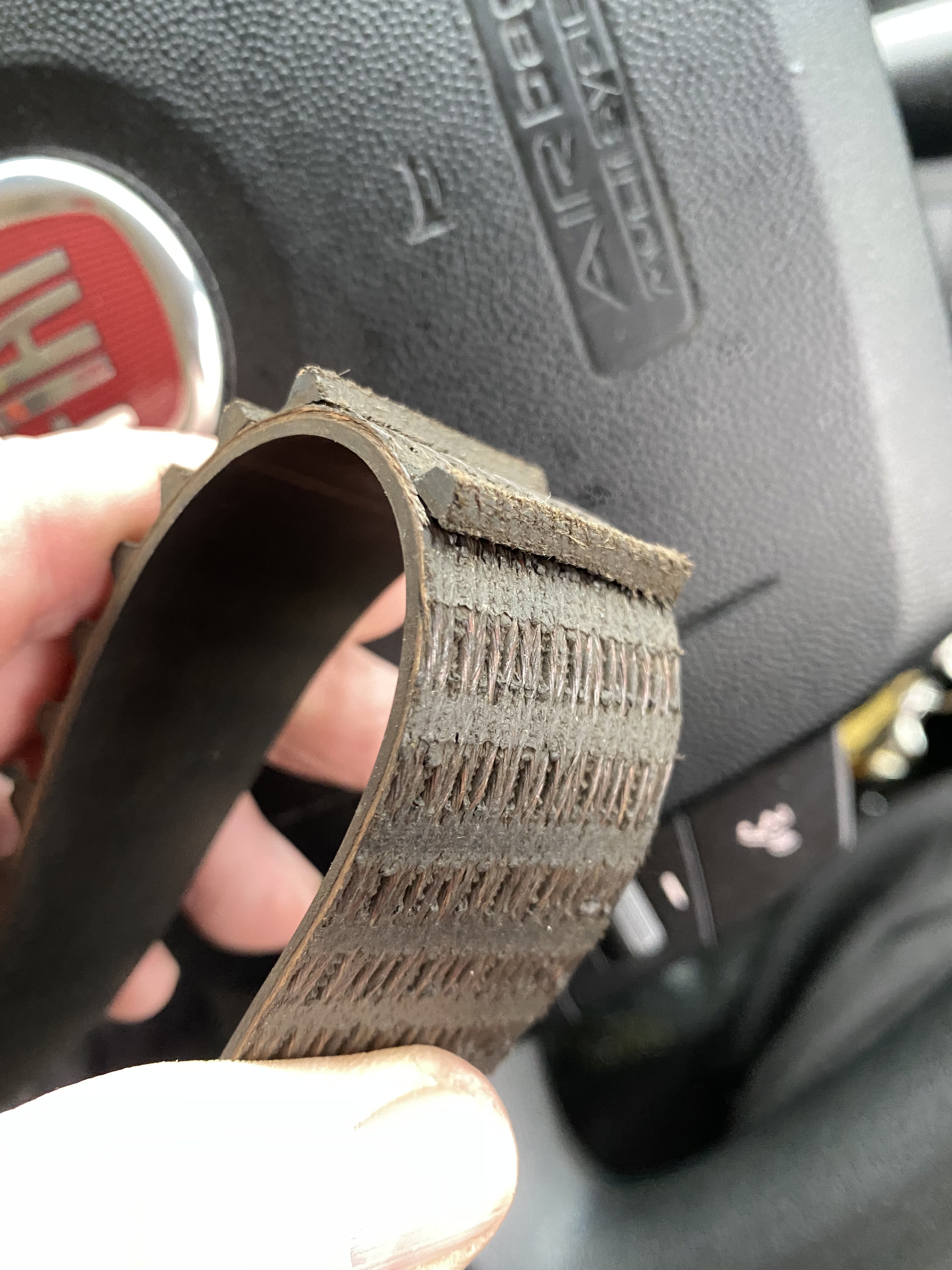

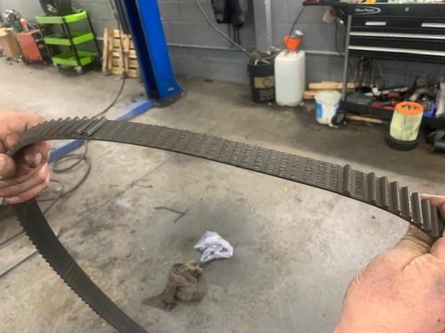

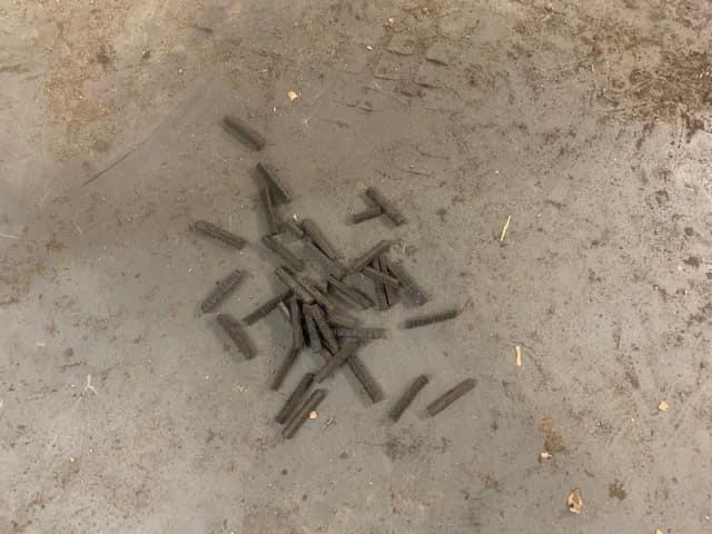

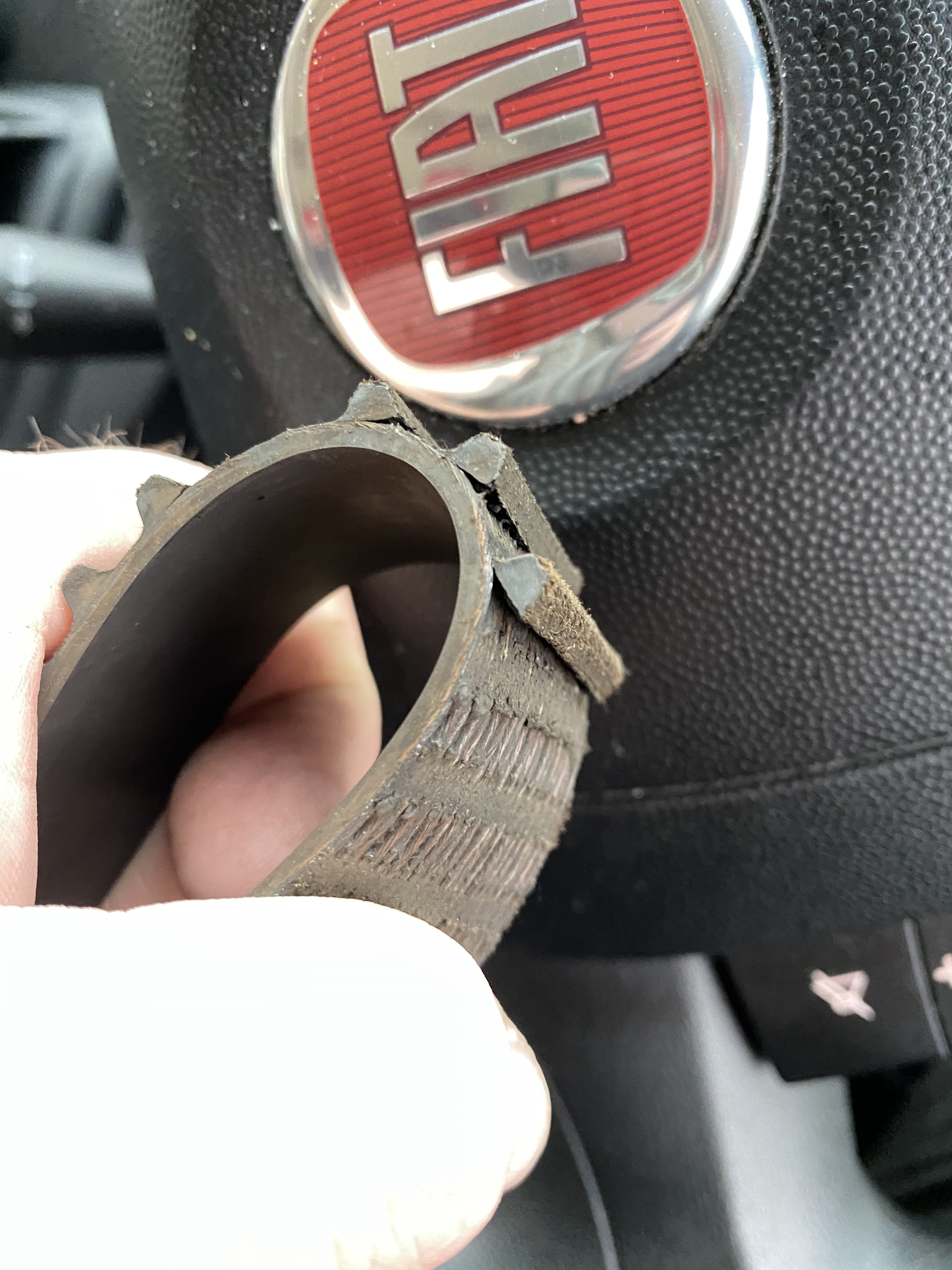

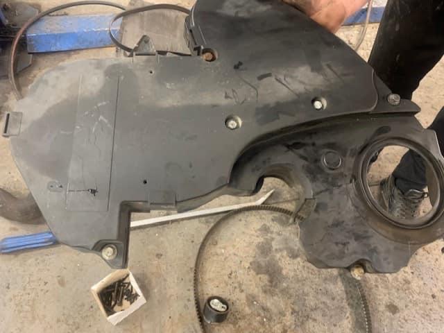

A year ago nov 21 (2020 2.3 180hp, 178,000 miles, 56k after Stoneacre (Vanworld) chesterfield fitted a new belt kit (note van still under 2yr warranty)
That belt stripped itself of @40% of its teeth,
Remarkably, a new belt kit sorted it, no damage at all,
However it’s worth noting that Stoneacre fitted a Non genuine belt, unbeknown to me, which wasn’t as well made or same size (width, thickness, no Kevlar reinforcement) and they had to pay the local fiat dealer for the repair
Shame it didn’t damage the engine as that would have cost them a fair bit
I’m told the engines (iveco) are designed to not self destruct, maybe the ice caused other issues
Hopefully it’s an easy fix

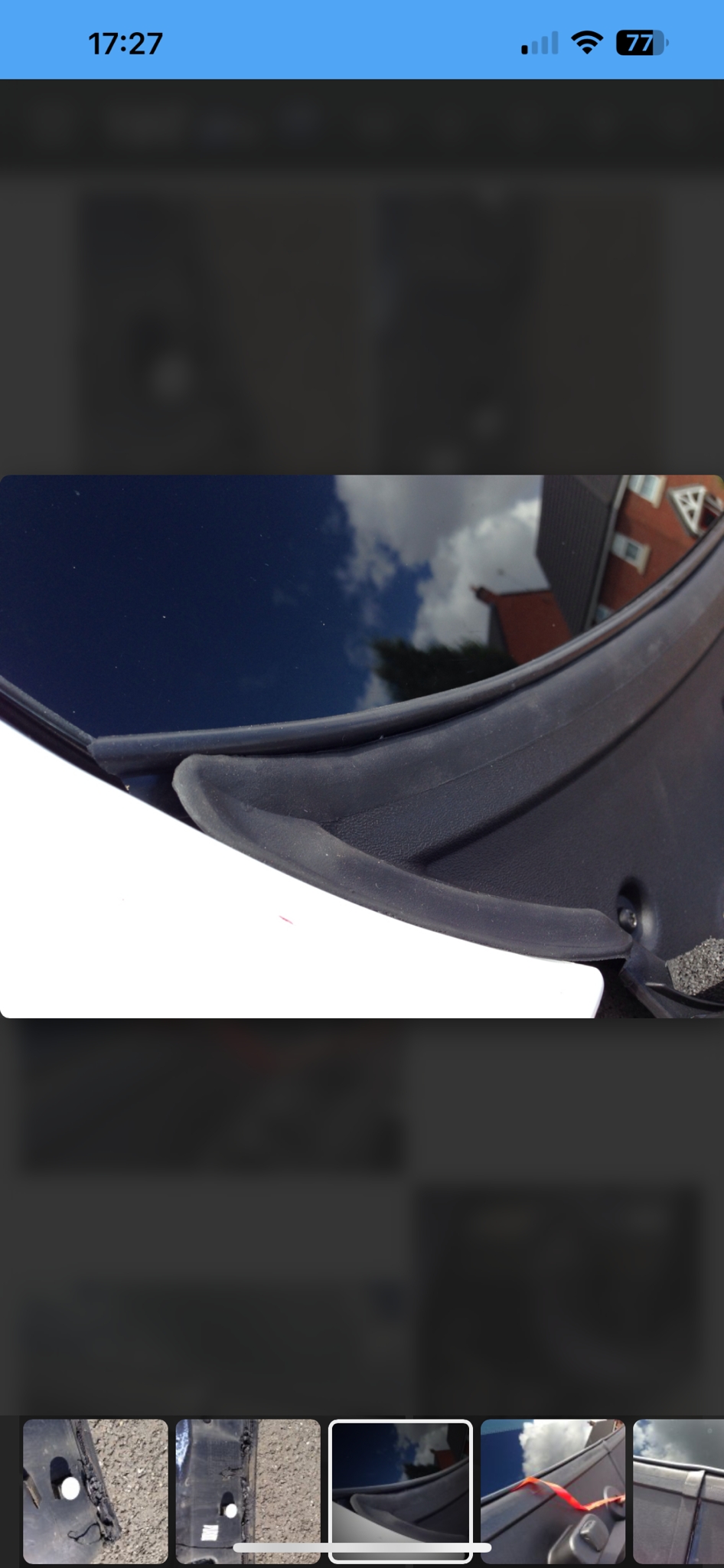

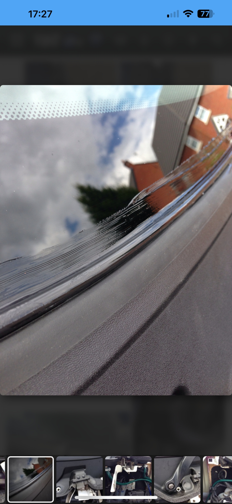

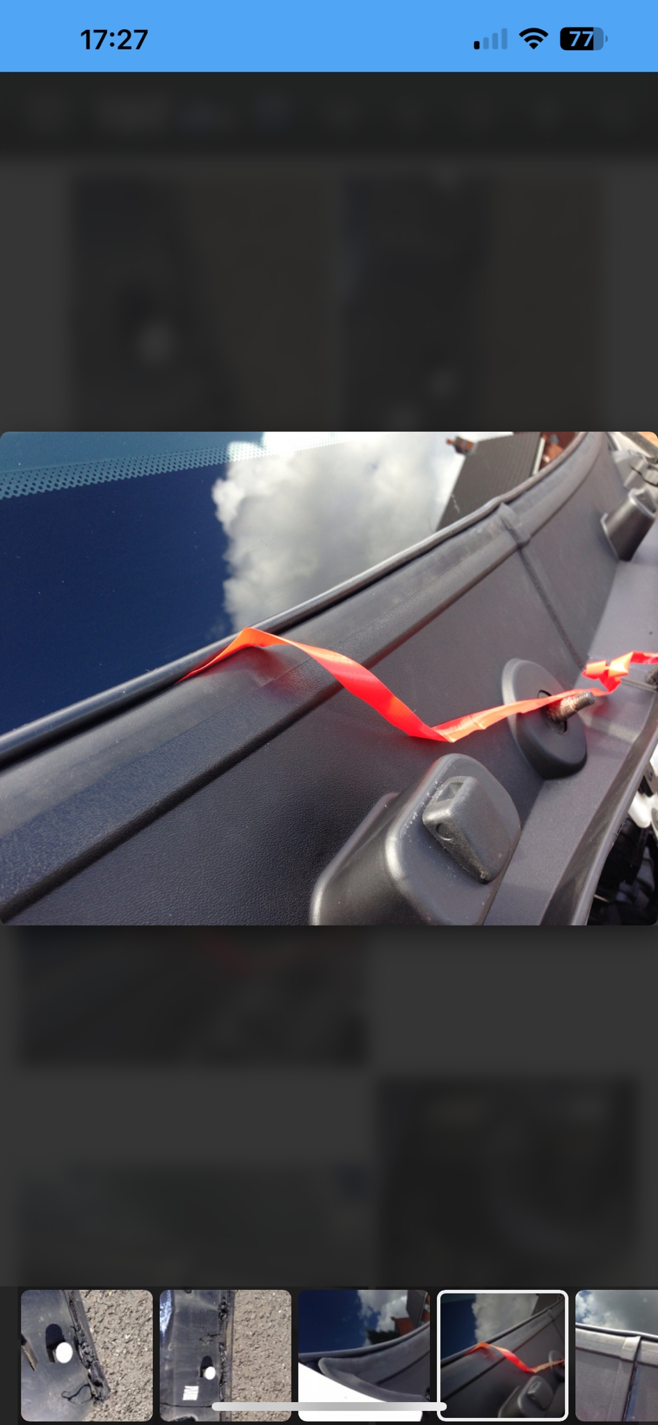

Over Xmas I noticed a lot of rainwater running under the scuttle grill, like the early split scuttles did, dripping right down near the aux belts, cam belt areas
So I’m awaiting new strip of “P41” P Seal from Seals Direct to come, will then modify using the seal and Sikaflex to stop this,
Maybe an idea to do yours
Pics from the aftermarket belt and old scuttle mod I’m going to do
Old scuttle mod

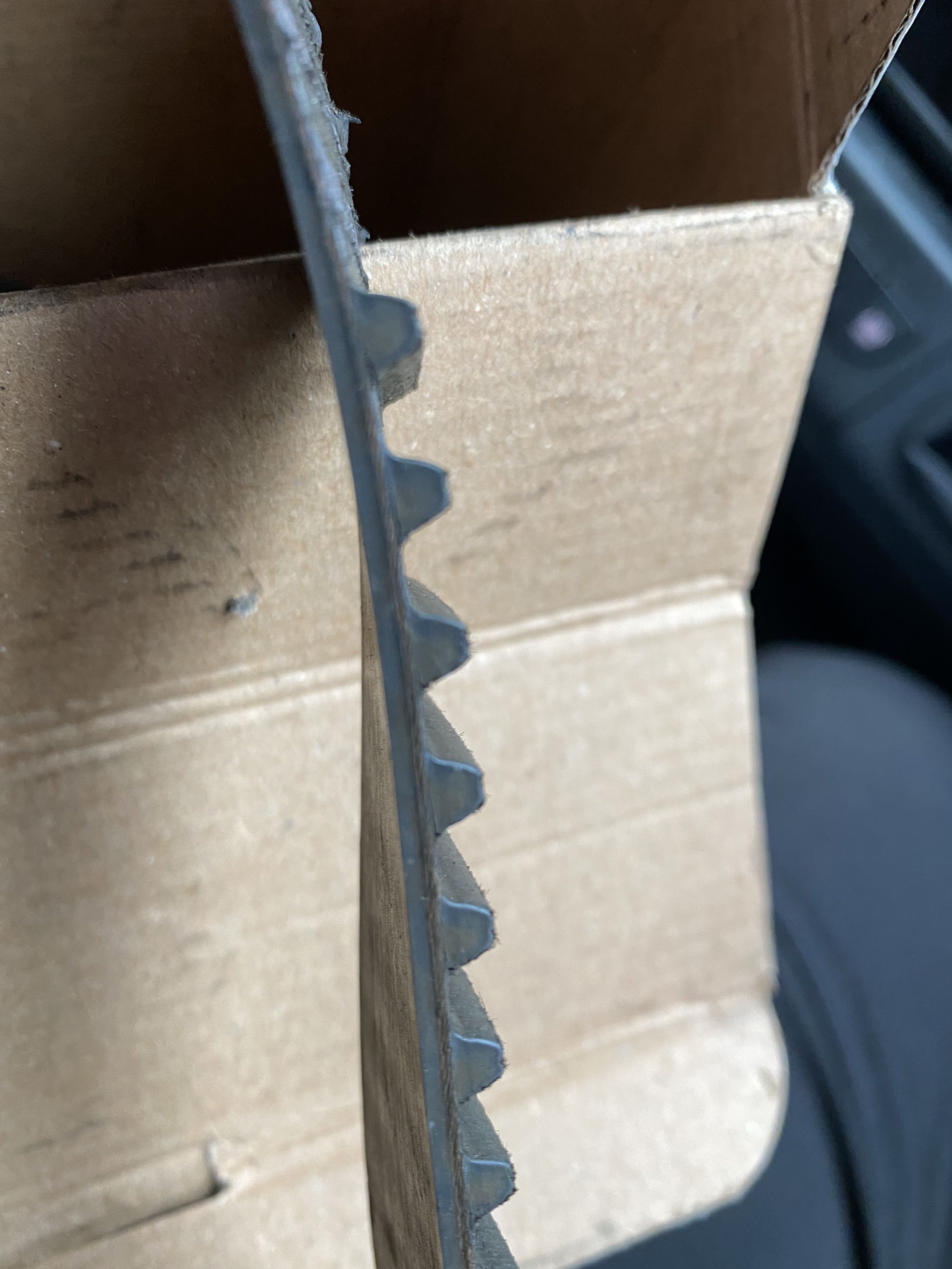

“INA” brand substandard belt
INA isnt a bad brand.. but obviously 'wrong' for that application.
OE on VW I believe, but definitely not up to std for the 2.3 lump
Mechanic compared genuine vs this, narrower just,
Thinner, profile of teeth wrong, no Kevlar thread impregnated into the rubber
Maybe ok on a 1.0 polo but couldn’t cope with the 180 horses of the Ducato 🤣
