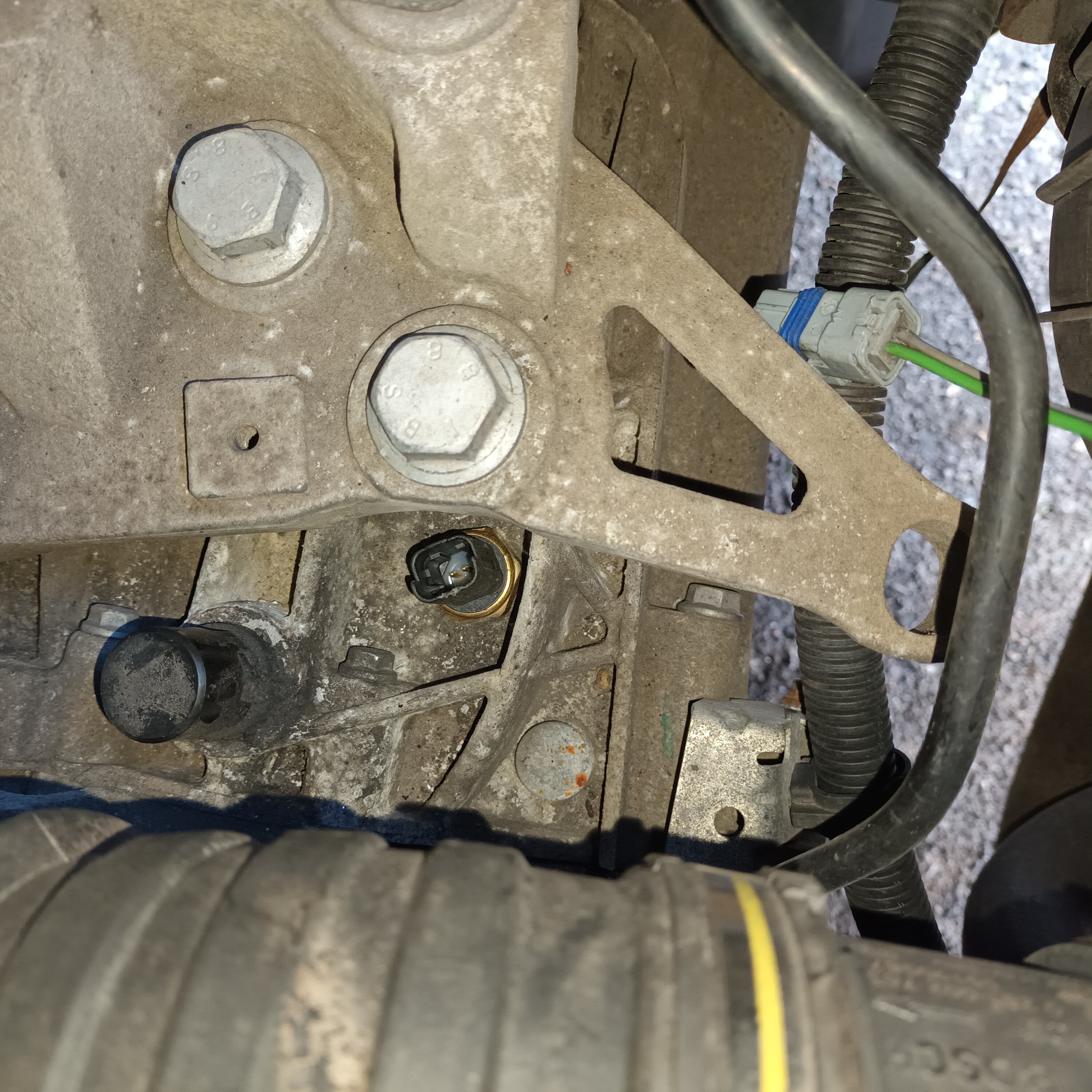

75+ elderly? Oh dear.Yep on top of gearbox okay noticed my camera had stopped working thought it was the camera but then getting ready for the annual TEST the reverse lights and beeper were not working tested the fuse and manual said 7.5 amp but there was a 30amp there but it was fine changed to 15amp then removed rear lens and no power at lamp! so decided must be switch and found it here! fairly buried as I am elderly 75+ tried to get a garage to do it but all booked up for 6 weeks ! Bit the bullet and got switch from main dealer and found my long 22mm socket a doddle to remove it but check first by joining wires on loom to confirm switch is the problem. Job done about 40 mins remove top of air filter to gain better access. Hope this helps guyz.
