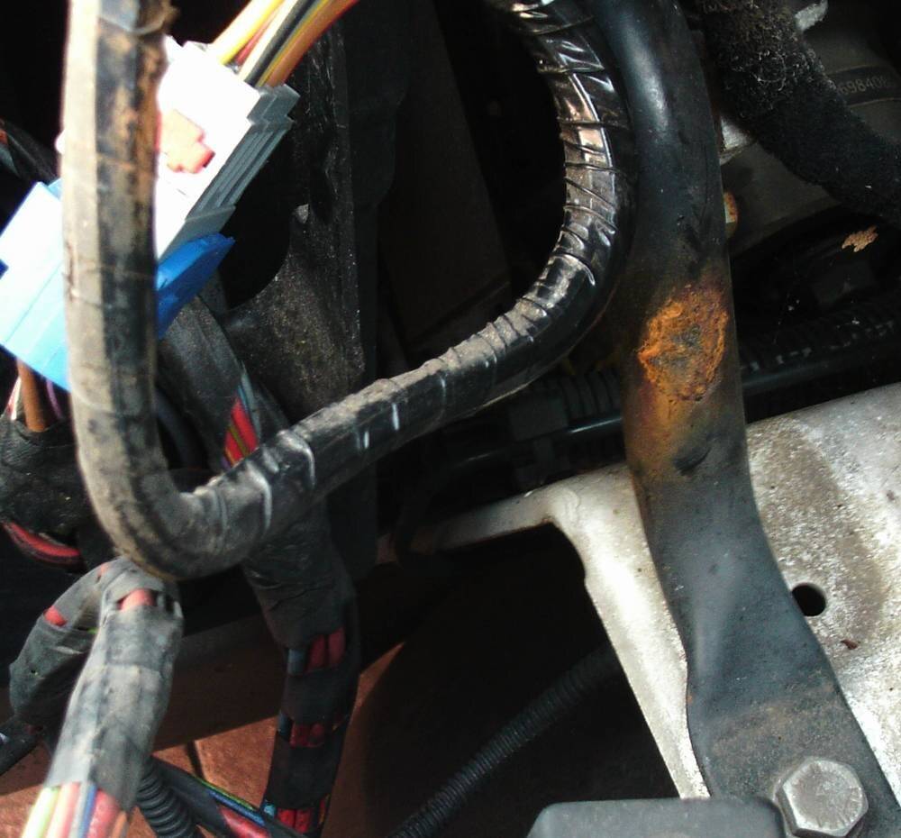

Have you checked the loom under the N/S X2/50 headlight?
You have to take the headlight out to see it - and even then its hard to spot because the loom goes over a smooth round tube where you wouldn't expect it to chafe. You have to pull the loom back to see whats hidden beneath it. Rubs off the paint, traps water, tube rusts making it like sandpaper and rubbing through the insulation. This can do all sorts of funny things to the electrics.
I taped mine up and protected it with rubber hose

aha, no I haven’t but that’s interesting as the breakdown guy that recovered it the other day also said that this could be the fault. I’m going to have a look at this first thing this morning 👍👍
Thanks very much & I shall let you know whether or not it’s this that’s causing the problem.
