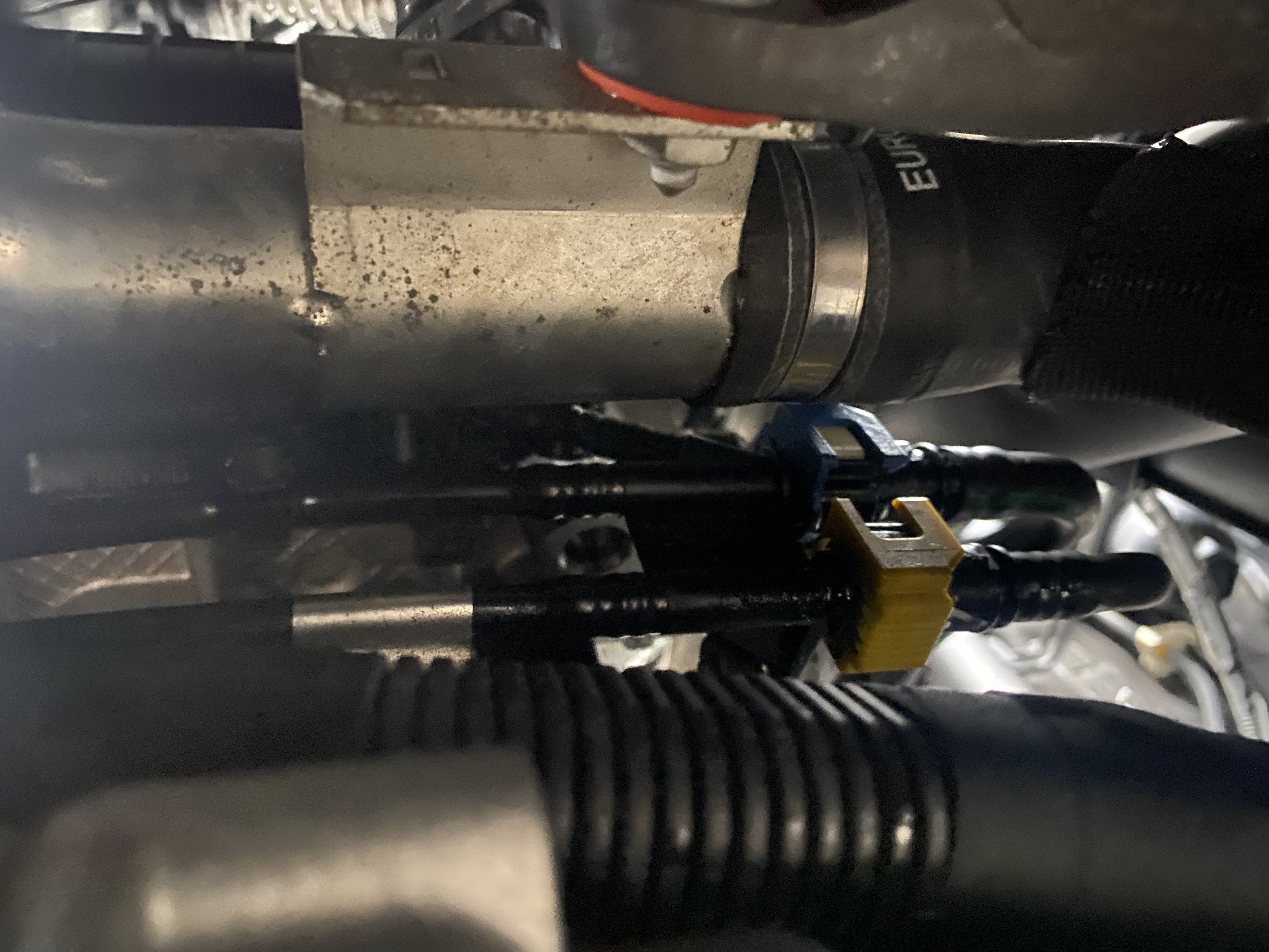

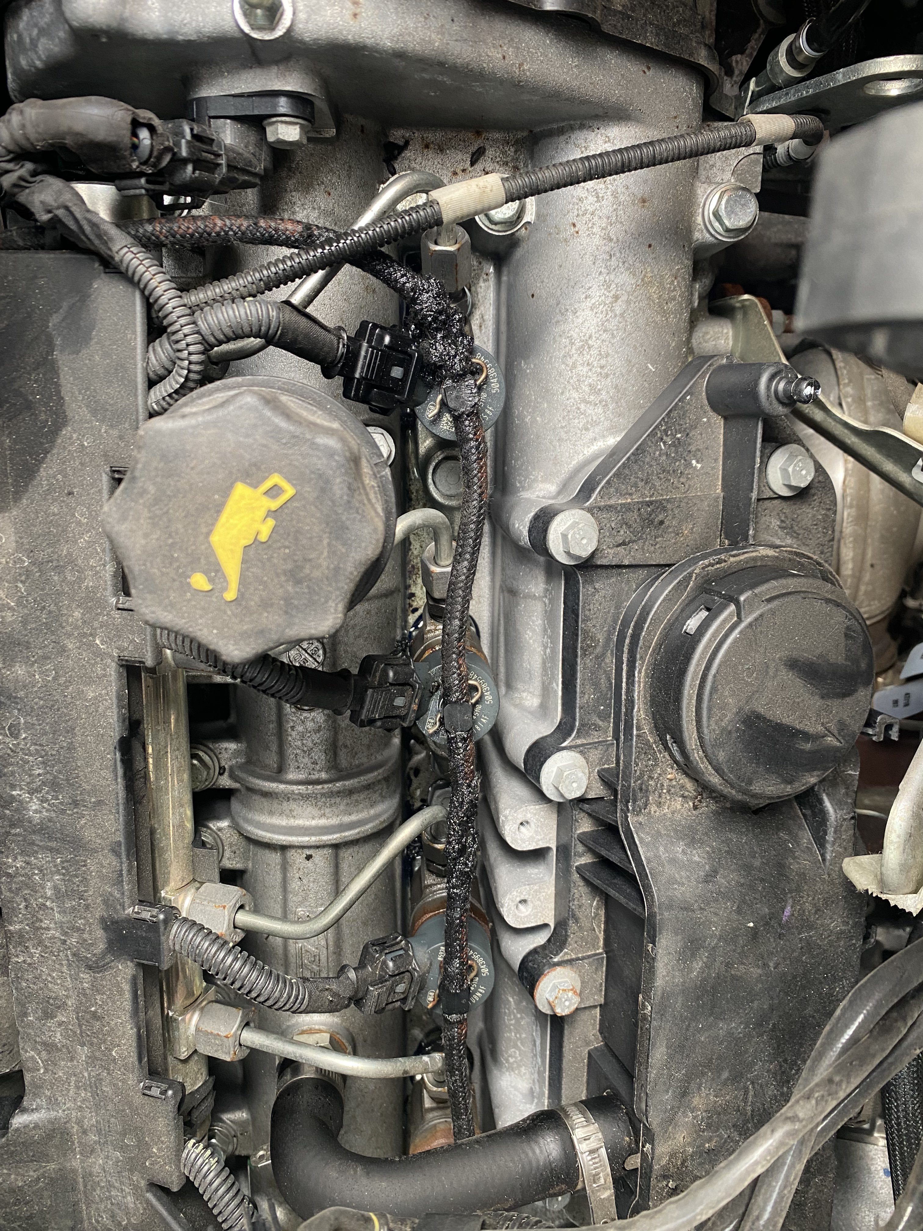

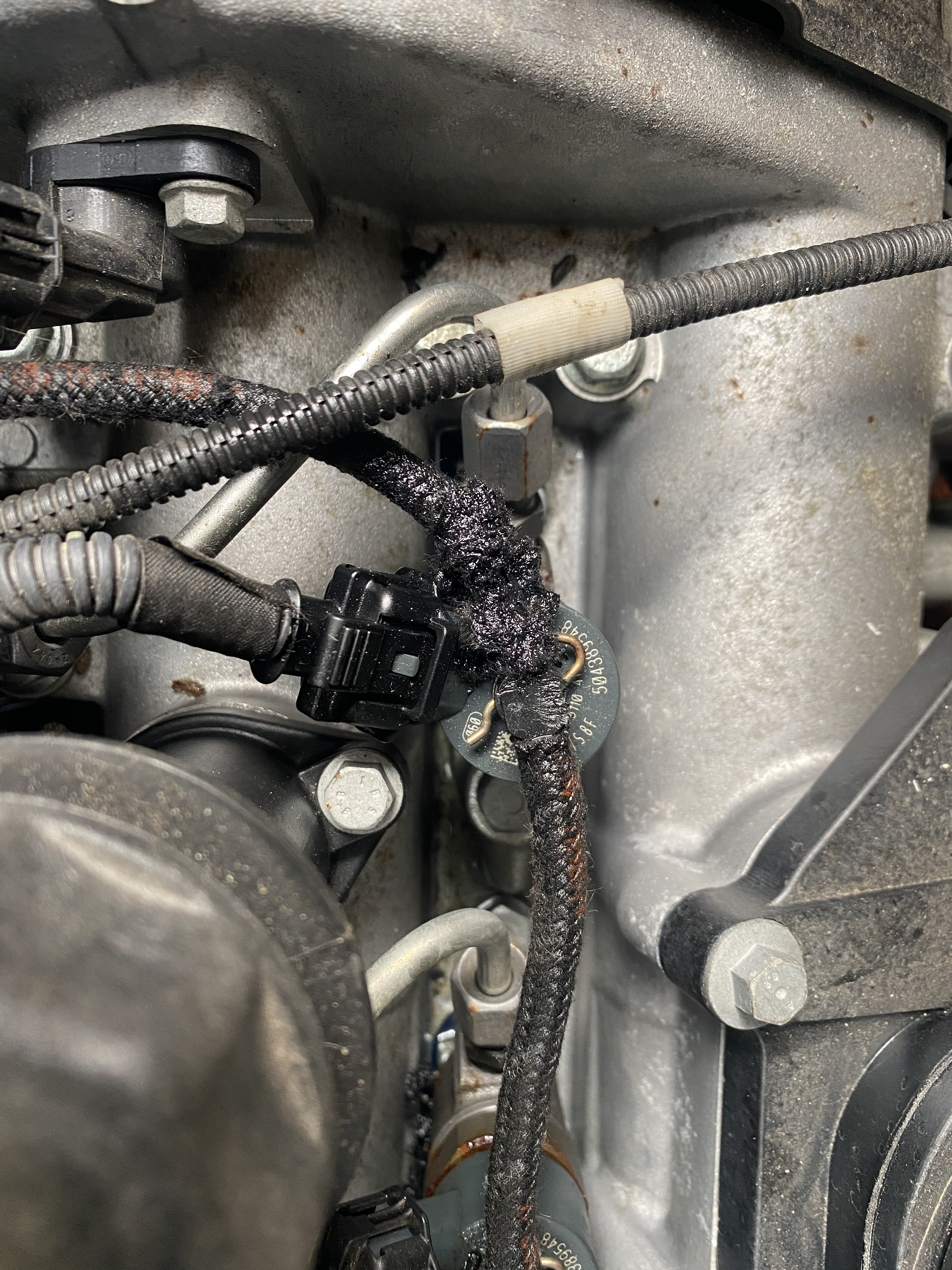

I have a 2019 Fiat based motor home. I Noticed fluid leaking in the engine bay and upon taking the plastic engine cover off have discovered a mouse has attacked a fuel line ( I think it may be the fuel injector return pipe??? but am just guessing ).

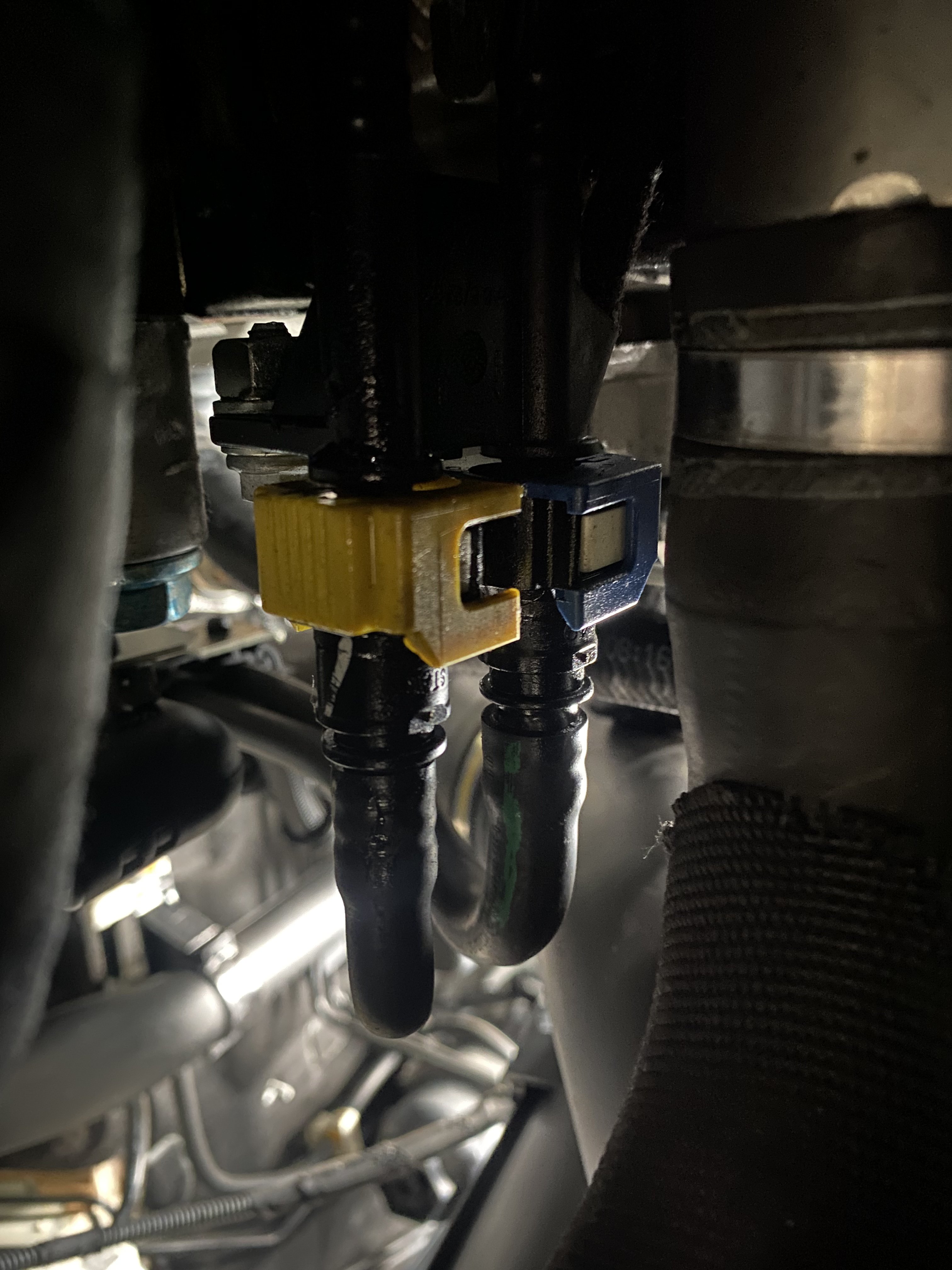

Could anyone point me in the right direction of where to get one please, and also how I go about taking it out of the connector pictured underneath the van. I’ve hopefully enclosed a few pics.

The fuel return on a diesel is call a leak off pipe for some reason. The feed pipes are all the metal high pressure pipes.
Usually the return is just a push fit as there should be no real pressure, some have clips, looks like yours dont.
Pull a bit of hose off and find some with same diameters.

The connector looks similar to that for the fuel filter, for which you slide the yellow collar as far as it will easily go, press the white detents now revealed (on both sides), and pull the pipe off.
