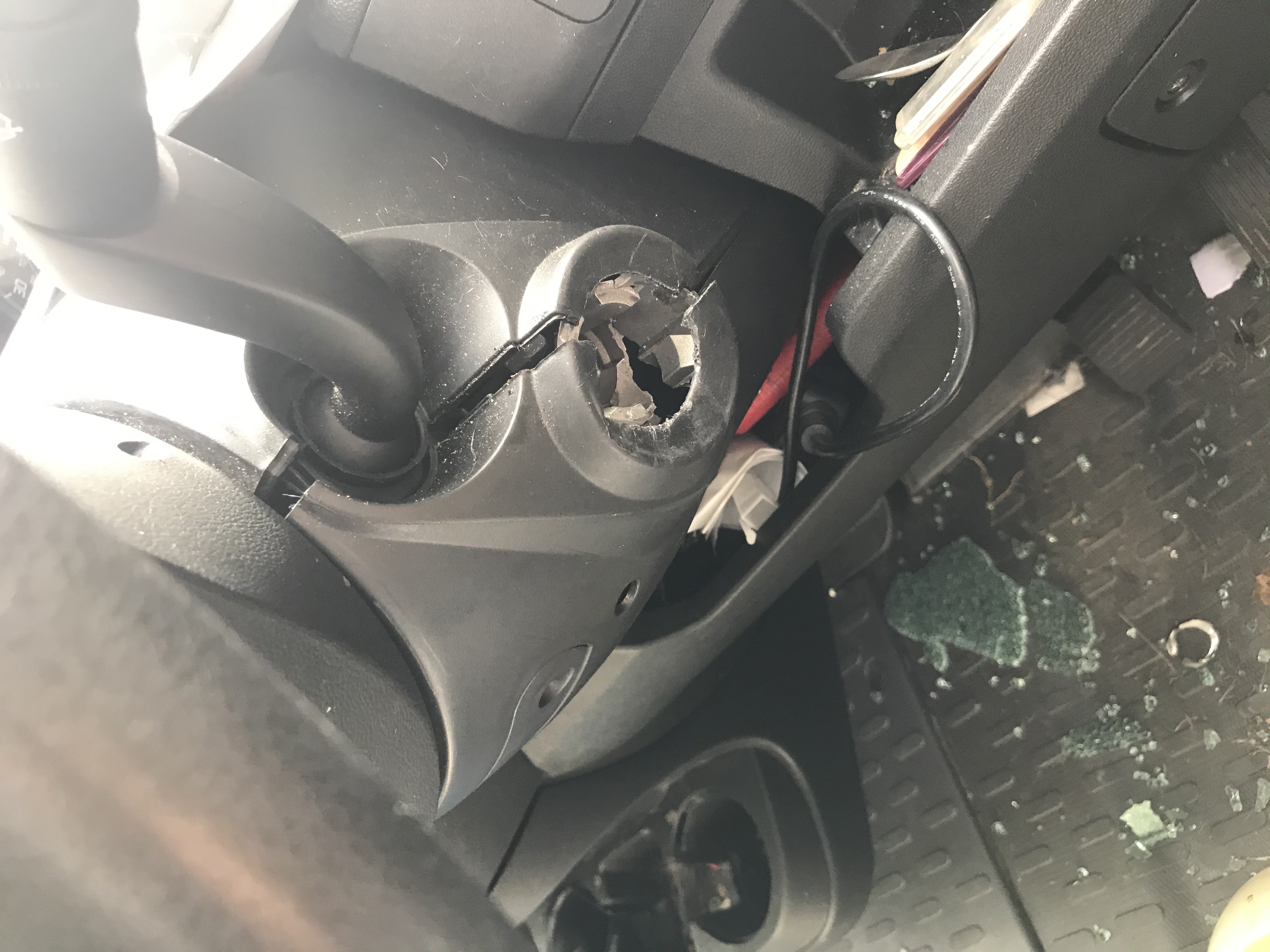

Hello, my Ducato had an attempted theft today. Two busted windows and the ignition lock either screwdrivered or centre punched out. Insurers are saying it may be a right off as a new ECU and steering column will be required. Seems a bit OTT. Any thoughts ? Thanks

Several options as loads of new barrel and mount combinations, pattern and genuine on ebay ,priced from £25 to £150 , fit your old transponder and transfer the key blades , glass and column shrouds are available cheaply as well as there are a number of late vehicles being broken .
Probably do the job yourself in a morning taking your time with the parts at hand, has the assessor been and had a look yet ?
