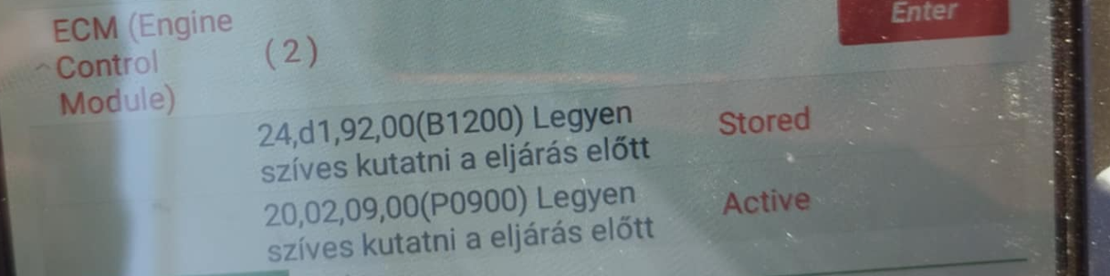

Hi,
I have a Fiat Ducato 2020 2.3 (120hp) Euro 6 with engine F1AGL4114 and 6 speed manual transmission 127.000km. (ZFA250000...).
Check engine light came on and the start-stop function was disabled suddenly.
After clear the DTC-s, everythink was fine around 300km, then it came on again.
Attached an image about the DTCs.
Can you help me where should i start investigating the problem? I cant find anything relevant in connection with this error code.
Thank you!

No idea how relevant they are, FIAT codes are similar to these:
Having in mind what the error description says, which is 'Please do your research before proceeding', I don't think they are relevant. Unless the google translation is that crap ;)
FIATs are ment to be read mostly with MultiEcuScan.
Thanks!
Translation is good, im trying to search but dont know where to start :D this code is corresponding with clutch actuator but it is a manual gearbox.
It is relevant because if i delete it checl engine light turns off and start-stop funcion is enabled again.
Btw the Launch is a professional tool i think, it is compatible with lot of cars, car repair shops using it.
