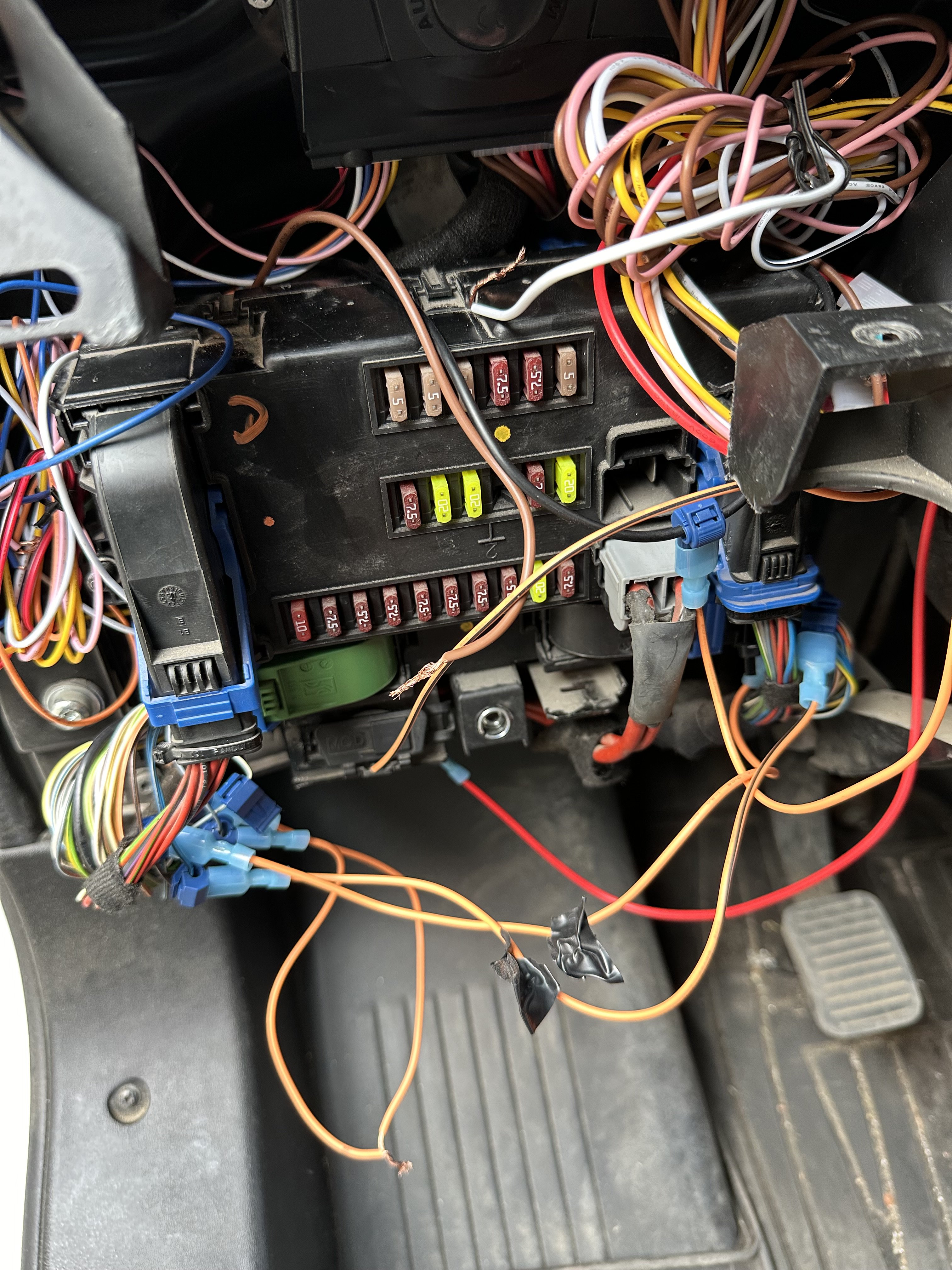

I need some help on installing alarm to my 2015 ducato.
I’ve found almost all the required wires except the central lock/unlock.
The EDC document that I have says pin 1 of MOOTH connector PIN-OUT (Grey, 60 pin, dashboard wiring) is supposed to be that but when I connect it to the alarm unit or tested manually it doesn’t lock or unlock.
i wasn’t able to find any other wire related to lock/unlock on driver side sockets. Any help is appreciated.
Attached is a photo of my sockets and how I installed the alarm ecu
