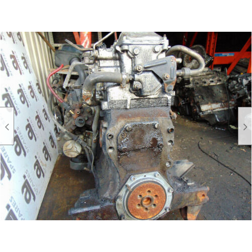

Hi is there a core plug behind the gearbox as I have antifreeze dripping from the box everything is dry above the box

Which engine is it as it looks like the 2.8 has some core plugs at back of the block, try googling engine block pictures for your model.

As I mentioned previously photos of the engine block on the 2.8 Ducato appear to show core plugs there, but I don't know what engine you have.
Bit unlucky if it is a core plug, it's years since I needed to fit one. Can you get a mirror and a torch to see it better at back of block?

Yes had a mirror and a magnifying glass with LEDs block above and sides dry,only place wet in bottom of the gearbox and it's not a small drip now

2.5TDI
Iveco 8140.47 same block as the 2.8​

I have had five vans and pick ups with those engines and loved them. The only photos I could see online were on eBay and it did look like there is a plate that could have rusted through, where possible the water pump was mounted on the block if they mounted the engine in a different configuration.
At the bottom of the head the lower part of an ally housing for a water takeoff is very close to top of bellhousing, just double check not leaking from there as might be a fix. Mike

Thank you for that, going into the garage on Monday, as I am a Geordie in Poland the garage rates are very very cheap , just back from the garage gearbox out it was the plate leaking 8 hours labour clutch ok plate resealed 180 pounds ( geordie in poland )

Found the leak it was the plate hidden by the gearbox that was leaking

Could have been worse then. At least you are back on four wheels.
Odd the plate gasket leaking, not common. At least our general diagnosis was right. :)
