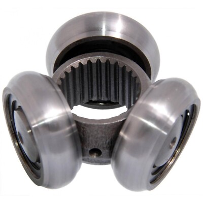

My quick research says your required 'tripod' may be this :
Based on the part number I cross referenced..
From sellers of genuine FIAT Alfa boxed parts..
Always worth checking with seller before payment :)
