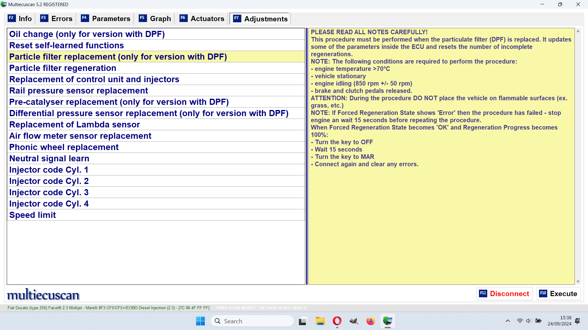

Sounds to me like the place that did the delete have done something wrong, whether they need fiat specific MES software to stop the dash flashing which they haven’t got I don’t know. At the end of the day if the DPF isn’t there now and it’s all been correctly deleted it should run better due to it being unrestricted. My guess is you need MES software to finish the job off. Sounds like you’ve done the hard work! Dpf’s, clean as they may be are better off in the bin in practical terms (other than environmental reasons obviously) 🤣
Yeah I wonder if MES can change the soot value to zero so it doesn’t flash up the dpf regen thing?
Mes can reset the system to a new dpf but this will also reset the regens and do a forced regen. read the notes.
Yeah i thought the same but have no idea on how to do that. Definitely no other way in MES to change the soot count or something? Or a way to "format" the ecu back to stock settings/parameters so its like when it was new and would think the dpf is empty?
Use the highlighted function to add a new dpf post#6
