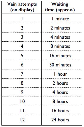

The radio display shows "WAIT" because someone has tried a wrong security code too many times. You need to leave the radio and ignition switched on continuously until the message clears, then enter the correct security code.
Depending on how many wrong codes have been tried, the waiting time could be up to 24 hours.
