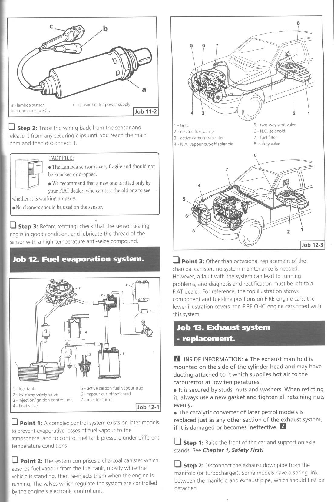

When your sure you have a good earth path there, look at the middle part of “Breather.jpg” re cutting out and breather hose valve. This area may be the cause as a bad tank vent/valve will not let air in to replace the “void” left when fuel is pumped out of the tank, so the fuel becomes harder to pump out and eventually the engine will not run or start (temporarily). Have you tried removing the fuel filler cap and listening for excessive hissing / sucking noise signalling not enough air flow? Also refer to "partF....JPG "– sorry if you have been there –
usual caution regarding pressurised fuel system!! – My 999 IE 1993 UNO “Start” never hisses when I take off the fuel cap. I don’t know if it should.
