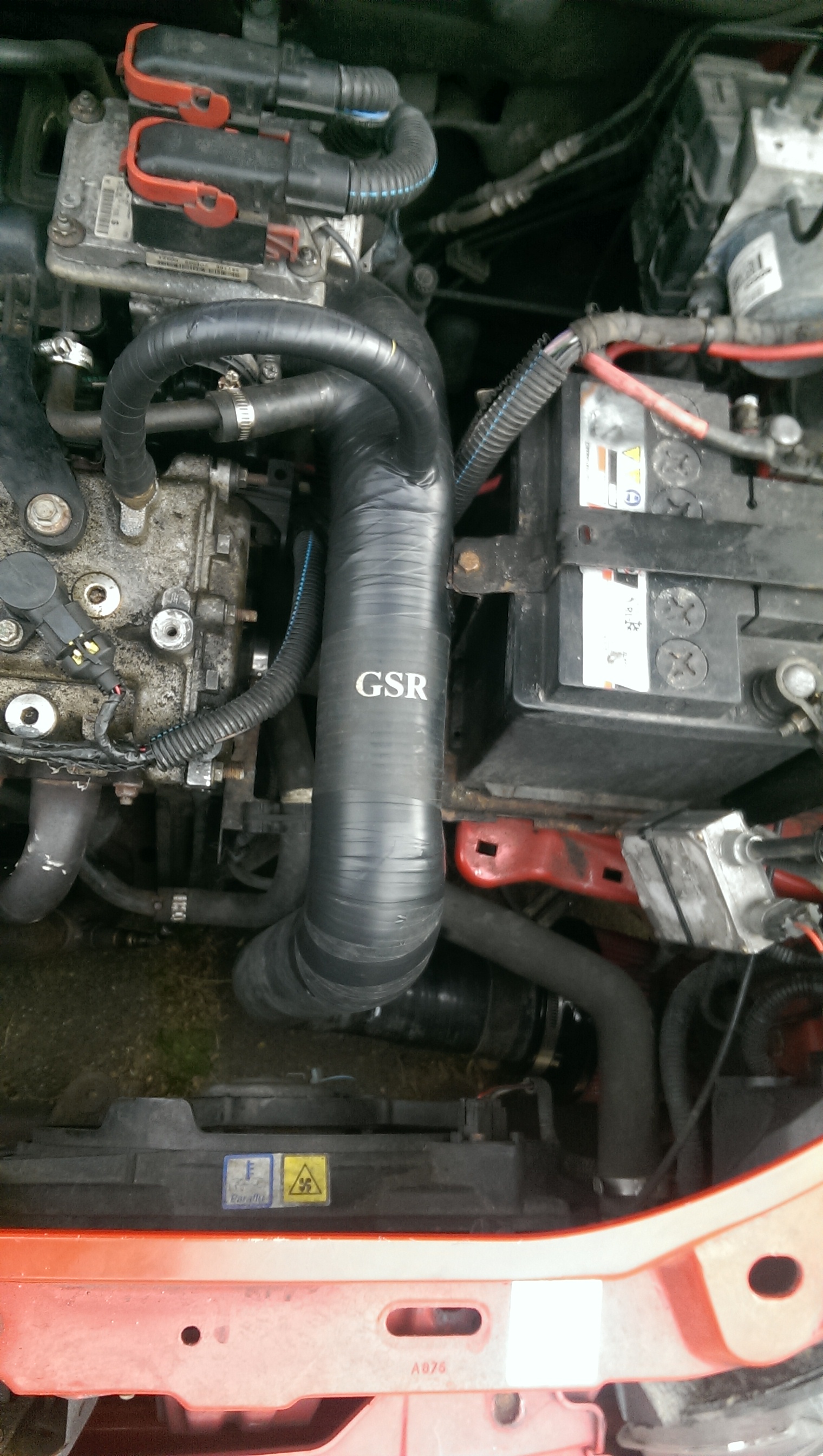

Hi Guys,
I've noticed my dipstick keeps blowing out slightly (top part just coming up) and spraying oil.
I dont think it is a piston ring as the car running as normal and no signs of any smoke at all.
I recently installed a GSR so thought it may be a blocked breather but they seem to be clear?
Someone suggested may be a pcv valve? Could someone on here direct me as to where this is on the 1.4 16v Sporting please?
Any help or suggestions would be appreciated, thank you.
Turns out the smaller looped pipe was 'crimped' where it was connected to the larger pipe on the GSR.
I cut a small piece of copper pipe and used it as an insert to keep the pipe open and reattached it all. Everything is fine now.
Thanks for help mate.
