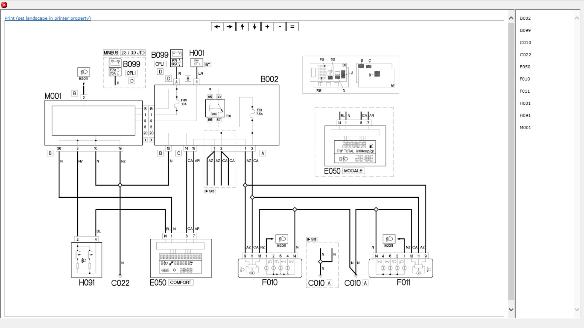

Is it possible one of the headlamp adjuster motors is causing the dipped headlights shutdown? After getting some drawings this afternoon I now notice both motors are fed from the left hand light output.

I have now had a more detailed look at the Elearn diagrams for a 2008 van.
The headlamp height adjustment motors do indeed share a supply (via fuse F13) with the LH dip beam, so they will only operate when the dip beam is on.
For this age of van, the Dip and Main beam headlamps are controlled by relays, but there is NO current monitoring by the BCM, so ignore my previous comment about faulty bulbs etc. This also means that although an abnormal drain from the adjustment motors could blow F13 and leave you with one dipped headlight, it wouldn't cause both to be automatically be shut down by the BCM.
The finger of suspicion is pointing to the headlamp switch (stalk). If this is intermittently giving the wrong resistance value, this could be interpreted by the BCM as a command to switch lights off. Maximum resistance corresponds to "lights off", so an open circuit would also give this condition. The "active low" drive to the dipped beam relay will then be lost, the relay will open and both dipped beams will lose supply.
I don't have data for the various resistor values in the stalk, but if you unplug its connector and measure with an ohmmeter between pins 4 and 7 of the stalk I would expect to see for example 3000 ohms for OFF, 2000 ohms for SIDE, 1000 ohms for DIP and zero ohms for MAIN. These values should be "solid" i.e. no wavering. If this test is OK, I suggest replacing the stalk connector and repeating the resistance test at the BCM connector (unplugged from the BCM) so that the two stalk-to-BCM wires are included

Cheers again Anthony for your time to give me the detailed reply. The only doubt I've got with suspecting the stalk switch is that when I turn on my dipped beam the indicator on the dash turns on and stays on even when the lights go off suggesting that the input from the stalk switch is correct.
It's kind of looking like I'm one of the rare unlucky ones with a faulty body control module.

I think that the central locking would be the least of your worries. It is my understanding that the BCM covers the role performed by the code receiver in earlier models. If I am correct, a used BCM will not be programmed to recognise your keys. In this situation the you will get the dreaded padlock symbol illuminated, and the engine will not start.
To confirm your suspicion of a faulty BCM, is it possible to monitor the output at relayT01, either by touch (hold a finger on the relay) the relay, or by removing it and monitoring the BCM output on terminal 86, to with a meter connected to +12V?
I am always sceptical when a relay is the first suspect, but failures are not impossible, so worth eliminating by substitution.

Hi Comminicator, many thanks for your reply to the used BCM programming issue but I have been assured by the company who do it that it will recognise my keys as I have the original code for the keys. I also did test the BCM output to terminal 86 of T01 with multimeter which showed a very low and falling voltage. Will let you all know how it goes after I receive the used BCM and then send them both for programming.
