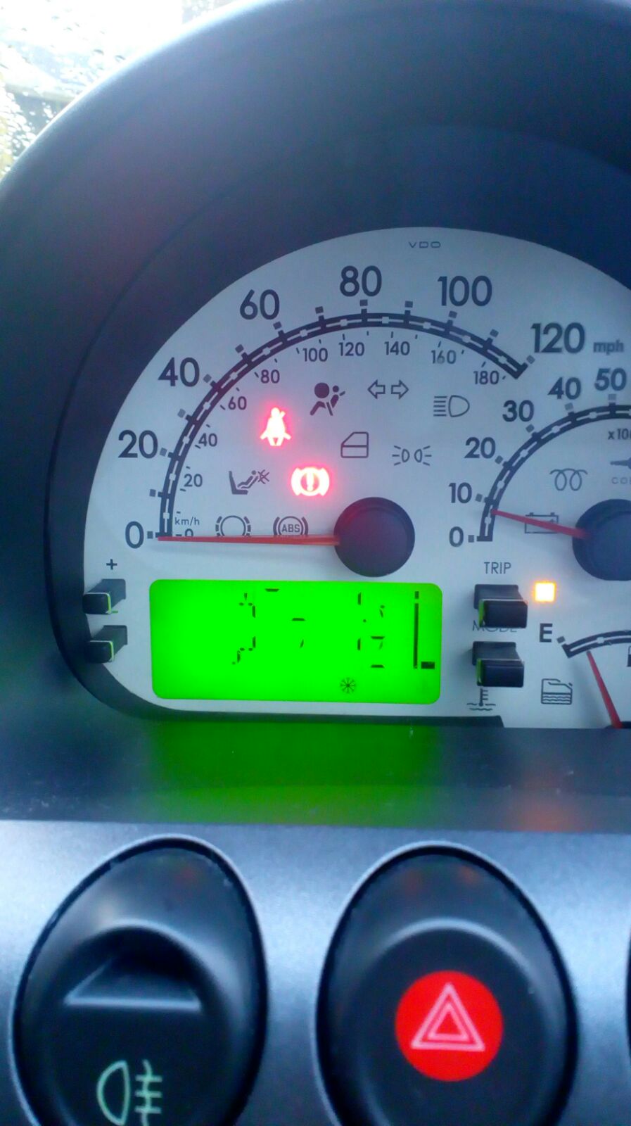

I've got an issue with my 2010 Multi, that when it's cold the digital display doesn't always function properly. Normally after a minute of the car running it sorts itself out, although today it hasn't hence posting this. I have attached a photo of the display.
Has anybody else had this issue? Can I simply just replace the display or is it integral to the whole instrument cluster, if so can I just swap the cluster from another late Multi?
Thanks

Hey. Had exactly the same issue on my old Marea (digital display not reading properly, tachometer and all other needles dropping out intermittently) had an auto electrician out for it too! Turned out the two connector's on the back of the display unit were dirty and reducing connectivity. Gave them a real good clean with a toothbrush and some contact cleaner spray. Worth a try before spending out money on a new unit. ?
