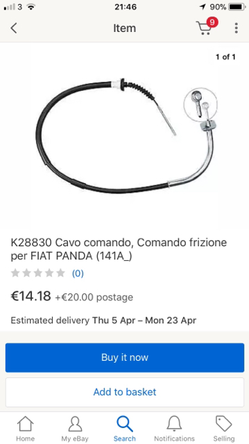

Well I'm still waiting on the autodoc (not mister-auto got mixed up) one to arrive so hopefully I'll find out tomorrow if that is right or if it is going straight back. The cable type for my car is the second type pictures Lukmek, though I've now seen a couple which look like this but have subtle differences (ie length and the diameter of the eye at the pedal end). Is this one listed for RHD cars? This seems to be the sticking point with a few suppliers as I guess they continued using the design on LHD cars right up to 2003?
It’s from Italy so I guess it’s for LHD

I can ask the Italian seller the cable dimension for you

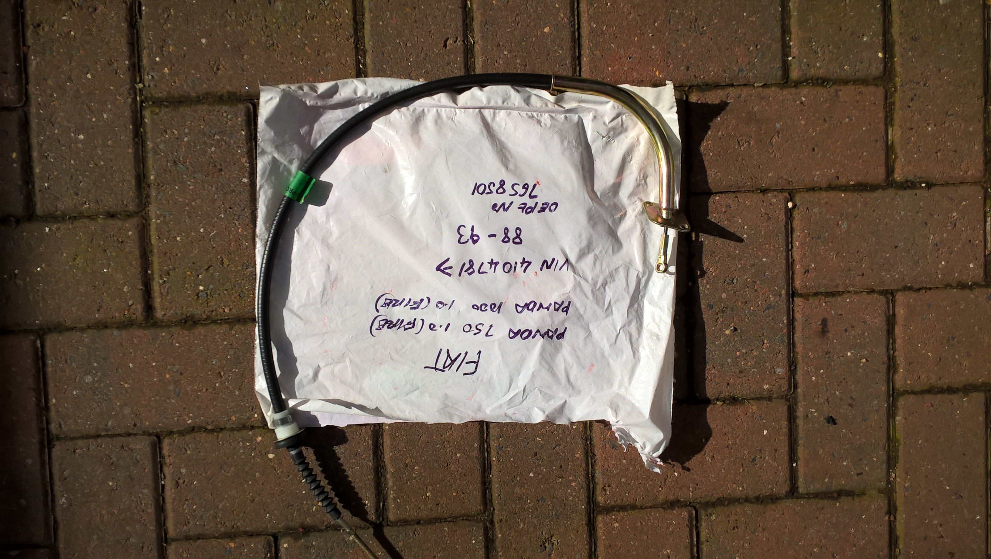

Just had a look and it looks too short. I've searched on the part no. and online carparts list TRW GCC1152 as an equivalent, which I've looked up and is listed as 555/343mm so I'm not sure if that is just shorter due to it being for the smaller engine or if its even a LHD one. That is the type of fitting needed for getting through the bulkhead, though the one I've got on the car now (a Veco VJC871) is a little too short and just about makes it round, though the eye at the pedal end was only 6mm so is now drilled out! Could definitely do with it a little longer and the one I've got does not quite come through the bulkhead at the right angle, so I've had to leave one of the two fixing bolts off to stop the cable rubbing on the top edge of the metal pipe where it comes through.
Phiz- hopefully a pic of the cable is attached to this post Andy
Looks good but so does the one that's on it which nearly fits:D. It'd be great to have it so I know I've at least got a fresh one should the existing one snap.
