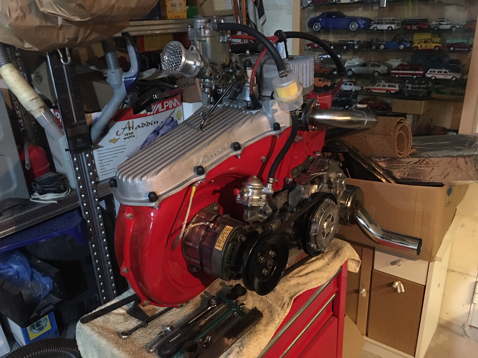

I have fitted a Dellorto FZD 30.24 on a 650cc engine. I need to find a way of connecting the accelerator and choke cables to it.
How is it normally done? Does a mounting frame exist for this?
Many thanks...

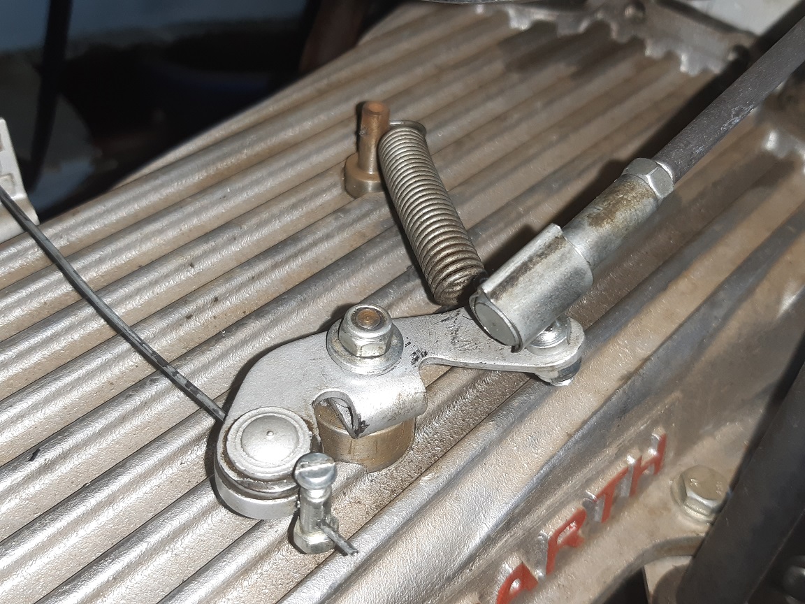

Hi.
I have had the same issue to solve on mine.
As stated above, I have also never used the choke so didn't even try to sort that.
I got my old Italian engineer friend to machine me 2 'pins', one to attach the spring to, and one to mount the original pivot to.
After much measuring, he then machined out the top of the housing to accept the 2 pins positioned so as to allow the correct accelerator movement.
I hope the attached pictures show clearly enough how it was done.
Any clarity needed, please feel free to ask.
Regards
Steve

Many thanks for these photos. I have the original pivot and mounting it directly atop the aluminium cover makes sense. Do excuse my ignorance but where can I get the (black) coupling between the carb throttle lever and the pivot shown in the photo?
If you look at my earlier comments on this thread, you will note that I have suggested that you go to "BURLEN SERVICES". These people are THE SU carb people theses days (they own the name, the production facilities) and stock a massive amount of spare parts. Go onto their web site, and then 'SU catalogue'
--look for 'ball joints'--you will require 2 x AUE1001 (£3.40p each inc). Then go onto 'Throttle connecting rods'---these come in different lengths, so work out which one you need before ordering (the threaded sections can be cut to give a sort of 'mid-length'). I would suspect that the 5inch rod would be about right--part number AUE1005 (£28.80p inc). The quality is first class, and they are still operating their 'mail-order' facility.
As 'the hobbler' says in his message, you need two of those 'ball joints'.
I connected mine with a piece of 5mm threaded rod covered in black electrical shrink wrap - the stuff that shrinks when you apply heat.
The rod is about 145mm long to give you a starting point.
Regards
Steve

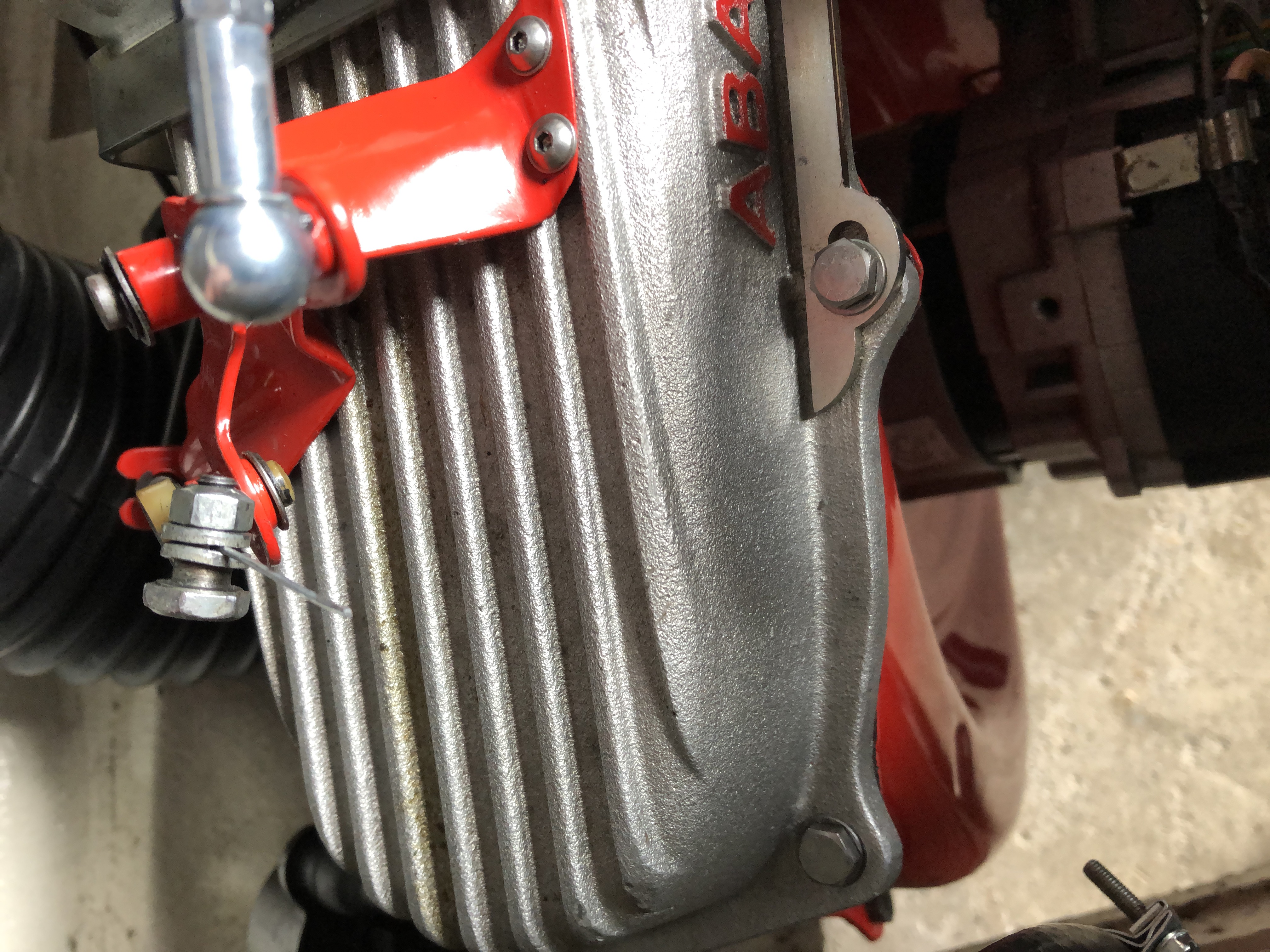

Hi, I use the same top cover on my fan housing and to make a linkage I have just cut an original pivot from an old top cover and bolted it onto the alloy one. A simple link arm with two ball joints fixes the carb actuation. (y)(y)
Ian.
