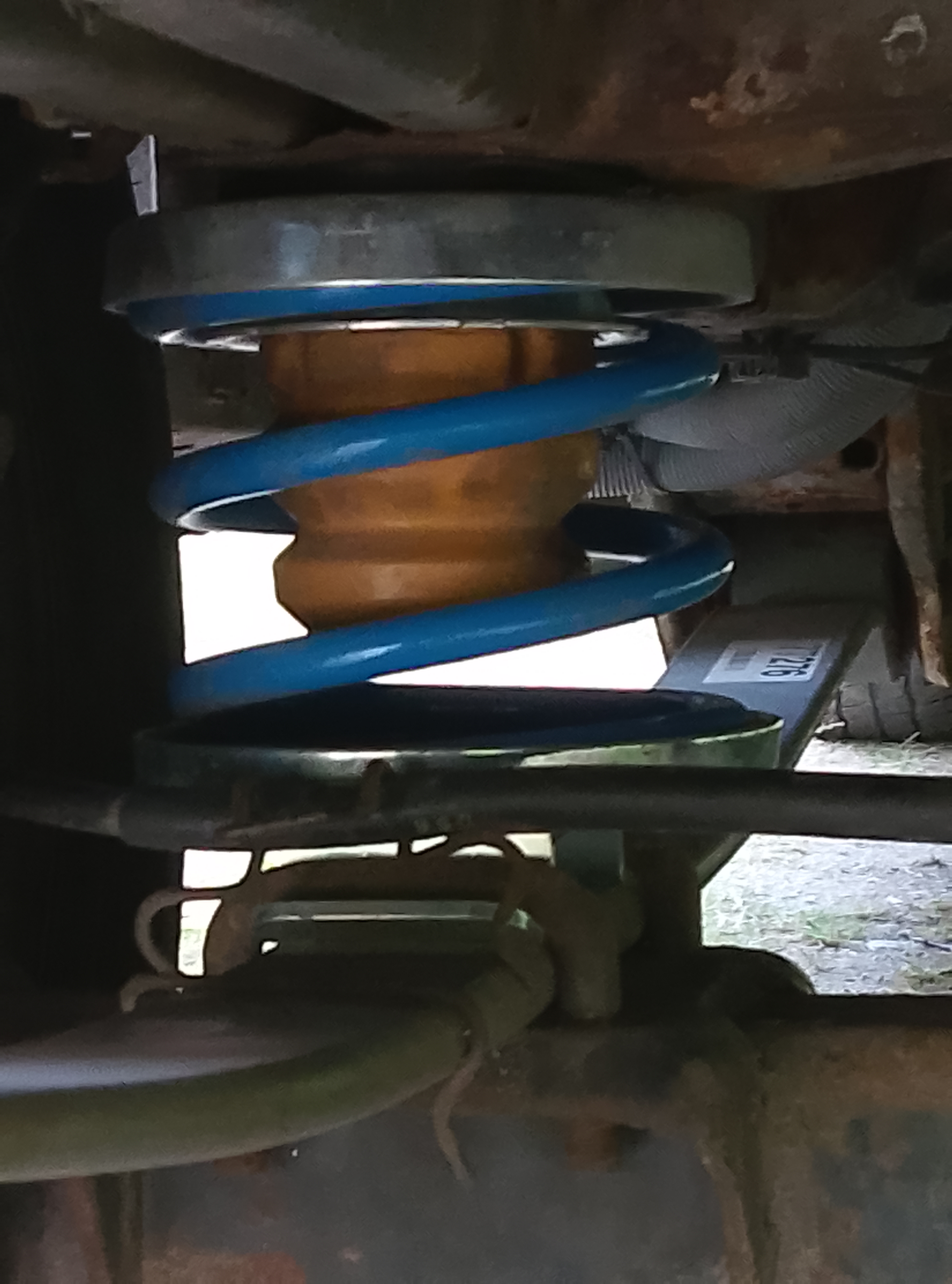

On my van it looked like this, more or less, after fitting them (see the first picture on the link). The bumper stop almost touches the place, maybe 2cm away from it:

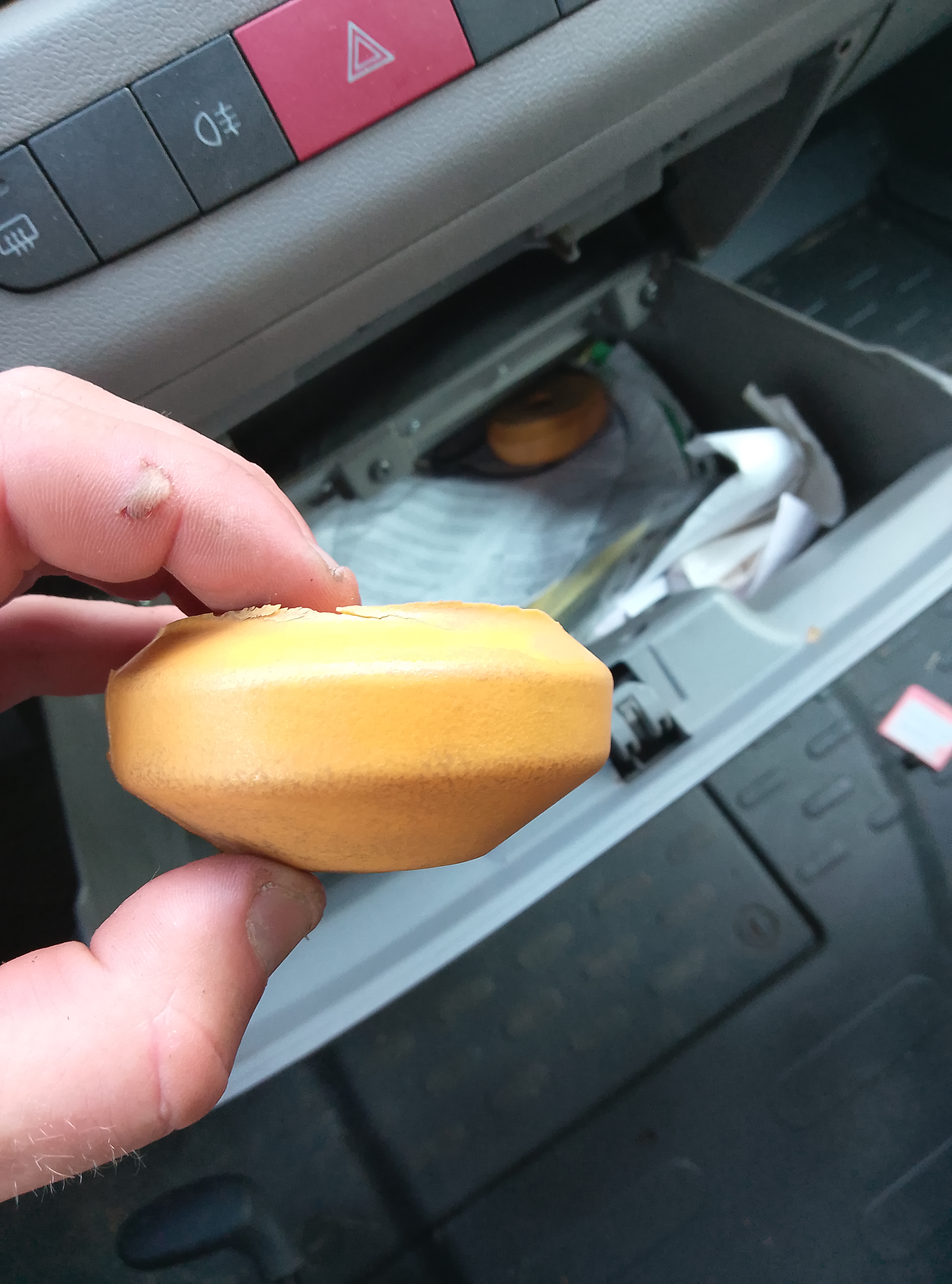

I figured that it might make the rear suspension less stiff if i cut the bump stops a little bit (the top/thinnest part) So i cut them this much, see attached pictures.
After this, i went on a test trip. The suspension seems worse now, but i'm not sure... On low speeds, on high speeds it's still very good. Is that possible by cutting this much? As you can see i can bend what i cut with the finger... Or is it impossible and just placebo?
If it's possible, i'd like to attach the parts i cut to the bump stops again...Is this possible, perhaps with super glue? I regret i touched anything, unfortunately, as it was useless.

The yellow looks like progressive bump stops that touch early but gradually take more of the weight as loading increases, so it would have been OK with them fairly close to the stops.
Is it possible the rear shocks are not very effective?
Is there more problem on bends than over bumps in a straight line as rear anti roll bars are more important with camper vans due to more of the extra weight carried is higher up causing vehicle to roll more on bends.

Thanks for the reply. So if they are progressive bump stops that touch early but gradually take more weight as loading increases - does it matter if i cut this part? I mean, i can obviosly squeeze it with my fingers somewhat - can that really have made a difference and that's why i'm experiencing worse ride quality after cutting it? Or must it only be placebo?
No problems att all in bends... it doesn't body roll/bend much at all.. Straight line asfalt with some minor bumps in low speed is when i notice it being bouncy. In higher speeds, potholes and gravel roads the suspension is perfect.
I'll attach a picture of how it looks now, after i cut part of the bumper stop, on my vehicle. Is it possible to glue back the missing piece with super glue, would it last? Or useless?

Yes as you say re progressive, the other type are hard and only take the weight when fully laden , so no give/flexibility.
If happy through the bends, not swaying from side to side then rear anti roll bars OK.
Firmer rear shocks will help I feel.
You could try gluing the cut off bits back, if it doesn't work then replace with new same type.
The springs take the weight, the shock absorbers stop the bounce.
Just for a laugh disconnect the shock absorbers and give the van a rock, you will see what I mean.
Are your tyres the correct load rating, softer side walls and a heavier van are not a good idea.
Worn shock absorbers often do not visible leak oil.
Camper vans with heavy weight higher up in vehicle put more strain on shock absorbers than a work van with heavy weight sat on the floor.
But is it necessary to replace the bump stops? I mean, since they seem to be progressive and the bit i cut off is quite soft (possible to bend with hand) can it really make a difference if its there or not? or is there some function of the bump stops that i'm missing? That the piece i cut off could carry more weight than what it seems.
Sorry but you've mucked up 😡.
There is a big difference between bump stops and progressive spring assists.
Have a look at SumoSprings. The yellow is probably too light for your load. The spring assists, as against a bump stop should sit partially compressed.
I replaced on my Ducato 2 years ago. Raised the rear 2cm from Fiat standards. You tube has a good video.
I installed helper coil springs instead of sumosprings, it's the same thing they take the load from the spring leafs.
They are designed like that for a reason, to gradually take up more load.
