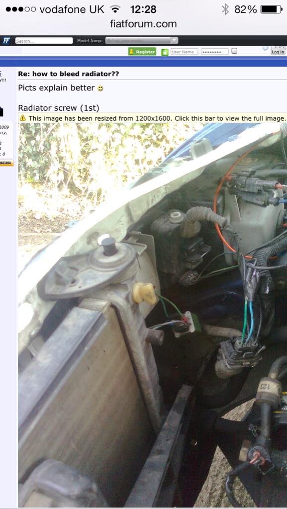

Are there two bleed valves on the 1.6 8v engine?
I have located the one on the hose to the right of the engine behind the Coil Pack but I was told that there is another. Is it located on the Radiator itself?
Any advice would be greatly received as I think I have an air lock. :bang:
Cheers
Steve
1.6 has a bleed screw on the left side of radiator at the top corner as you look at front of car either black or white screw ImageUploadedByFIAT Forum1394713781.254279.jpg
