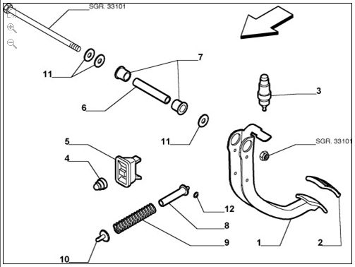

A pic would be super for other users on here
Top of the clutch pedal, similar position to the brake pedal switch.
Item 3 in this diagram.
