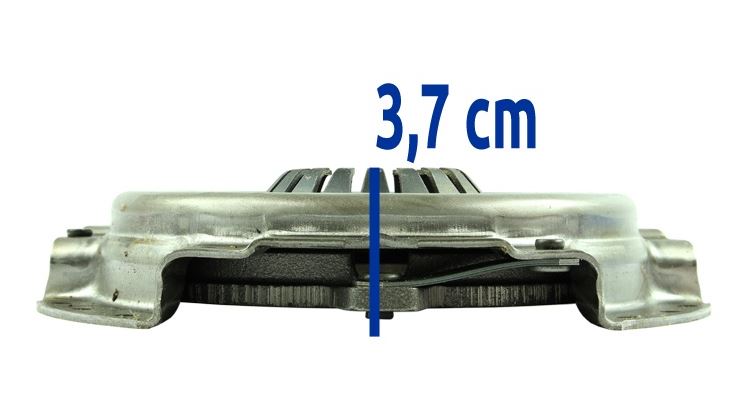

does anyone know the difference between a 126 and 500 clutch pressure plate?
I have fitted my 500L flywheel to my D engine and also have the 500L flywheel housing on a 126 gearbox.
With it all in place it would appear that the lever has too be pulled a long way before the clutch release bearing touches the pressure plate.
is the 500 pressure plate deeper than the 126?
I found my answer
500 - 3.7cm
126 - 3.1cm
looks like I will be taking it apart again - grrr

I found my answer
500 - 3.7cm
126 - 3.1cm
Sean, make sure you use the F/L thrust bearing with the L pressure plate, if you use a 126 thrust bearing it won't fit - as I found out after starting the engine and trying to engage gear :mad::mad::mad: :mad: all you get is a terrible screeching noise and the engine will slow :mad::mad: You will find that the friction plate for the F/L won't fit the 126 pressure plate :mad::mad: see post 184 in "704 Hot engine" thread.
Ian.
I ended up changing the pressure plate to a 500L one.
The lever movement was very excessive and the spring was almost at full tension by the time the release bearing engaged with the pressure plate.
I didn’t try the 125 bearing.
Never gave it a thought as I had a new 500 bearing.
All seems to be fine now.
