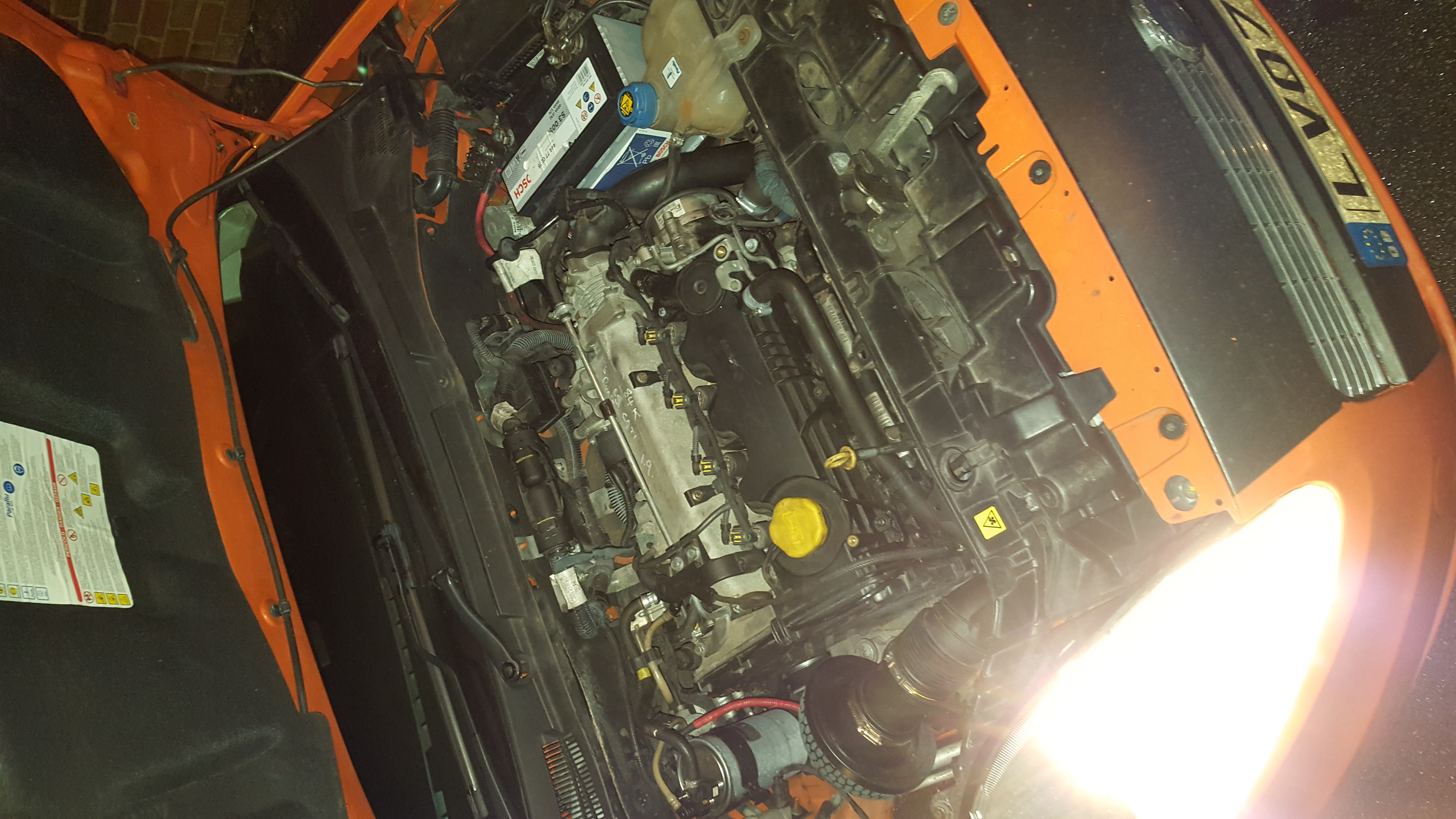

I've got a problem with my 2007 Fiat Punto Sporting 1.9 jtd. After finding brake/clutch fluid under the car and the clutch pedal to the floor. I opened the bonnet noticing it was leaking from where the slave cylinder enters the bell housing. The real problem I have is I can't see the resemblance comparing it to other puntos. Being a 1.9 does it mean it's fixed inside the bellhousing and does it mean engine out job? Here is a photo of where it's leaking. Another thought is the engines out of a vauxhall and maybe uses a different part...

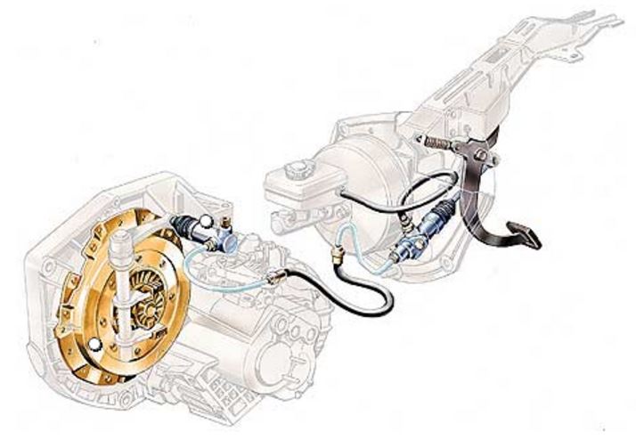

Regarding the clutch actuator, it is just a slave cylinder that pushes internaly on the clutch releasing fork ; you should be able to simply remove/replace it w/o engine or gearbox removal... Unless there has been some damage to the inner parts, as I'm a bit concerned about the clutch pedal being "on the floor" :-(

Thank you for your reply and input Bernievarian. I've just been topping up the reservoir and pumping the pedal to get pressure in the system for now. Also making sure it doesn't get to low so I don't have to bleed it as it drives fine. Just a pain as I can't find a identical one to replace it with. I think I'm going to whip it off and get a part number but thank you anyway man ?.

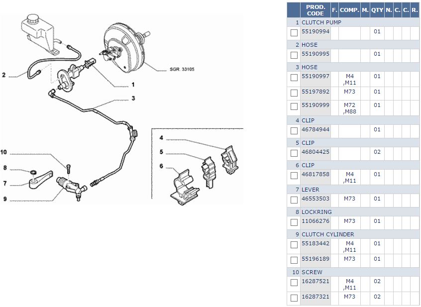

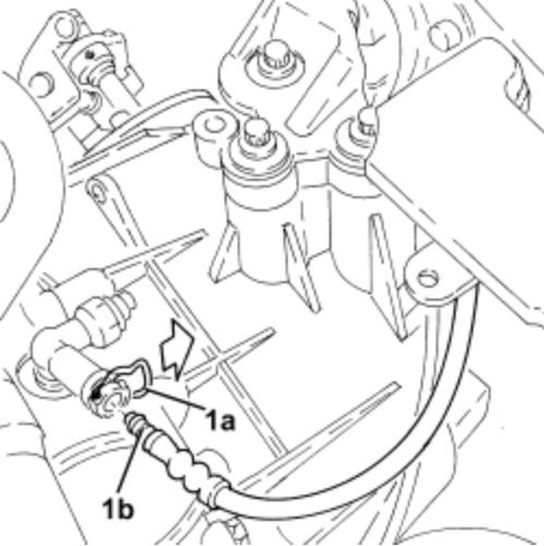

Bernie, The 1.9 is M88. according to EPER. Using the fabled Fiat/Vaux M32 gearbox.
And for the benefit of GregoryB, I'm afraid the slave cylinder on the 1.9 is Concentric, meaning it is mounted over the input shaft of the gearbox.
You'll need to find the source of the leak. If it's inside the bell housing, then i'm afraid the repair is a gearbox off job sorry :(
