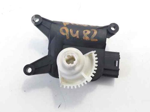

Many thanks for the info, I have attached an imagine of the part I think you are referring to. Please see attached..

That's one of the actuator gears.
If I understand it correctly, from other posts, the flap end, that sits in the middle of that gear may be the part that breaks, so a new method of attaching them together may be needed. From memory, I think you can see those gears under the dash, so hopefully possible to check if any of the teeth are broken.
