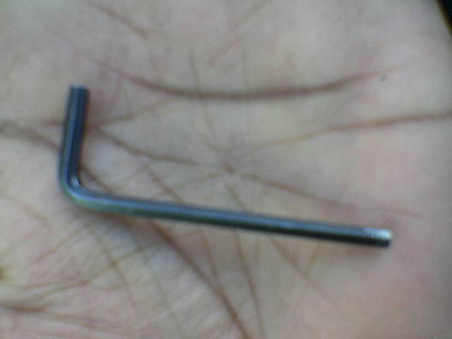

i just fitted some blue ones in mine, is this a mk1 punto? if so just use an alan key and remove the sig lighter then connect the wires to the back then put it back on, easy job. can post some pics if u like cos i aint put mine back on yet, but u will have to wait till 2maro cos its dark now
yep MK1. Ye if you could get some pics would be good but also what alan key are u using because ive tried a wide ranged and still cant manage to get these panels open (maybe im not using correct size) Ive heard its a 3mm 1 but ive got an allan key set which maybe doesnt have 3mm.

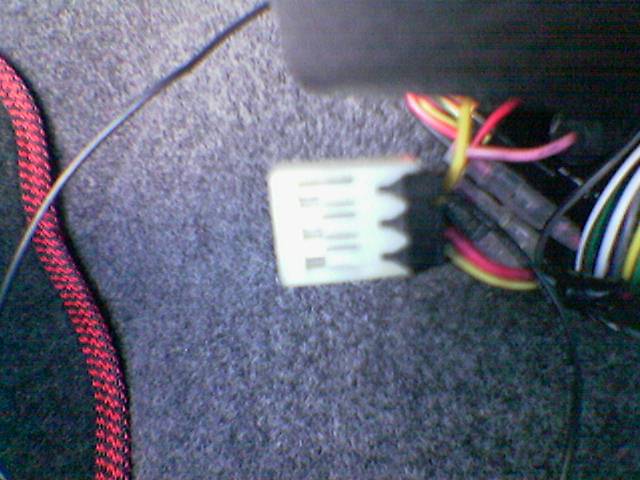

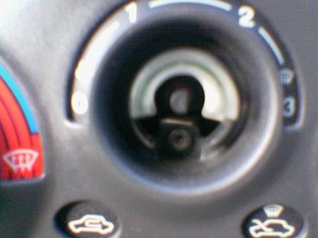

when u take off the cig, just pull out the connection, no need to cut the wires, then just push in the neon wire to the back of it, strip in a bit long so it wedges in. if ur having the switch up in the dash, there is a nut behind the fan setting thing ( 0 1 2 3) as show in the pic.

aha nope i didnt. Will the fan switch just come out if i pull hard enuff on it or is there a way to get it out? Thanks for all this help mate.
