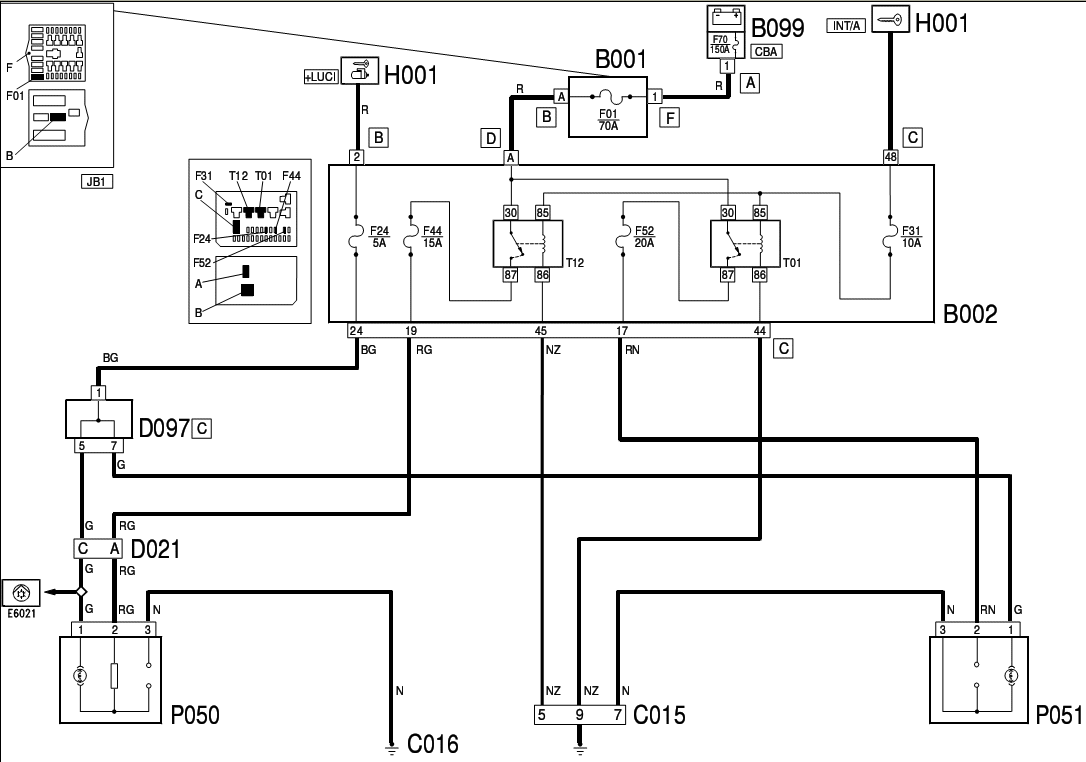

Hi all. I have an autotrail motorhome on a 2004 ducato. Does anyone have any idea how to connect the existing cig lighter/12v output to a permanent supply. We are only able to use it with the ignition on for charging phones etc.:worship:

If all has gone well, I am attaching the wiring diagram.
"The power supply to cigar lighter P050 is protected by fuse F44 housed in underfacia junction unit B002, and is governed by relay T12, also located in the junction unit.
When the ignition switch H001 is turned ON (INT/A), relay coil T12 is excited to deliver power to cigar lighter P050 - pin 2 -.
The power supply to power point P051 is protected by fuse F53 housed in underfacia junction unit B002, and is governed by relay T01, also located in the junction unit. When the ignition switch H001 is turned ON (INT/A), relay coil T01 is excited to deliver power to cigar lighter P051 - pin 2 -.
The coils of both relays are served by a line protected by fuse F31 and supply power directly from the battery, via a line protected by fuse F01, housedin engine bay junction unit B001.
Cigar lighter P050 and power point P051 come with internal lighting - pin 3 - that comes on when the side lights are activated. The activation input comes from short-circuit junction D097C - pins 5 and 7 -, connected to ignition switch H001 (POS)."
