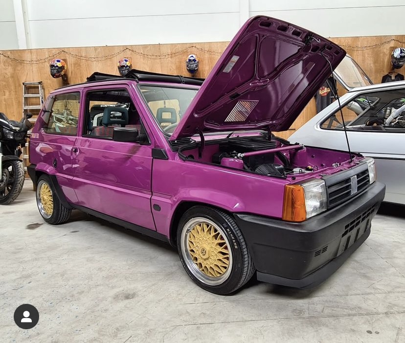

hey, im chris from south wales been lurking on here for a while but now seeing as ive started work on the Panda i though id let you in on it ,The cars a 1994 panda 1000 fire Colour , my grandad bought it from new (my nan chose the colour) , it spend most of its life in a garage although it spent a year in my brother ownership so theres the odd dent , but apart from that , rust is minimal and its got an immaculate interior.
my aim is to do a resto mod as the americans would say, restore the whole car , Standard interior,respray, cleaned bay, lowered suspension and nice,possibly widish wheels, possibility by widening the body,maybe
atm heres how it stood up untill last week , only real issues are that its been off the road for two years ,at the time the front caliper was sticking and the rear beam center bush was knocking its balls off. apart from that its a solid , unwelded , one owner car with 66k on the clock.

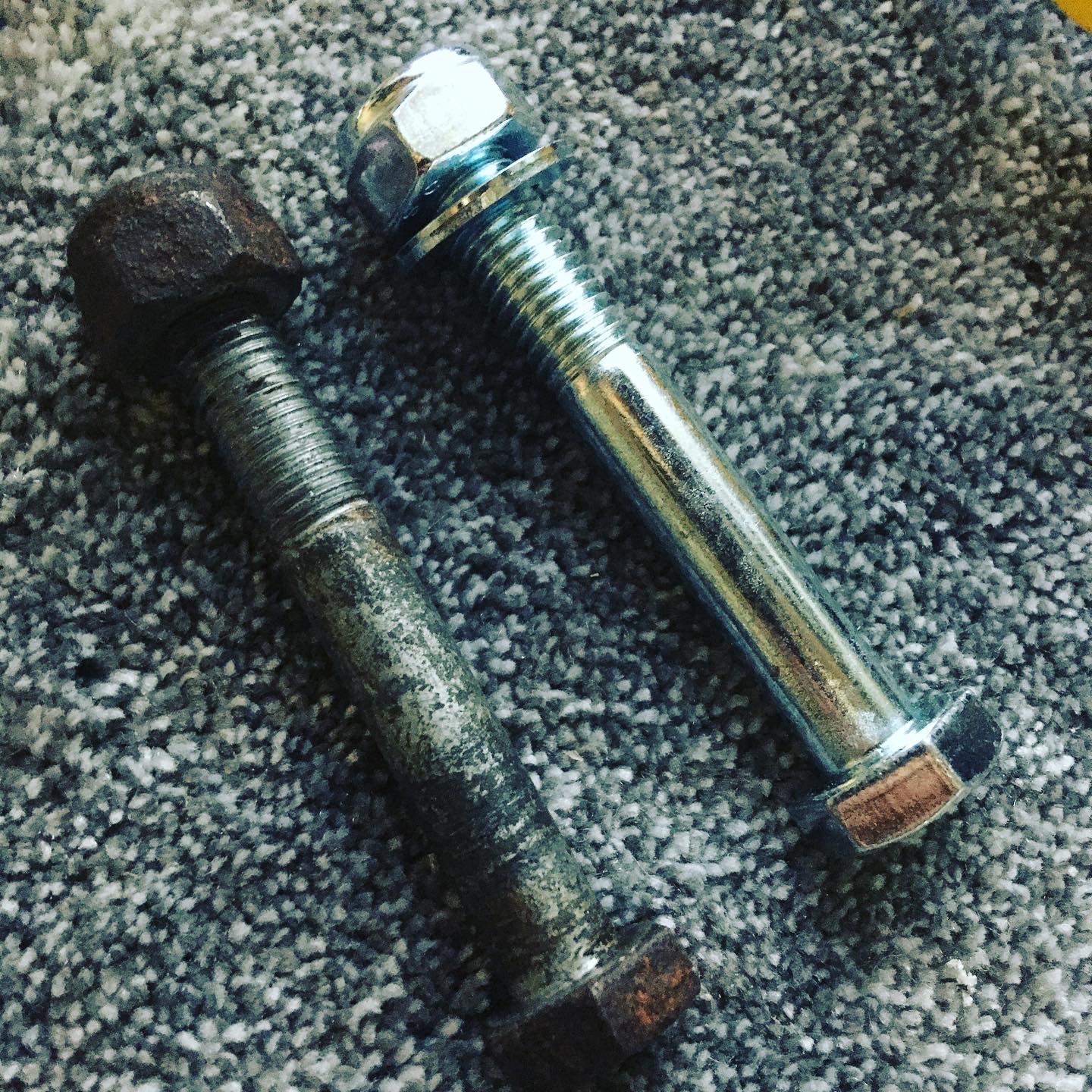

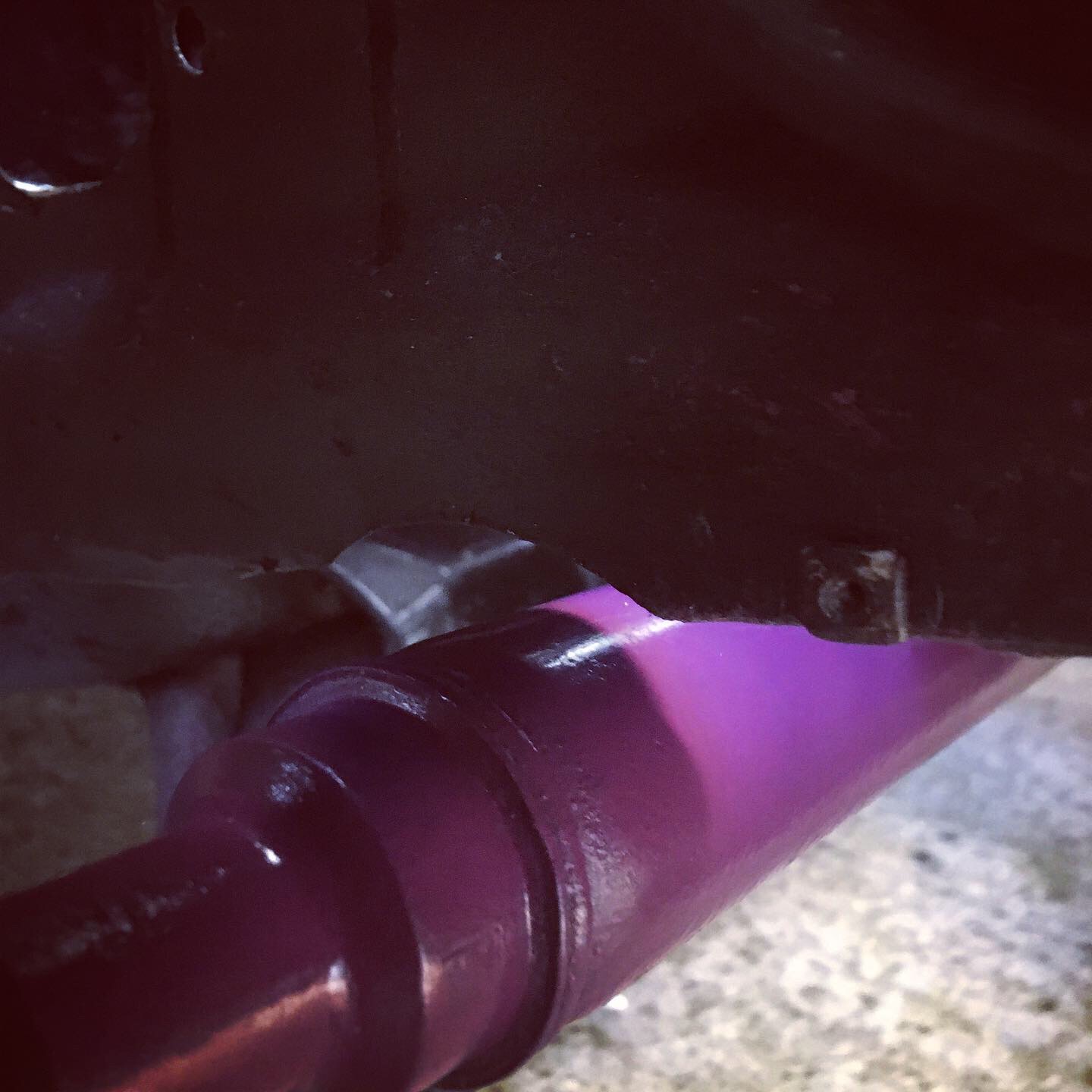

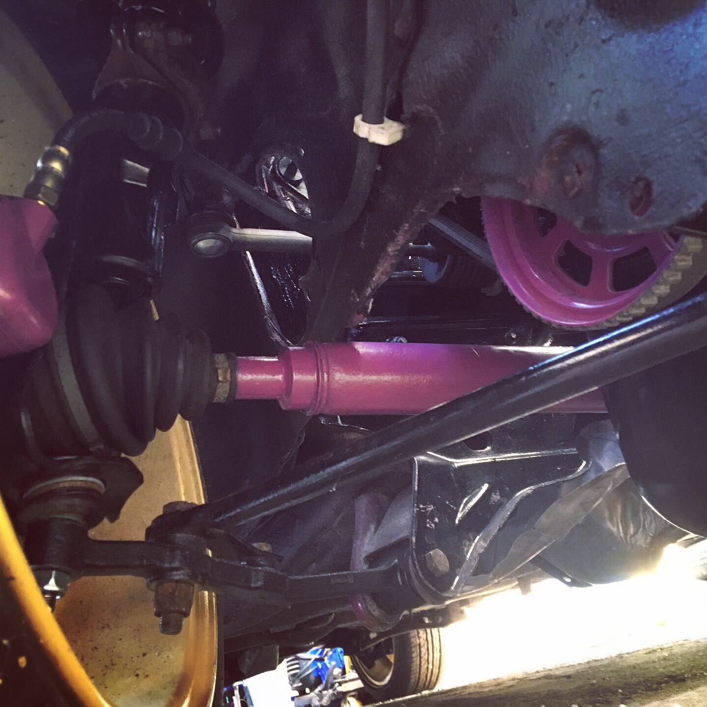

Replaced the rear trailing arms and bolts too

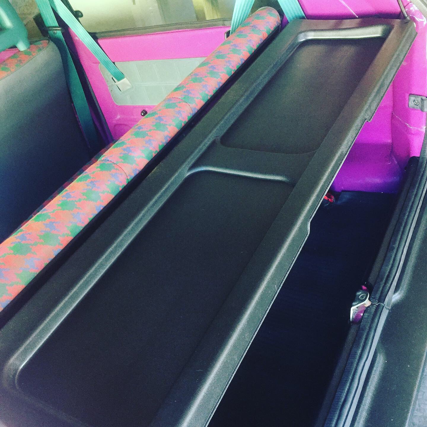

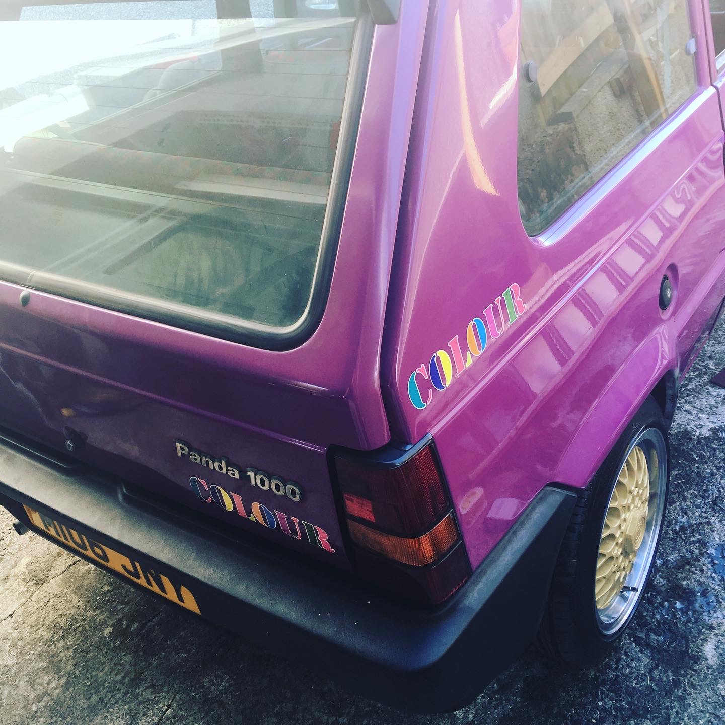

bought an parcel shelf that doesnt have holes in it from italy.

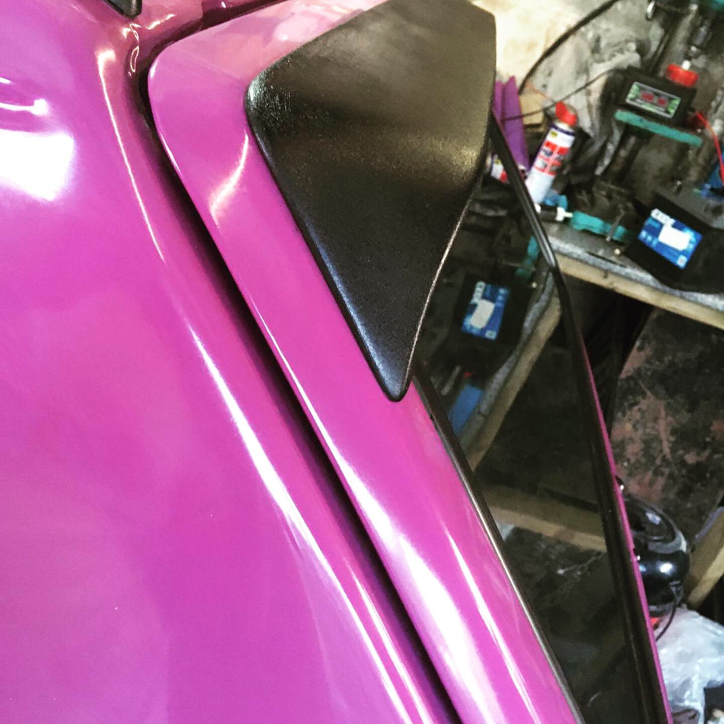

I've also bought a spoiler from Italy, it came as raw gel coat but with a bit of primer and textured paint it matches really well.

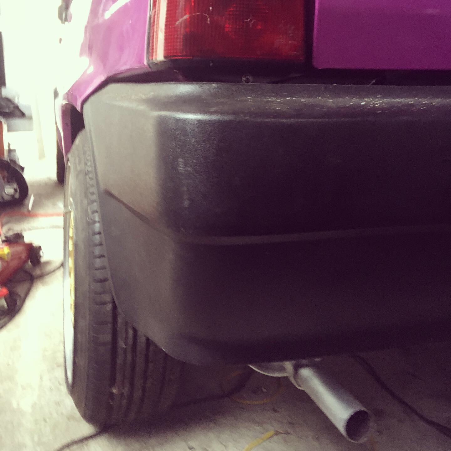

also fitted 25mm spacers to the rear to fill out the rear a bit.

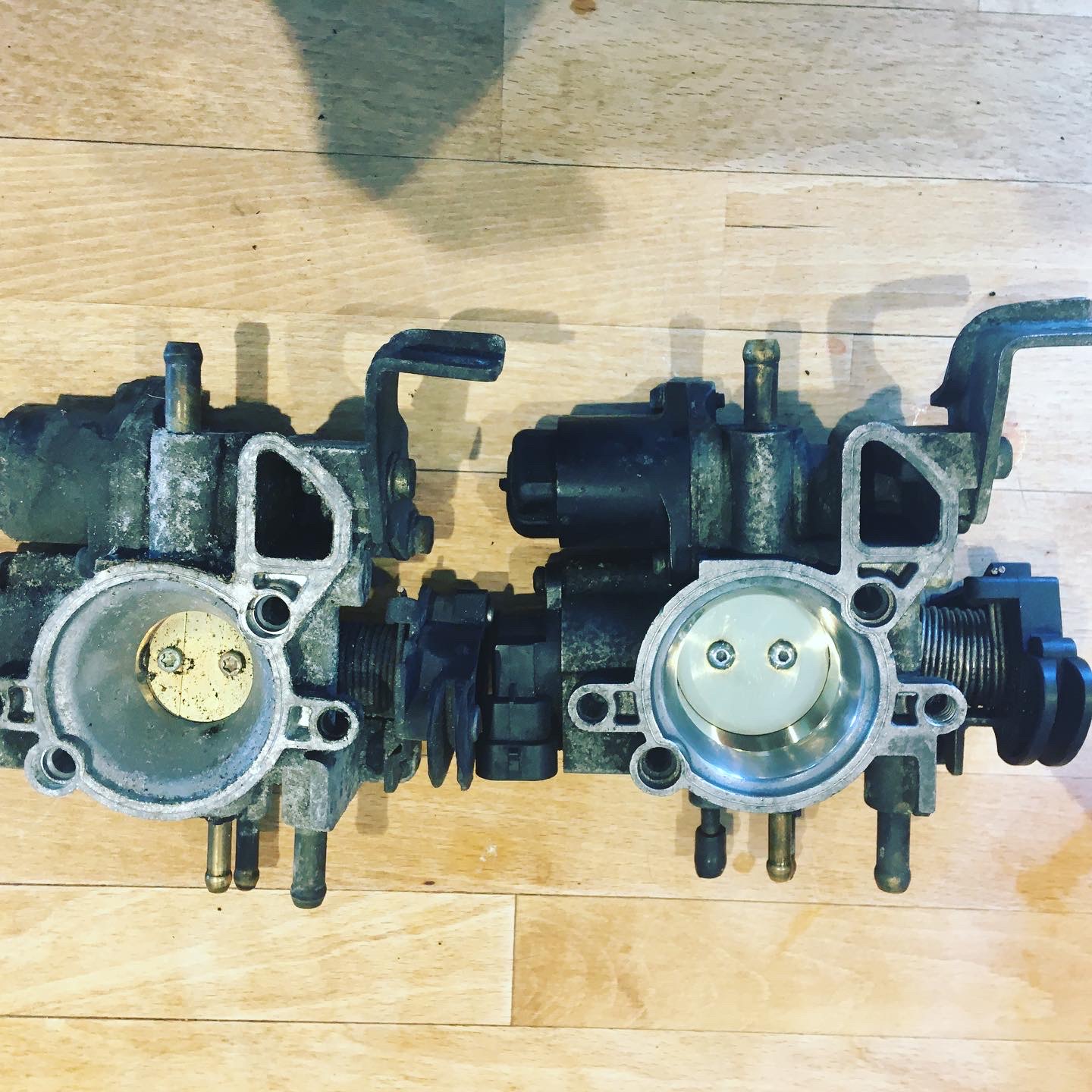

manged to get hold of a 40mm throttle body too!
before and after.

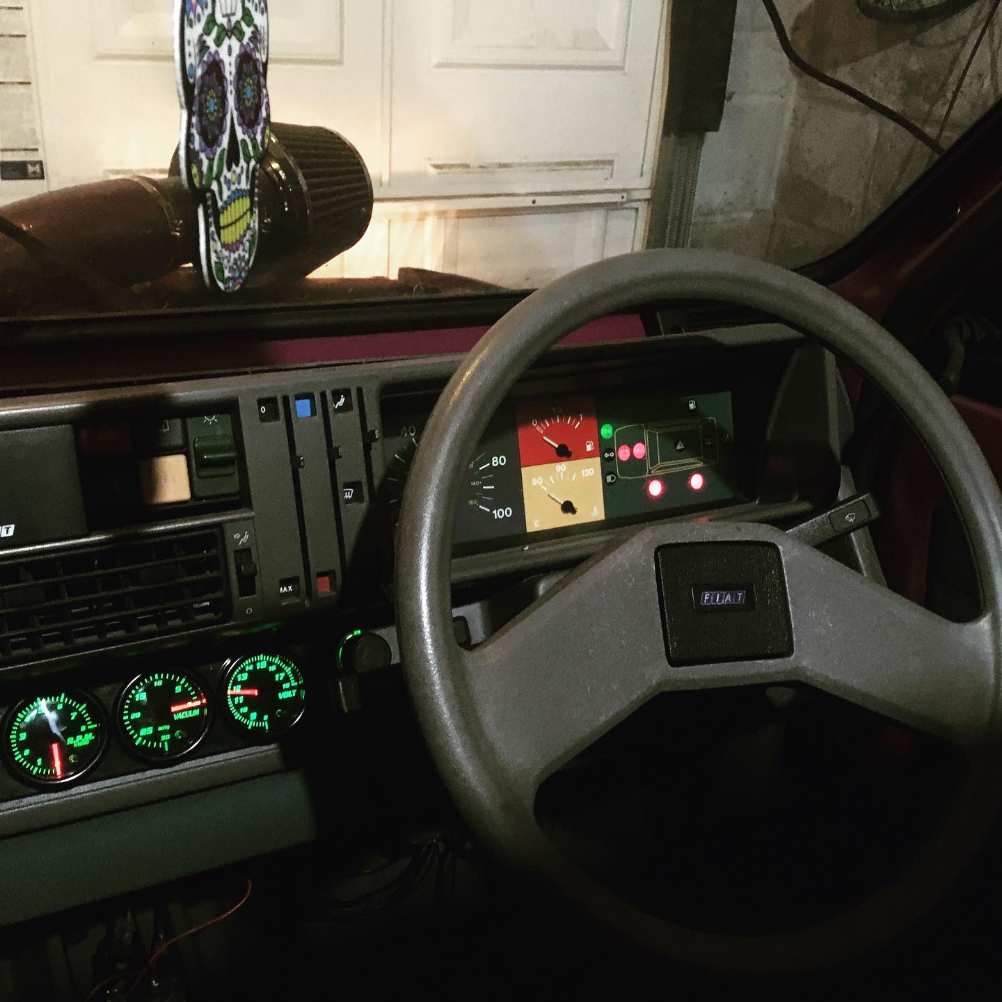

guages all fitted,

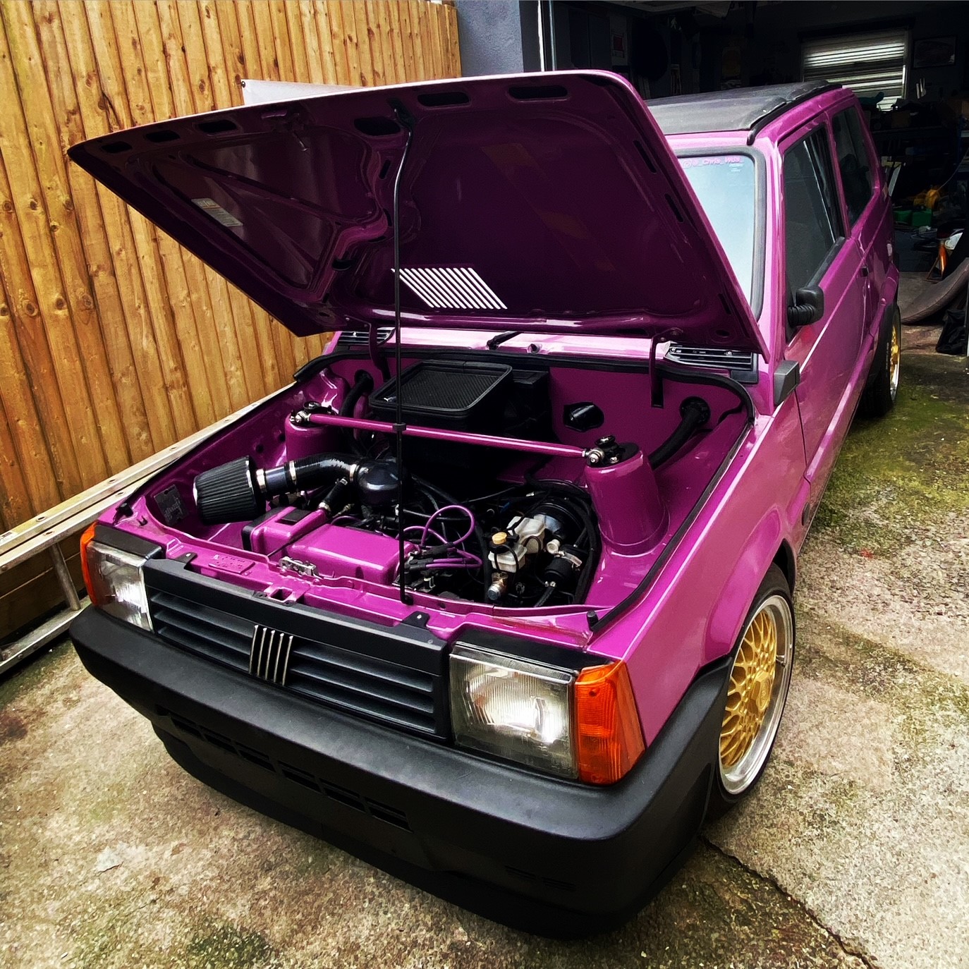

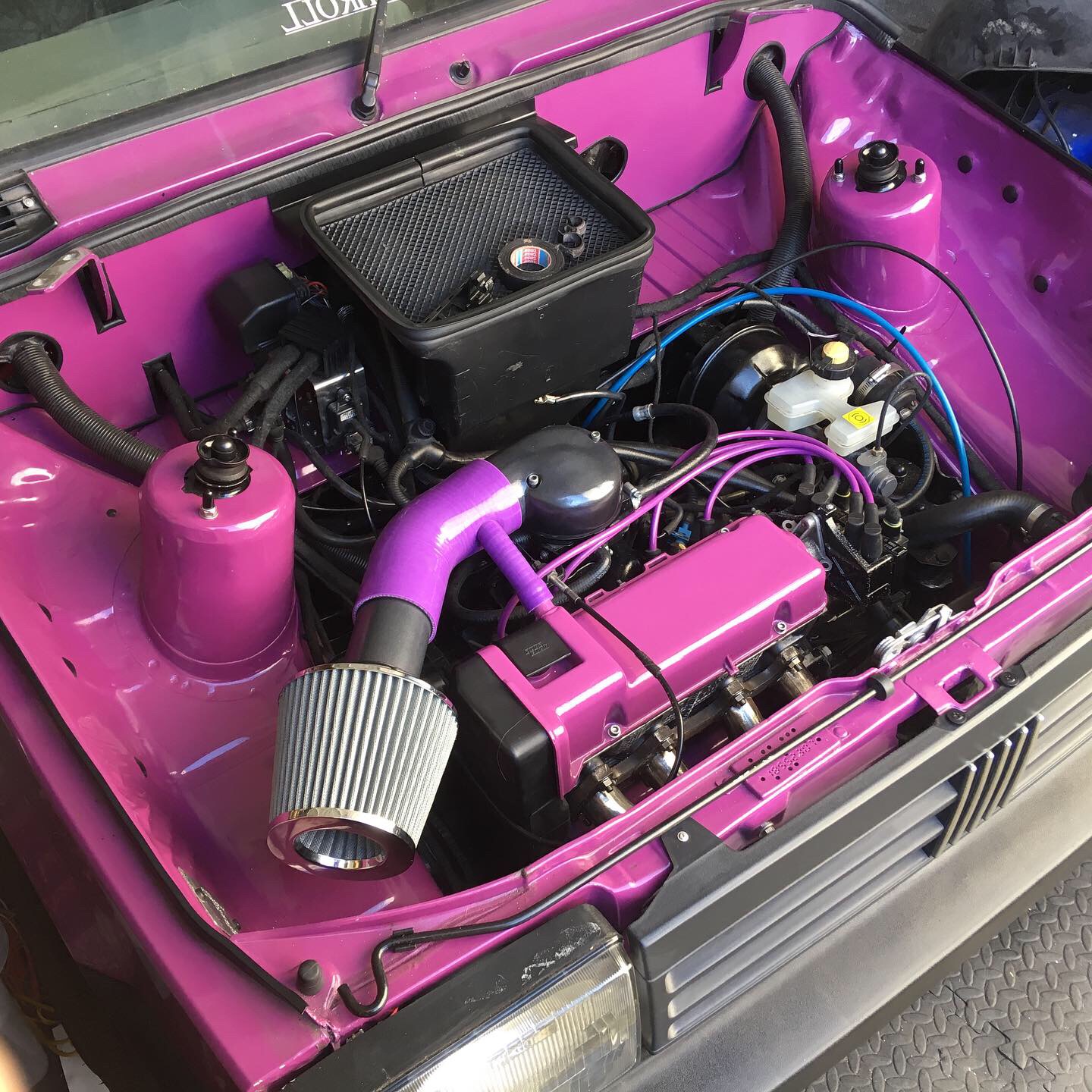

that silicone pipe on the intake an off shelf item? spent ages looking for something like that when i was doing my old panda and failed lol
OP
OP
C
ChrisPandColour
Bring on the stainless!
Mar 8, 2014
95
Cardiff
I wish! its a 70mm 45 degree elbow, then i cut a hole in the side and found a pipe fitting that allowed me to push fit the oil breather to the side of it, iv'e cut it with the curve of the pipe so even close up it looks like one piece .

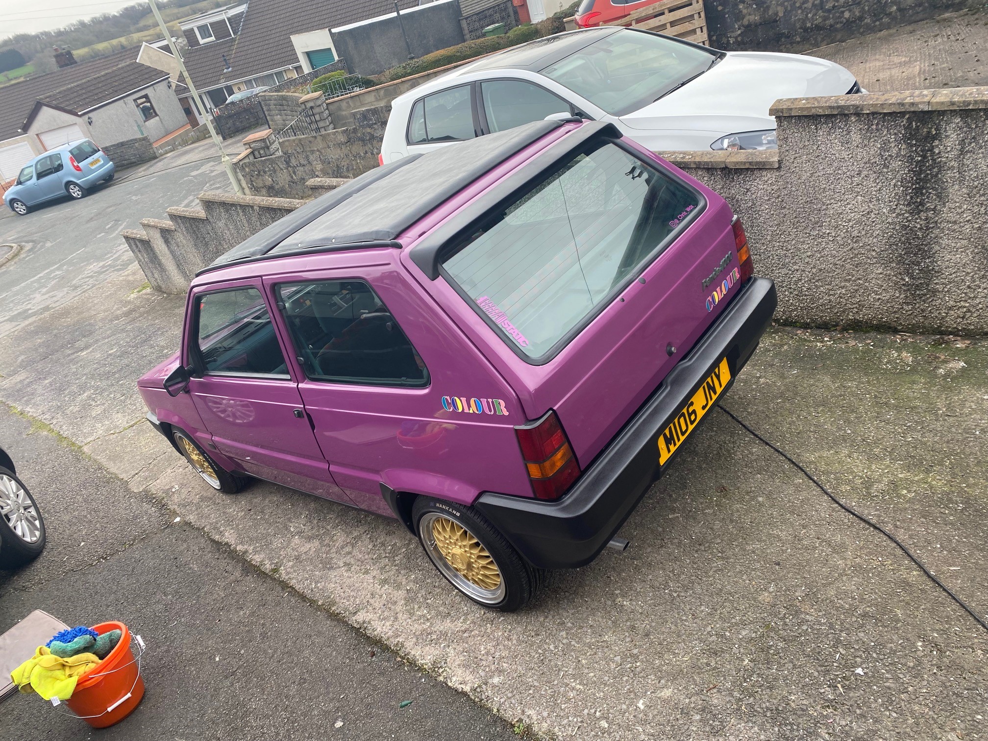

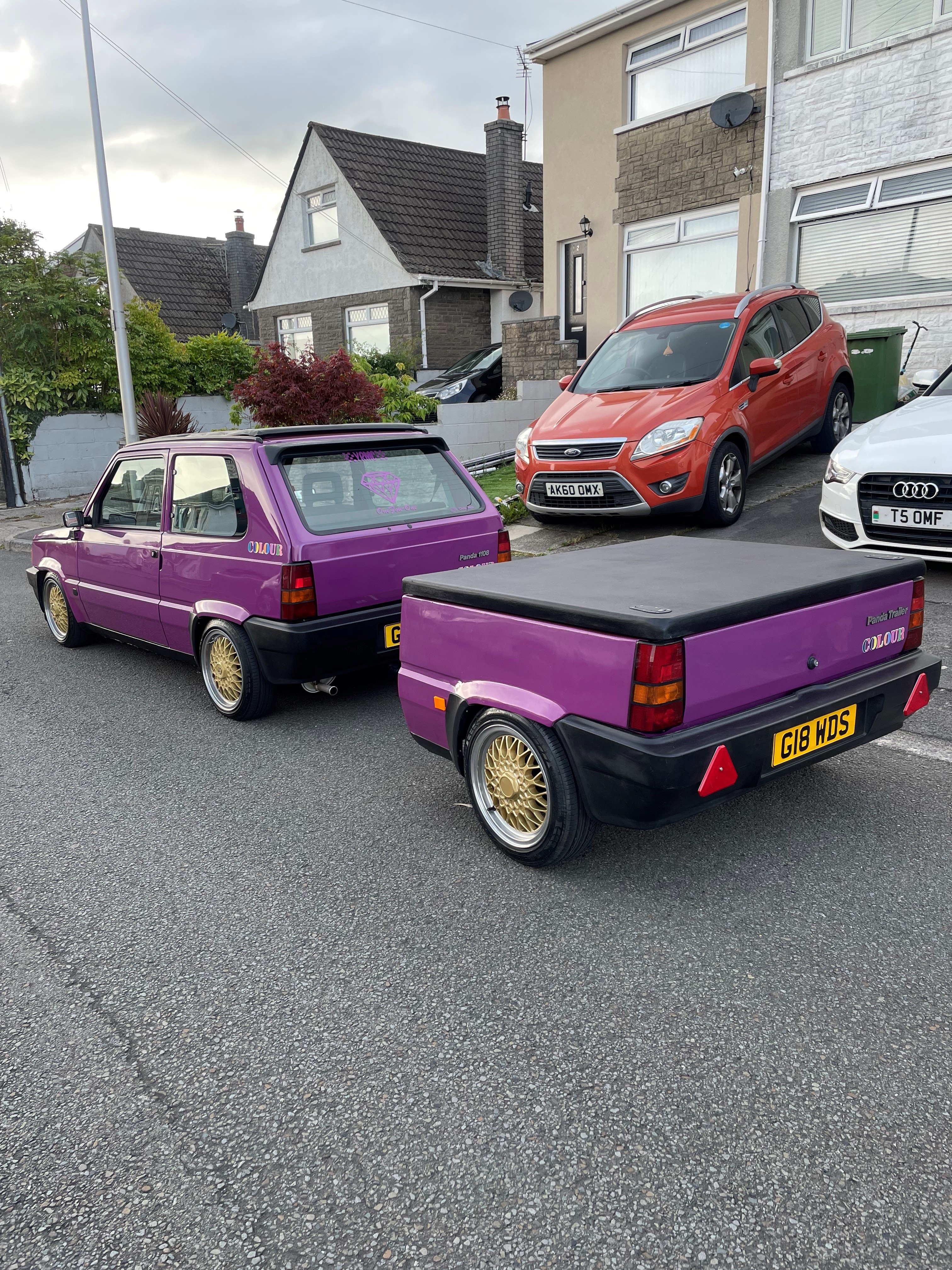

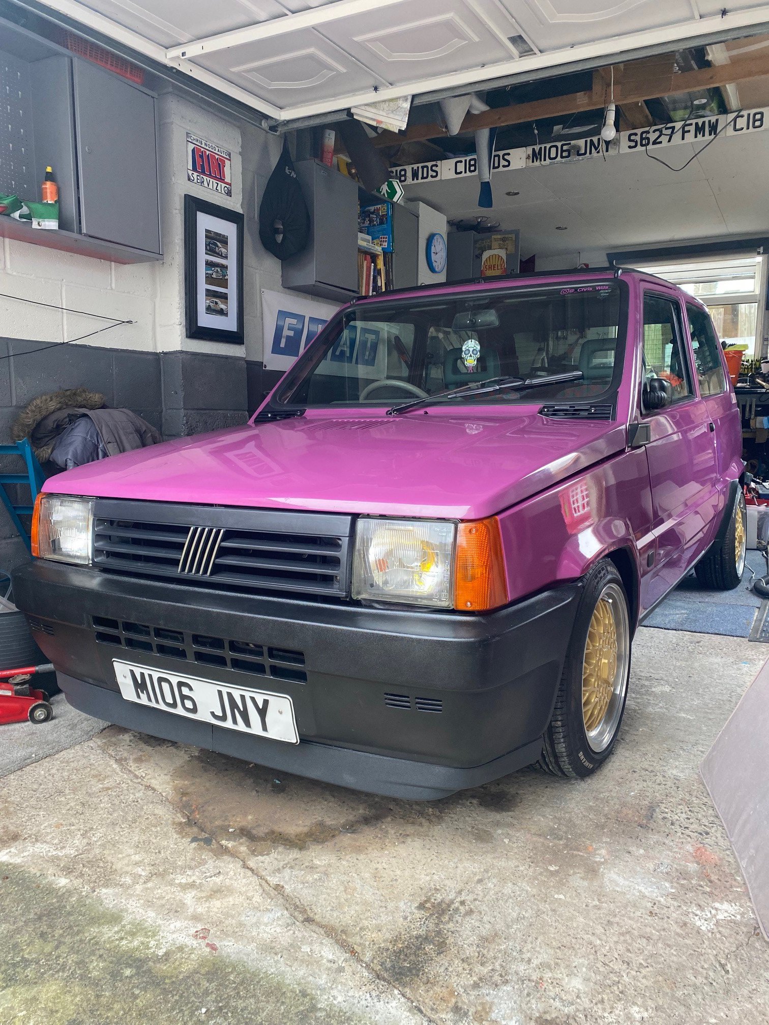

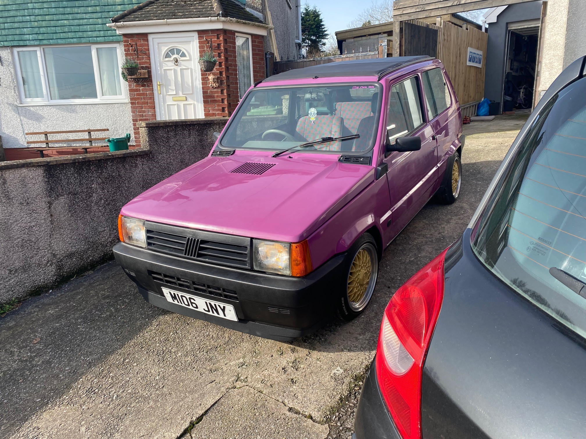

So here i am with the bi-annual update.

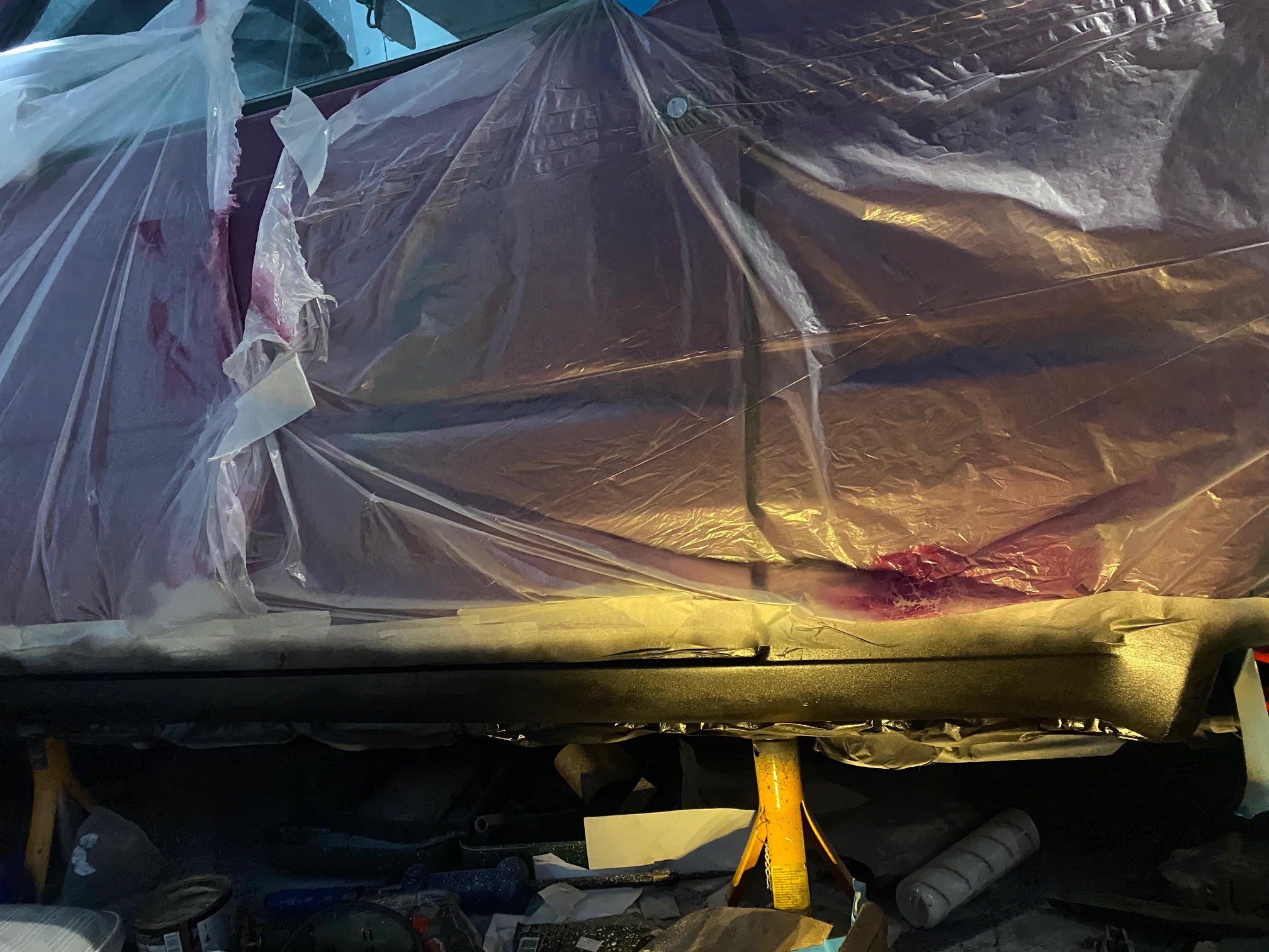

so i've finished all of the paint touch ups, all of this is temporary before it has a respray next year to get it all looking its best,
The car is pretty much finished now though, looking to book an MOT this month, so it 8 years since i started this thread it will be going on the road.

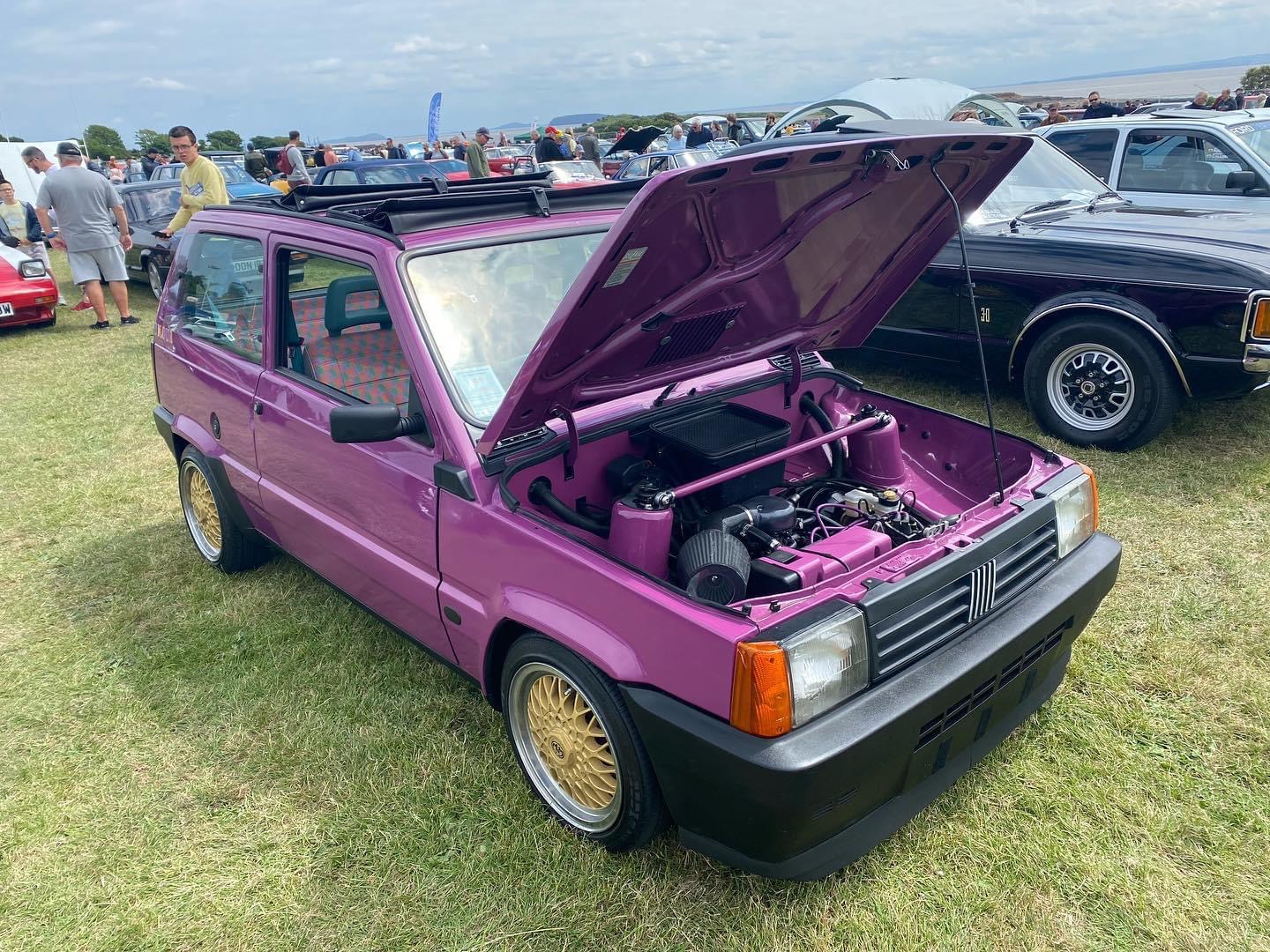

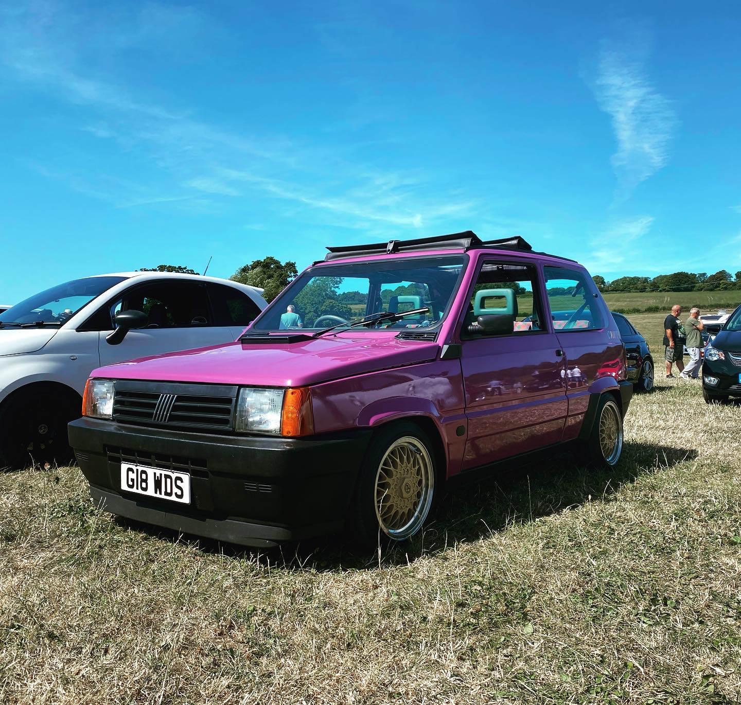

Few pictures from last years shows
