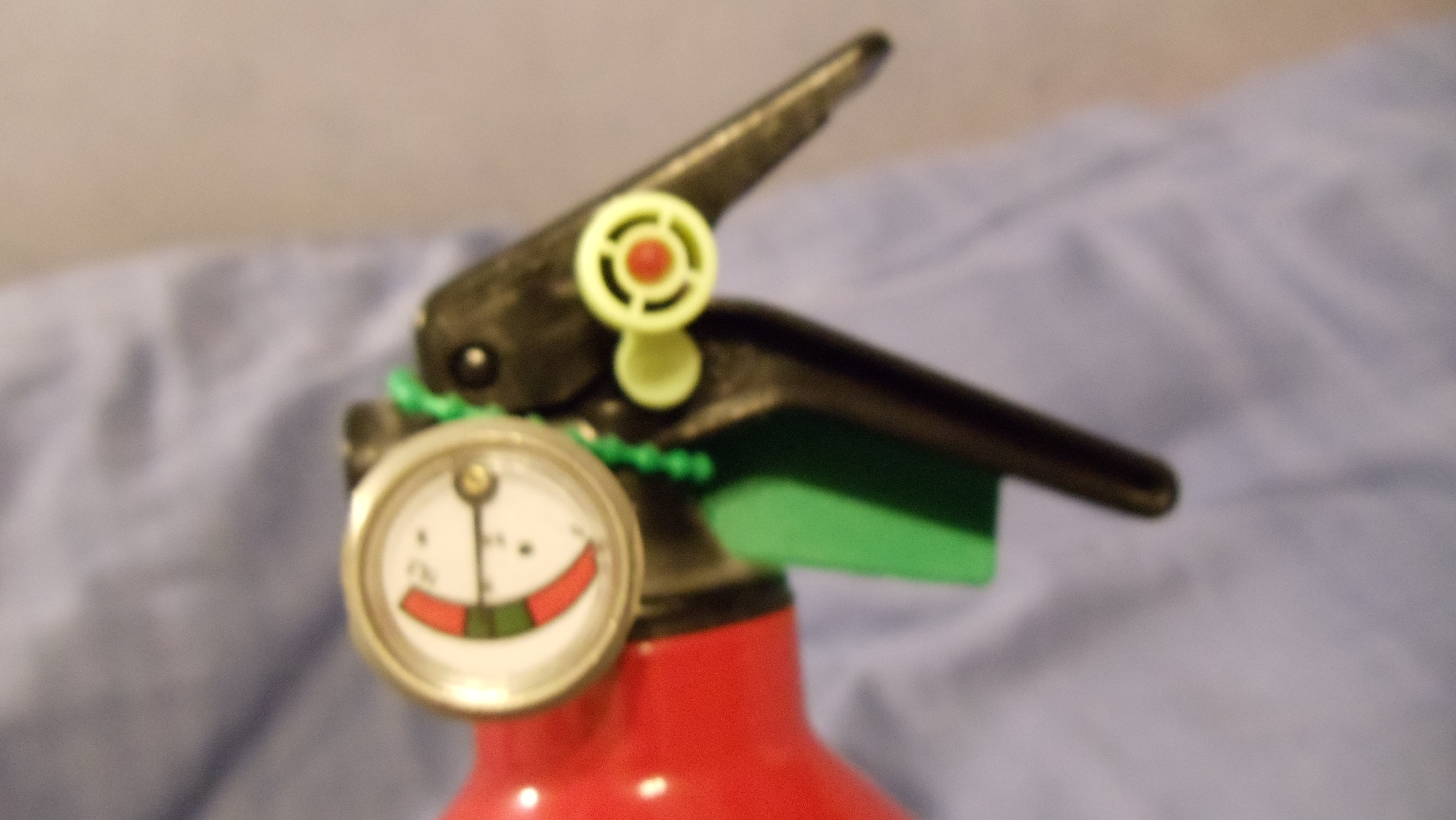

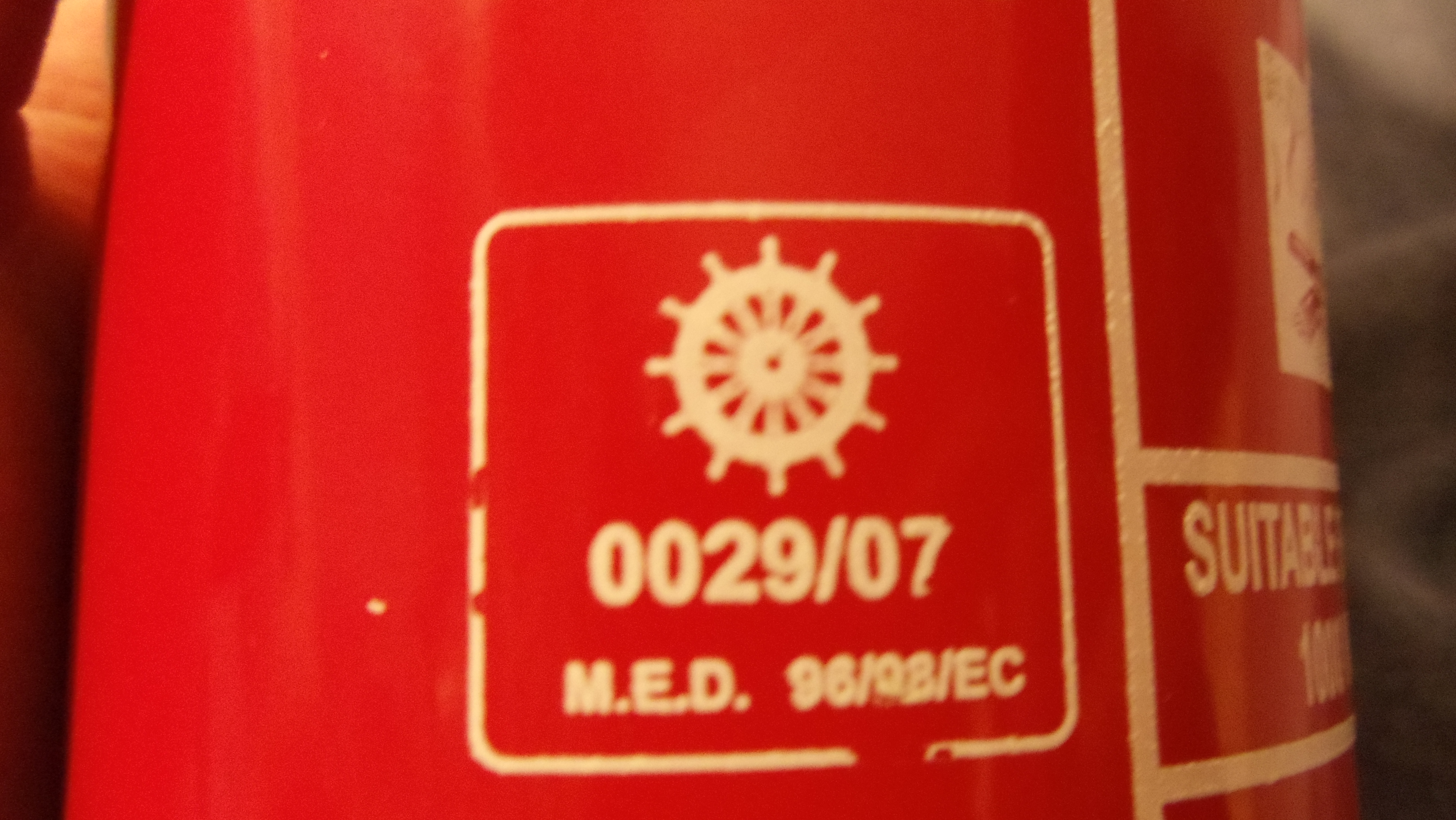

Oh and one last time you get what you pay for this was a "extinguisher" i picked up a few years ago to play with based on a Aerosol can showing pictures of a burning car thought it might have at least been able to handle about 1/2 a pint of petrol when in reality all it did was spread the fire.. it worked ok on burning paper however ..........
