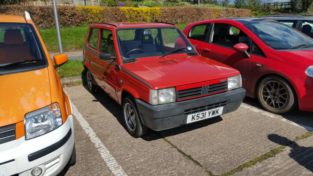

Few hours and a pitstop to eat a Subway for brekkie and then.... A wild Charmander appeared :D
Was not the best weather on the drive back but Char' ran faultlessly

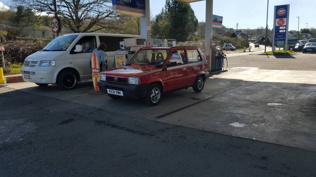

Stopped about halfway home for quick pitstop and to get a pic to share on facebook for all the people guessing what I had bought before it got too dark.

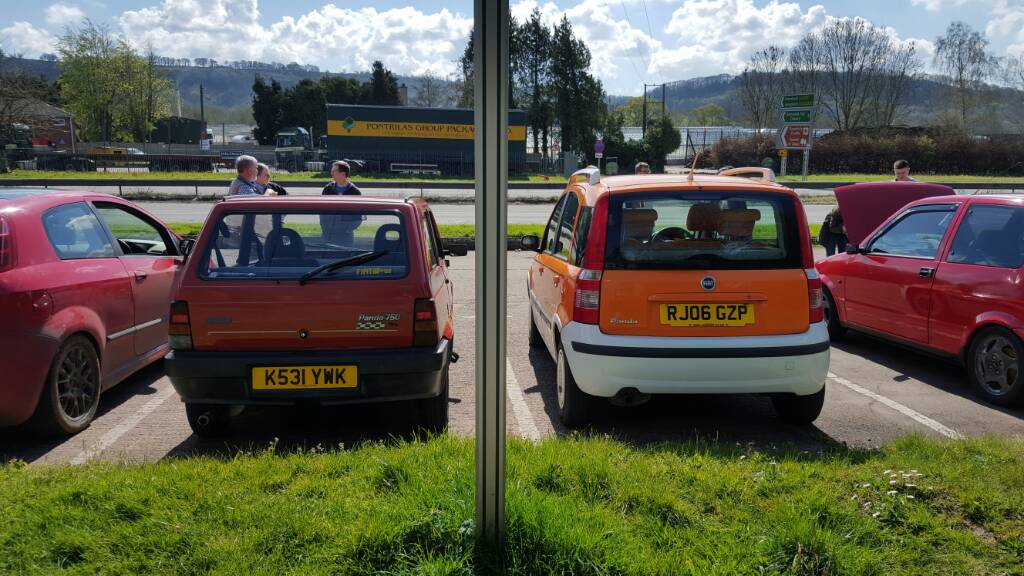

Couple of snaps from today.

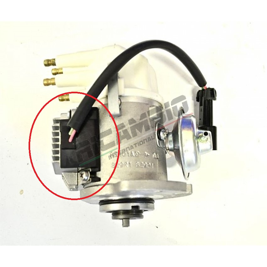

another question.... whats that box on the side of the dizzy do??
mine does have one yeah - looks retro fitted (held to the dizzy with cable ties rather than screws).... So this replaces the old style condenser thingy?

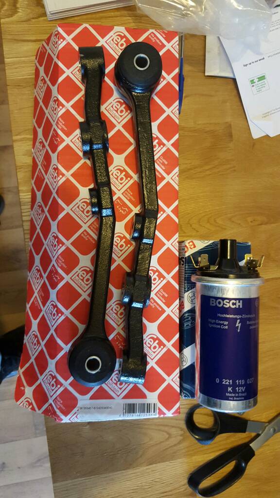

Postman has just handed me a shiny new Bosch coil so will get that fitted up at weekend even though i highly doubt thats the issue. Do have new points coming as well just cause they were so cheap, and a new rotor arm.

I think its probably the magical box on the side of the dizzy.
Right OK, So now I have done some reading on this so called 'pointless ignition system' I get how that works now and there is zero point in me having that 'black top ignition' box. So plan of attack for the weekend is to fit the new coil, cause i got it and its shiny, and remove that 'black top ignition' box. And then check for any snagging wire and clean up any earthing connections I can find.
That ignition module.... I found Dragon Man diagram in another thread, this one...
I see there is an earth on that module, where does this actually earth? I assume it just earths on the dizzy housing but is there a wire (don't recall seeing one) for that or is it just the base of the module touching the dizzy body that earths it - i'm sure this earth is uber important is all so just wanna be sure on this one.
Assuming the car works after that then it can have new control arms and stabliser bushes fitted.

Do you have the Hall effect signal pick up unit inside your dizzy or cassette with mechanical points?
Sorted this a few days ago :). I had a spare distributor and coil from a 4x4, they're electronic ign. and are a straight swap for the type with points, as the engine will be replaced soon it occurred to me that it wasn't worth buying new contacts (£25) for the old distributor so in they went.
So taking that as its not got mechanical points (y) reading is far easier than getting oily sometimes. Sadly it never did get a more powerful engine though haha.
