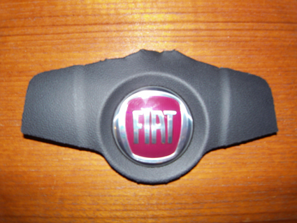

The only badge not easily findable. The only way I got mine was by contacting a breaker, who sent me it in return for £10 of my dough. A lot of breakers only want to send it with the airbag and everything and charge you a fortune, so it's worth emailing a lot of breakers. I received this in the post:
The badge is attached with teeth through the plastic as shown here:
The way I found of removing the badge was to simply cut through the plastic, which is soft enough, and then the badge will come out with its teeth intact nicely enough.
