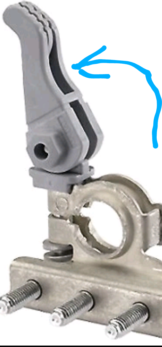

If you want to try it just disconnect the battery negative, it acheves the same thing and easer to do, the negative is on a cam lock

This one is already open
Just push on the lever to this position
Keep you fingers away from the back when you push it open, if tight it wil give them a wack
Unlike the guy in the video
Nope
As long as it has the quick connect, most have post 2005, at least I haven't seen a later car without one
It's fingers only
Some can be fairly tight some are not,

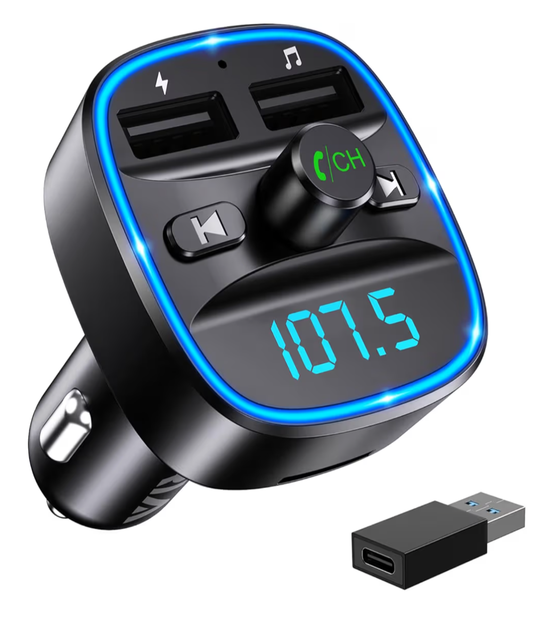

The simplest solution would be to put your songs onto you phone
And use something like this
Which connects to the phone by Bluetooth and transmits via an empty radio channel, this always works
If your radio has USB you could put your songs on the a memory stick
Aux cable is a bit hit and miss, if you toggle the source button on the radio and you see aux come up it should be fine

Yes, I've been using a Bluetooth FM transmitter for years now.
Suits me just fine for playing mp3s from my phone.
With a few conditions:
It picks up interference when we're in a city or sometimes from passing traffic.
Not often a problem for us out in the country, but if you're in urban areas or heavy traffic it might get annoying.
You can set the frequency, finding one that's reliably free from other broadcasts might take some time.
Due to Fiat's odd spec of lighter socket it sits quite loose and can easily lose connection if knocked
It seems strangely quiet. So I put phone volume to max, then raise the stereo volume to about 40 or so.
None of this bothers me too much because we don't use the car that often, very rarely in traffic and I don't usually listen to music in the car anyway.
It's just there for occasional long motorway slogs or if the other half feels like an early-noughties euro-trash rave :) Which does happen 😐
But if you're serious about your driving tunes I'd suggest the bt transmitter is sub-optimal
