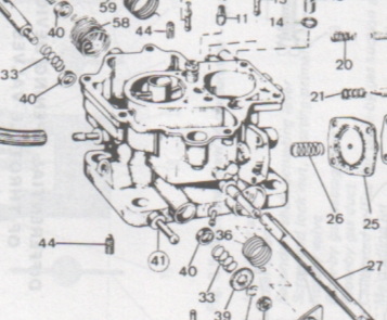

Had a look at the kits but have to admit to be puzzled about which one would fit. Does the gasket not require space on the gasket for the floats? My Haynes book says I have a webber 34 DATR.
Would I go for the £12 one?
Many thanks

bigfatbloke,
Don't tell me that I have to bid against you again. I thought £11.50 would be enough !!!!
It is - The £12 one has new jets included.
I have just discovered this as I bid on the cheaper one, meaning to get the £12 start price one :bang:
