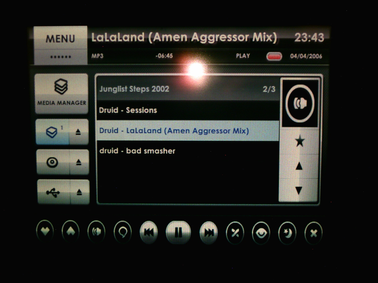

Well i finally got round to putting all the parts / installing / testing the car PC this evening. So heres a little taster :p
The Mini-ITX in my custom made case - still needs to be painted, but still gives you an idea :p
It all up and running using a standard power supply - when in the car it will have a car smart PSU so will turn on and off with the ignition. It will also boot straight to my media front end, but still messing at the moment.
The media front end (Centrafuse). Just got to edit the skin so it highlights yellow instead of silver/blue :p
Will see some better pics etc when its all done, just thought id give you a little taster :D

Yea runs windows. I tried to put linux on it first, but it didnt seem to like my motherboard when installing :( So was kinda stuck with XP.
Its running now, just need to make the custom console for it all to sit in. But Brooklands a saturday and i cant take time off, so you'll have to wait till stanford if you want to see in the flesh ;)
As for price, erm, lots. :eek:

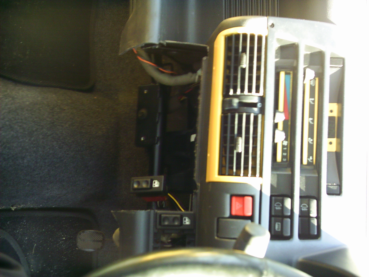

As an update, ive just been out and measured up the console space needed and marking out the console using some fibreboard and cardboard to make sure it'll all fit nicely. The gaping hole in my dash at present:
