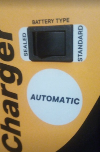

The only thing I would query is that the switch should be to sealed rather than standard. I believe the sealed switch could enable charging at slightly lower voltage as there will be no topping up facility.
Would be interesting to see if Halfords know.

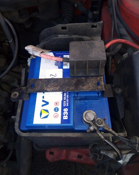

Is it a sealed battery
From the photo it looks like it
Sealed battery’s don’t like being left discharged. There’s a irreversible chemical reaction

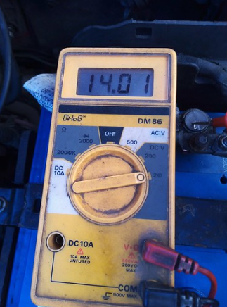

Today on Wednesday 7th December a friend called and did a test with the Multimeter and I then did a 5 mile journey afterwards and all was fine.
I will use the car every third day now and short journeys off 8 mile (4 miles there, break and 4 miles back) but every 10th day will do the 30 mile journey.
Checked with the Battery Company Vartar and they told me the following (I asked them if the battery was Sealed or Standard):
"Your battery is a Blue Dynamic 544 401 042. It is a flooded lead-acid battery and it has a sealed construction, so that it is spillproof"
They (Varta) also provided me with 2 web links:
I will admit one thing here - Bought the battery new and fitted it in December 2021 and first time it failed on me was early November 2022 so took it out and charged it as Standard and not Sealed even though I now know it is a Sealed battery and the battery only took 2 hours to charge.
Here are the Multimeter readings:
Multimeter 1 Still Photo Reading is before the Car engine is turned on.
Multimeter 2 Car Engine Turned on and Running (52549019141)
Multimeter 3 Still Photo of Reading whilst Car Engine is Running
Multimeter 4 Car Engine Turned on and Running and also Lights Turned on (52549567663)
Multimeter 5 Still Photo of Car Engine Turned on and Running and also Lights Turned on
  • 52549019141_b724203044_vm.mp4
    30.8 MB
  • 52549567663_1dd65b5cd2_vm.mp4
    17.5 MB
