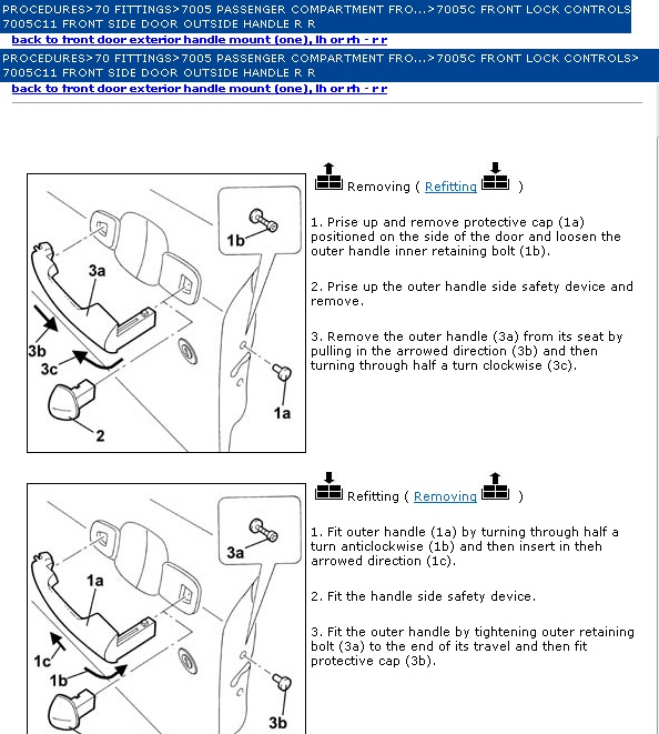

p.s. added instruction for handle remove from fiat stilo cd.

i just did the door handle removing trick (see picture above) and was able to lubricate both cables left and right by lifting the mechanism with a screwdriver and spraying a graphite-based thin oil on the cable whilst moving it up and down to get the oil into the cable.
No more problems with frozen door handle cables - it's definately worth the effort ! (just half an hour for both sides...)
