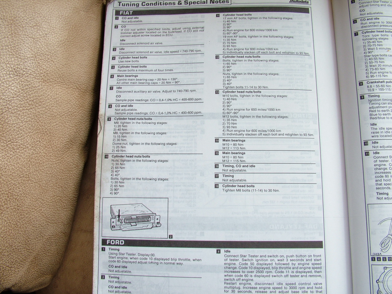

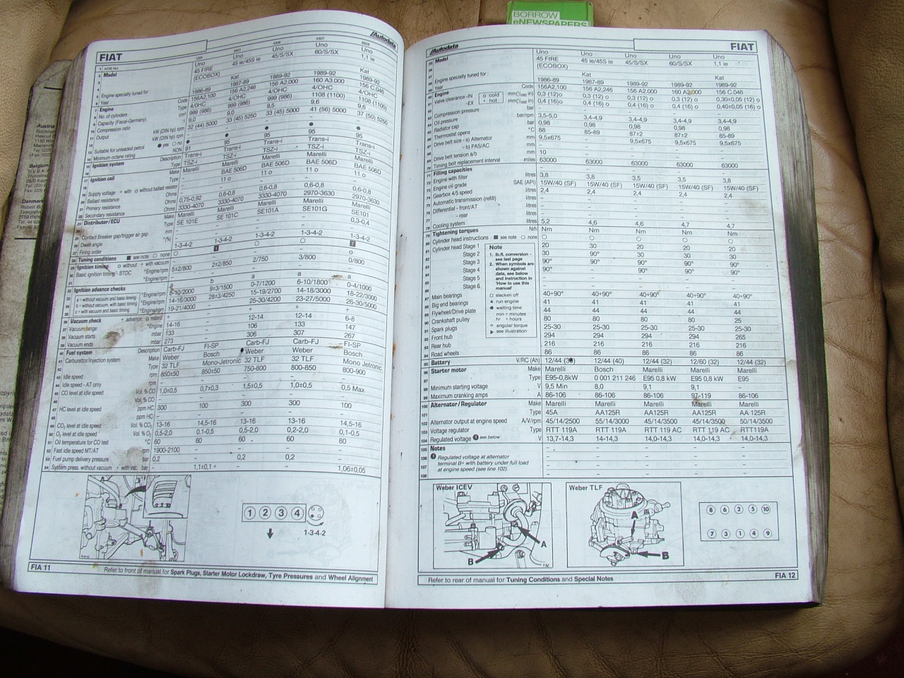

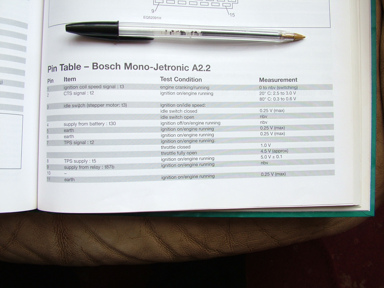

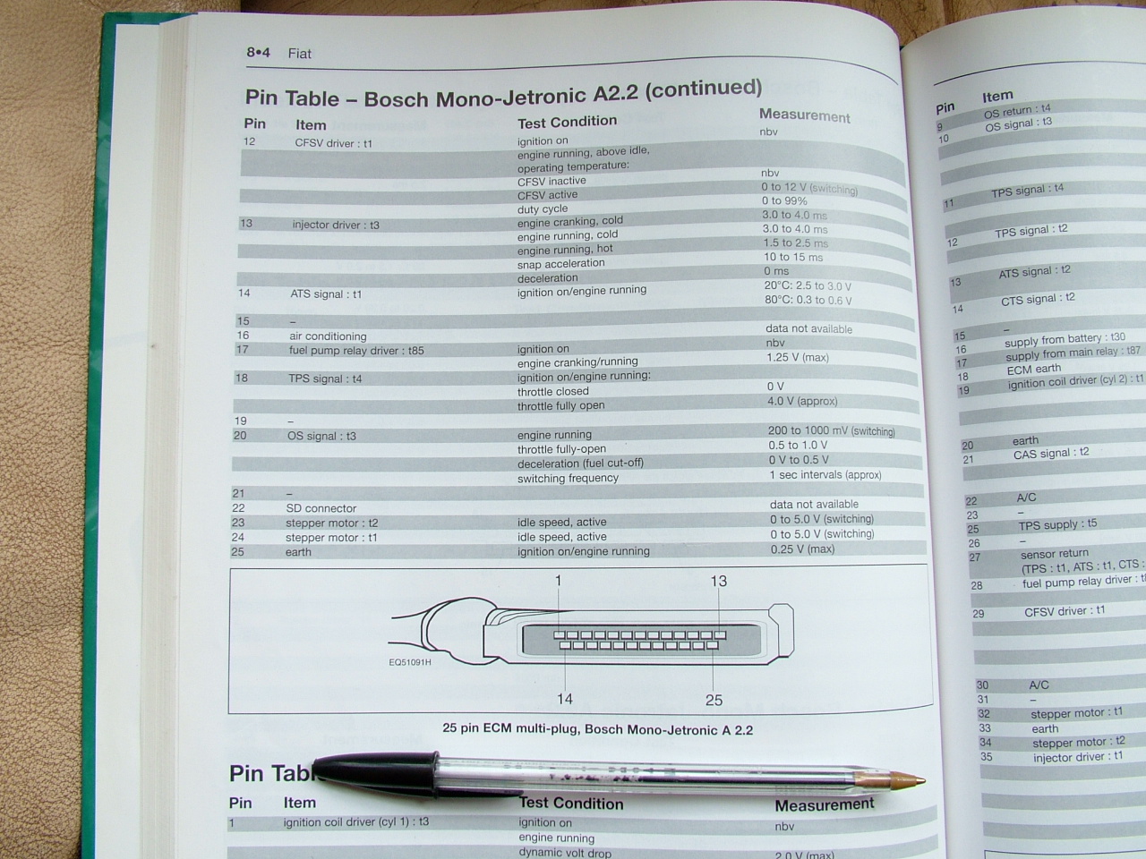

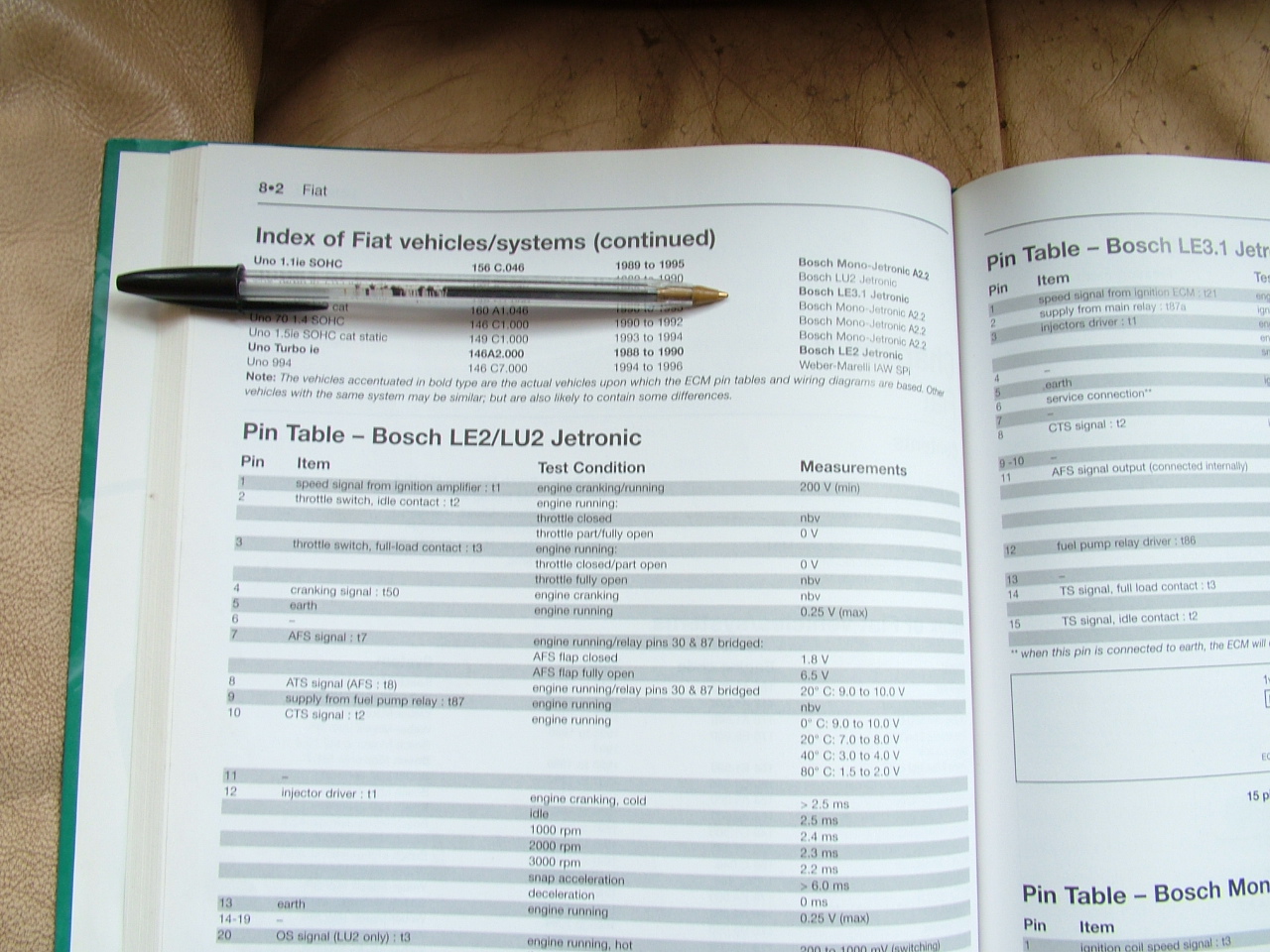

All I can find from a technical point is these photos if they relate to your model.
In the first photo I think yours is in the right hand column 156 c046 engine series?
