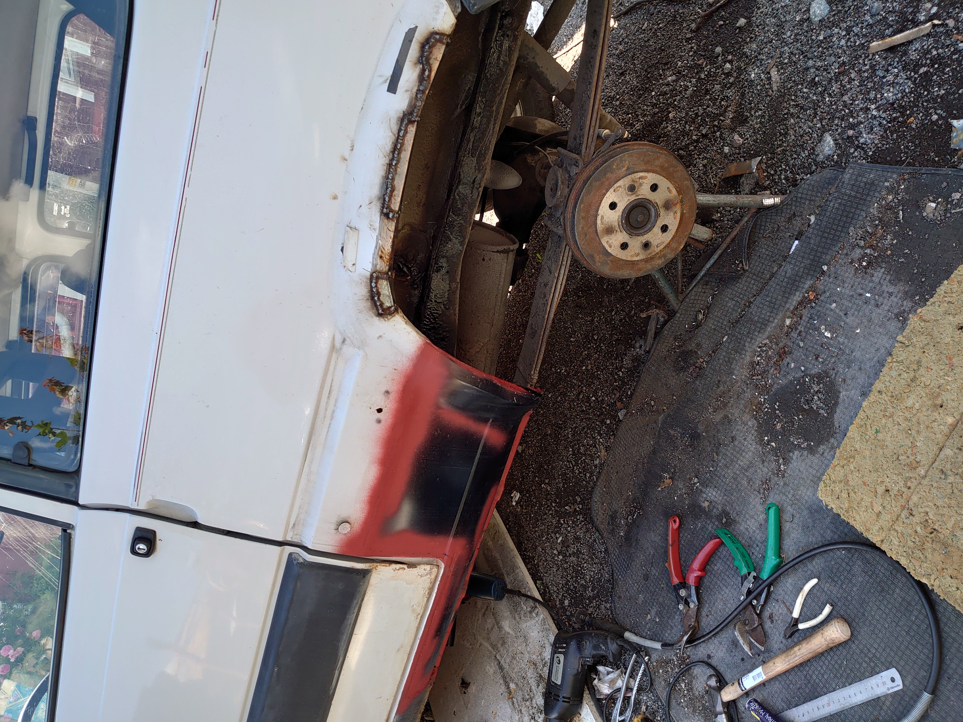

Before painting I hade to get some rust sorted out, this is sweden and salty winter roads aren't the best thing.
Biggest problem was where there are three layers of steel right beside the front leaf spring attachment. The innermost layer was completely rusted up and had to be replaced. To tight to get up in there from the inside so away came the outer panel. The factory spotwelds along the bottom seam had also detached about half way down the seam so I basically replaced half the outer sil.
Alot more difficult than I imagined, this was really my first real welding project so I was nervous as s*it welding near old cavity wax and all, don't wanna burn the car down.
Turned out alright though, and managed to fit the replacement outer panel quite nicely.

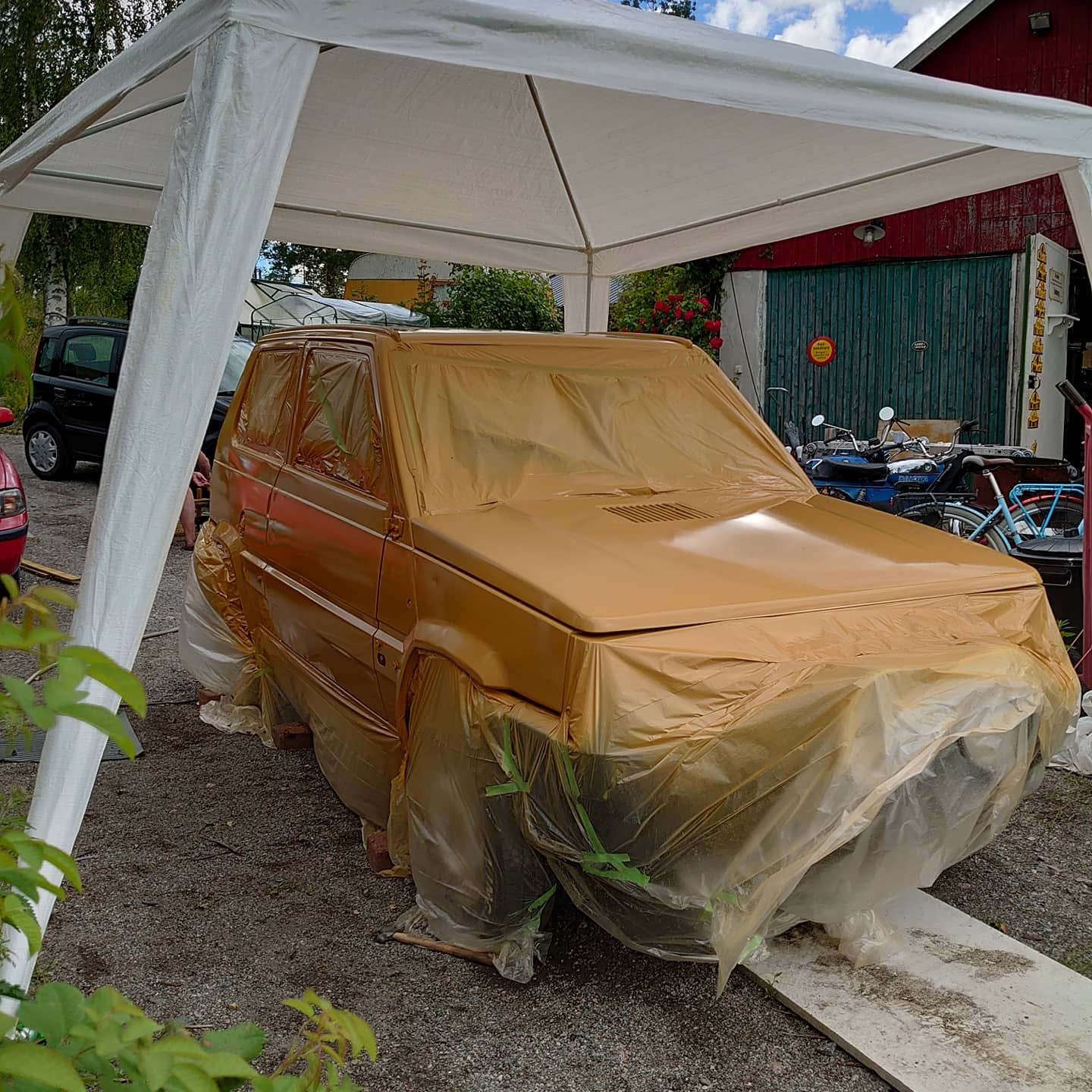

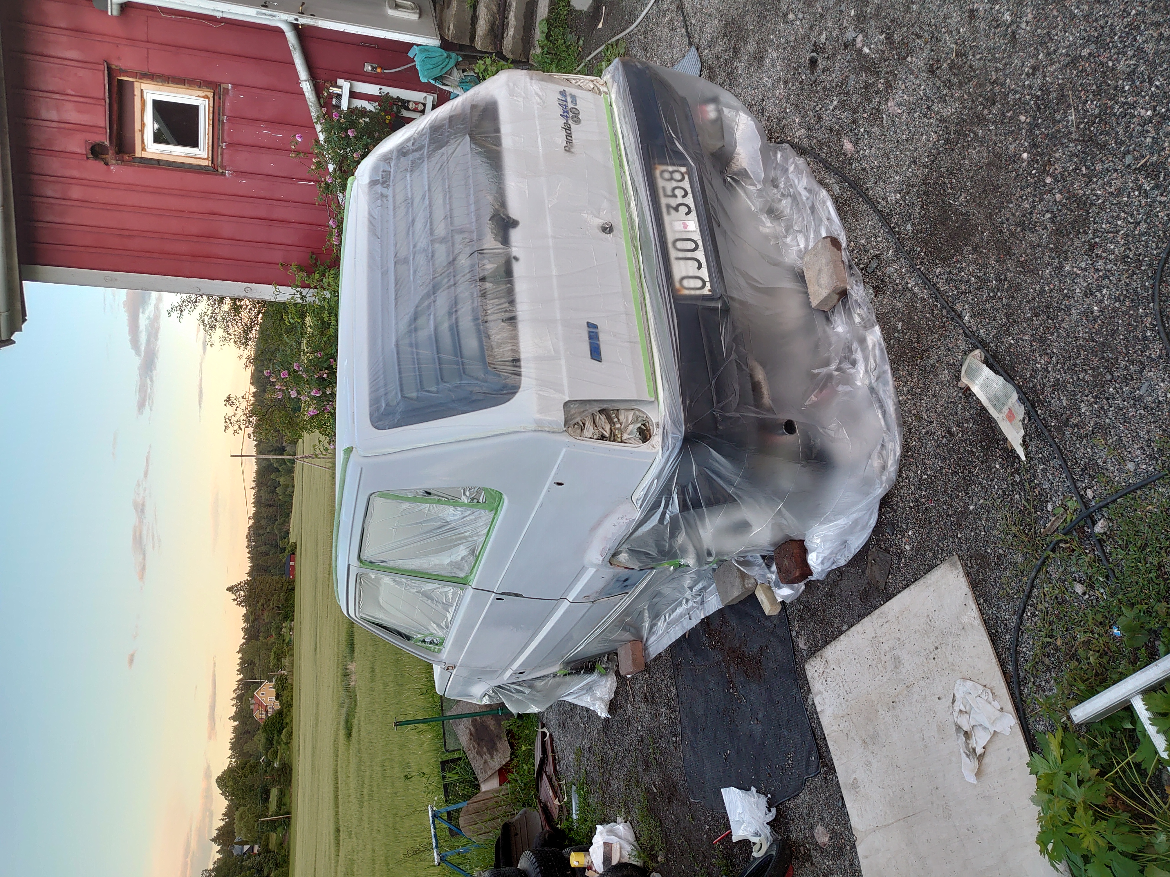

After welding it was time for paint prep. The paint that would be used was PPG Deltron 2K which I ordered in lrc 361 sand glow.
I sanded the whole car with 600 grit foam backed papper on a random orbit sander, and sanded hard to reach areas and details by hand. After that I gave it a good cleaning and de-greasing and started the masking process. The spraying would take place outside, so I put up a way too small party tent to give some cover and shade.
Degreased the car again after masking and just before starting the spraying I wiped the whole car with a tac-cloth. Then it was just a matter of spraying away. Result are good enough and I will wet sand the car with 1500 grit and give it a good polish.
I didn't bother painting the boot because I'll be replacing it with a behind from a panda van which I was finally able to find in italy. Still sits in my friend's garage in italy though so that's yet to arrive.

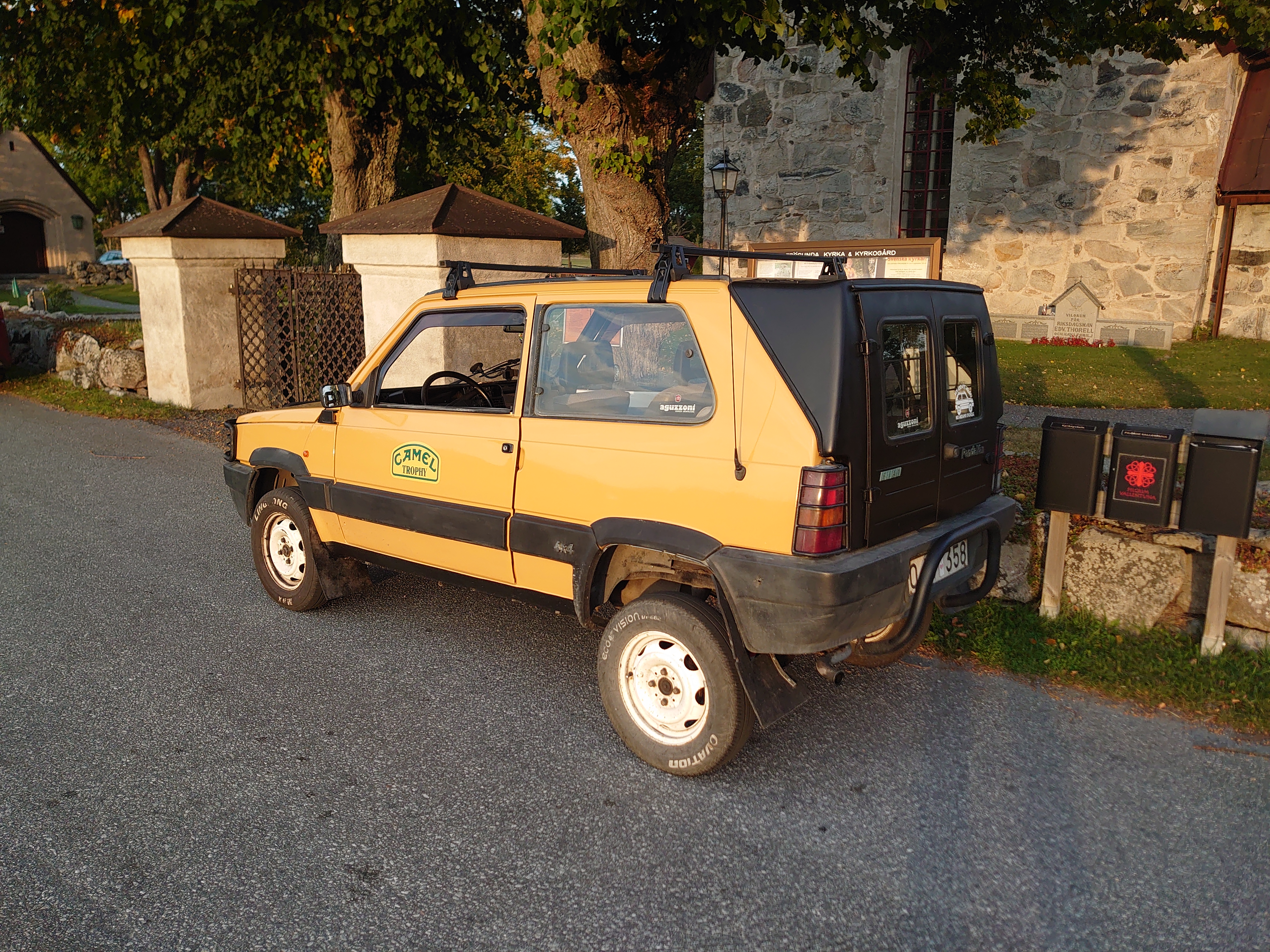

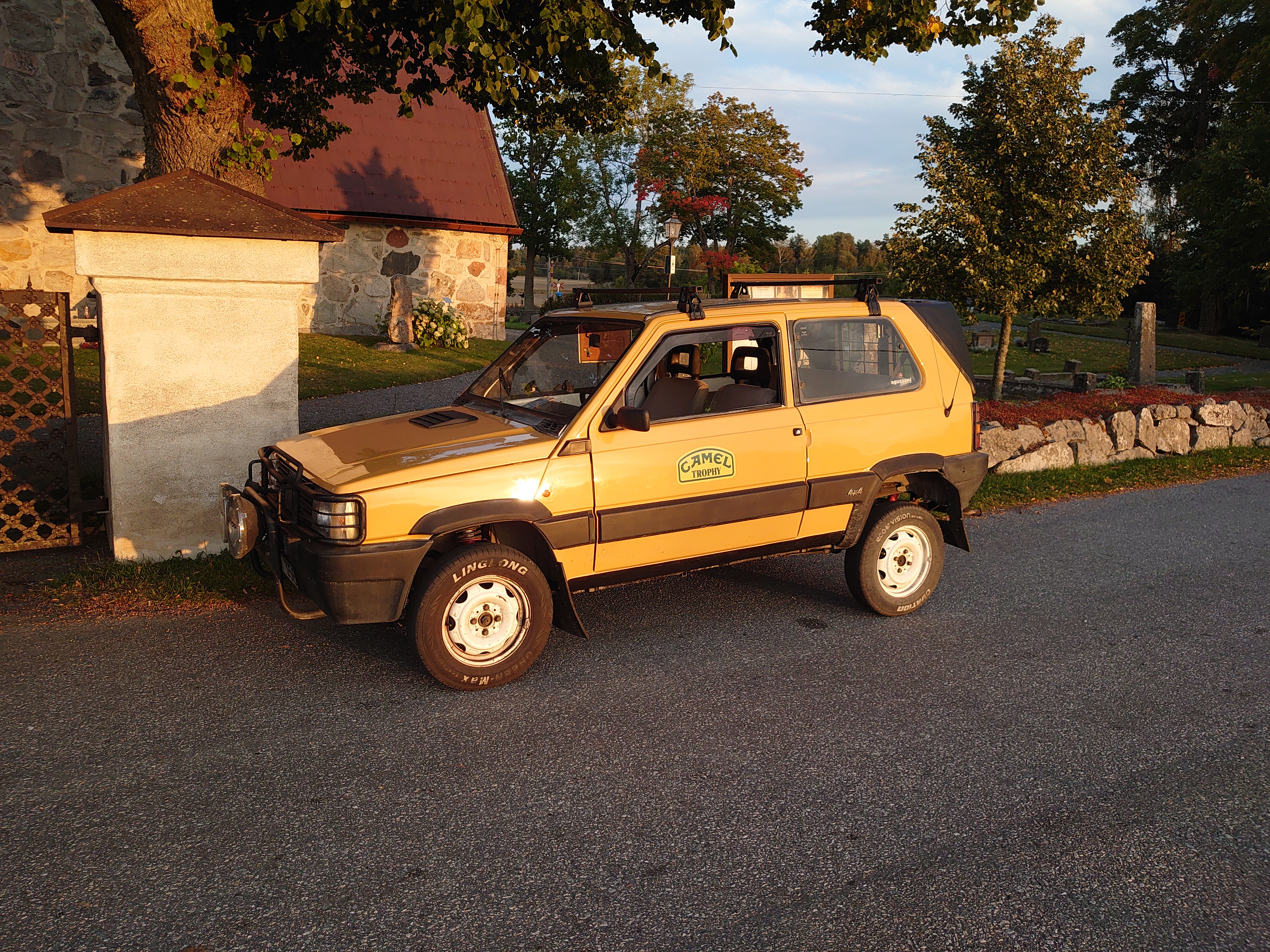

Hello guys. I kinda forgot to update this thread as I progressed. As the pictures tell the build is very nearly complete. I have yet to fit the roof rack, the engine skid plate and the side tubular protection, but other than that it's basically done.
And finally the van attachment finally arrived. I looked constantlly on an italian buy and sell site to find one for sale, and they popped up once in a while, but finding a seller willing to ship it to Sweden was a whole other beast entirely. Eventually after six months I found one kind soul.
But when he went to ship it there were problems with swiss customs so he had to ship it to my friend in italy who in turn could ship it to me. It sat in his garage the whole summer.
So six months after paying for it I finally recieved it. I feel very confident that this is the only panda "van" in Sweden, especially since the panda itself is extremely rare.
In the end I ended up paying more in total for the van bit than I did for the whole car back in 2014.
The only downside is that I liked the feel of driving the car better before I raised it, since this is longer springs fitted over standard length shocks (front) the effect is stiffer front, so at some point I might buy longer shocks to go with the springs.
The rear is fine, but holy crap what a hight difference changing the old leaf springs for new ones did. That combined with the nylon riser blocks the rear hight gain was about double what I'd expected.
