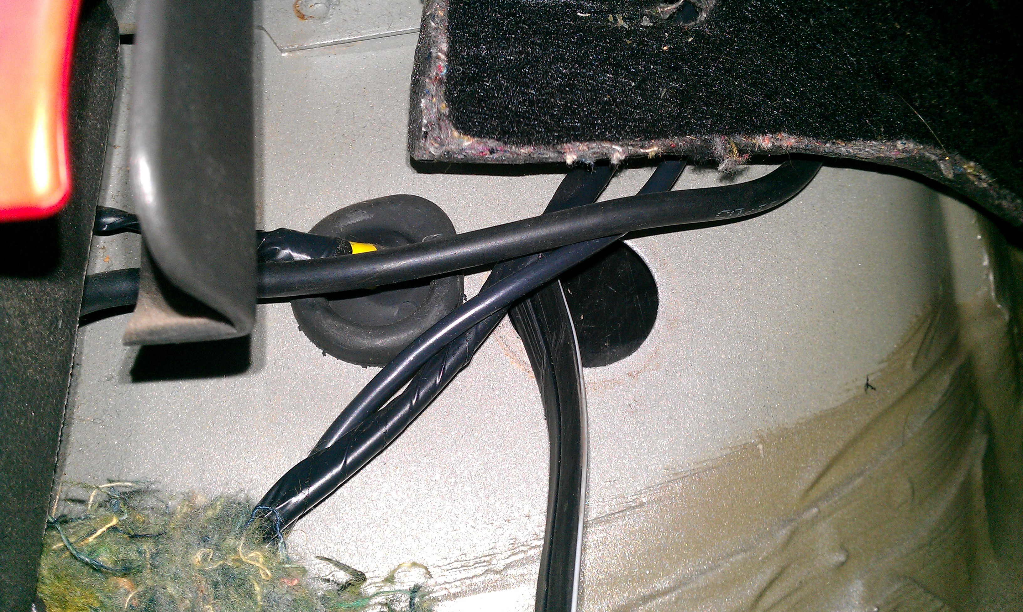

In the passenger footwell, alongside the bonnet release are two grommets in the wheel arch. Access to these is gained by pulling out the two large plastic plugs securing the carpet...
The red bonnet release is in the very top left of the pic.

So, with the second (blank) grommet removed, I used a length of white co-axial cable to 'fish' out a route.

As you can see, I have opted for a flat speaker cable - firstly, it was a length my lad didn't need - so it was free (y) and secondly, it is designed to take quite a bit of power to some very large speakers - so it should have no problems handling the 5w from my solar panel :D.
An added bonus - because it is flat, a simple knife slit was all I needed in the grommet - although I did pack plenty of rubber solution into the back of the grommet - just in case.
The piece of cord is tied to a bit of spare cable behind the grommet. should I ever need to run another wire, I can simply tie it to the cord & pull through. (saving me a job in the future).
From its position just below the top of the carpet, the cable can easily be routed up behind the dash to your preferred position - mine will come out alongside the speaker grille & rest in the glove box.
