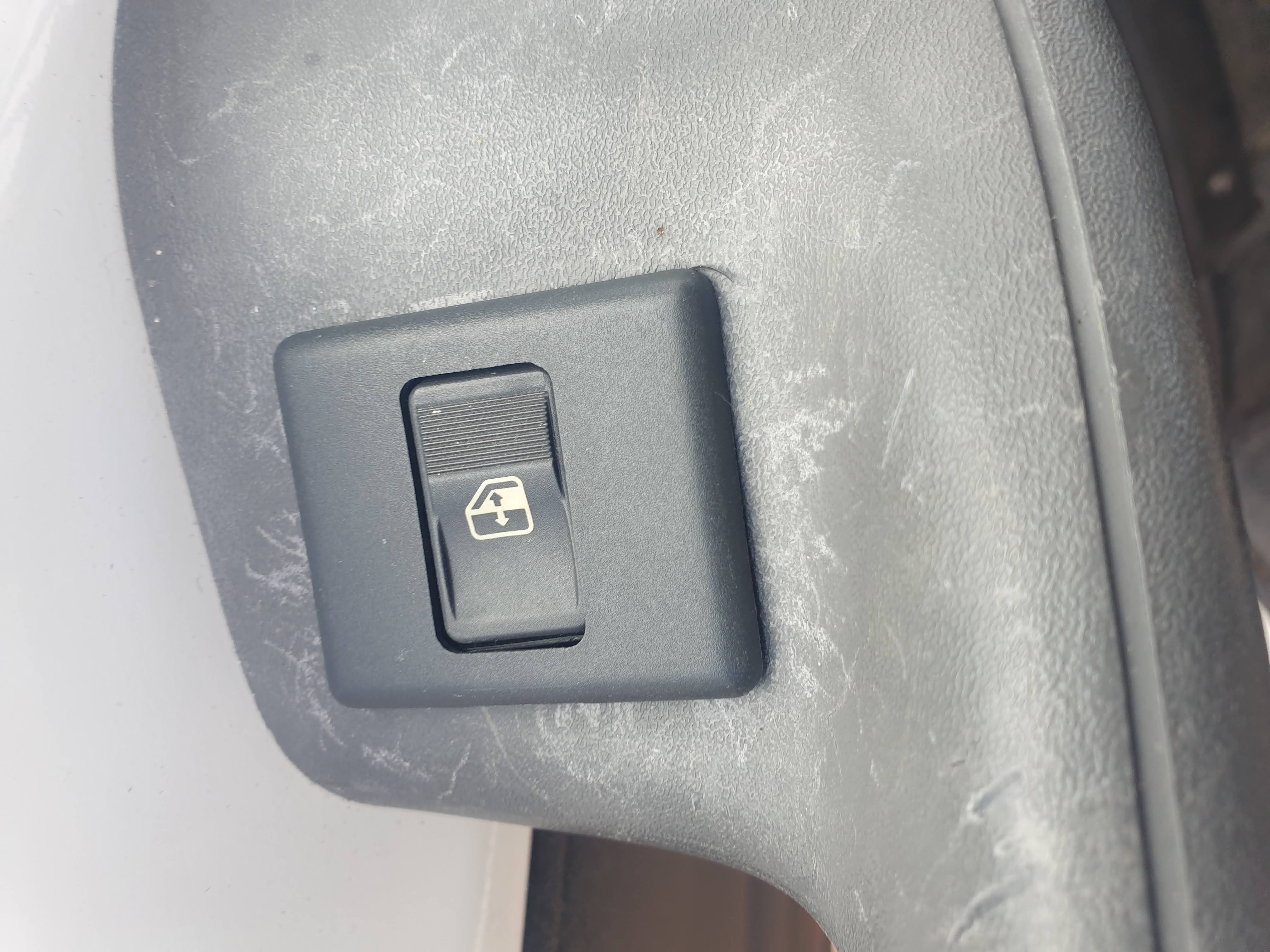

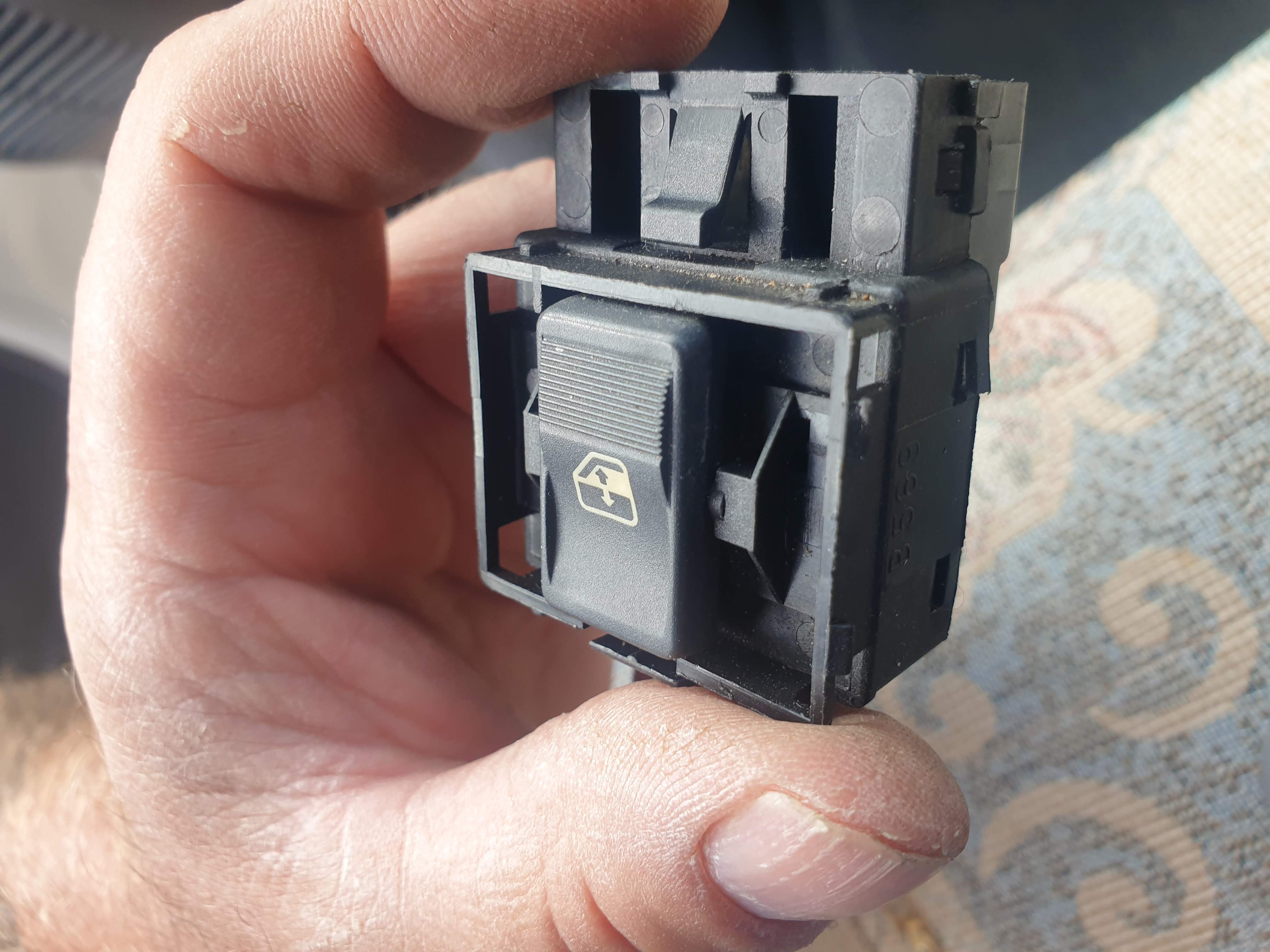

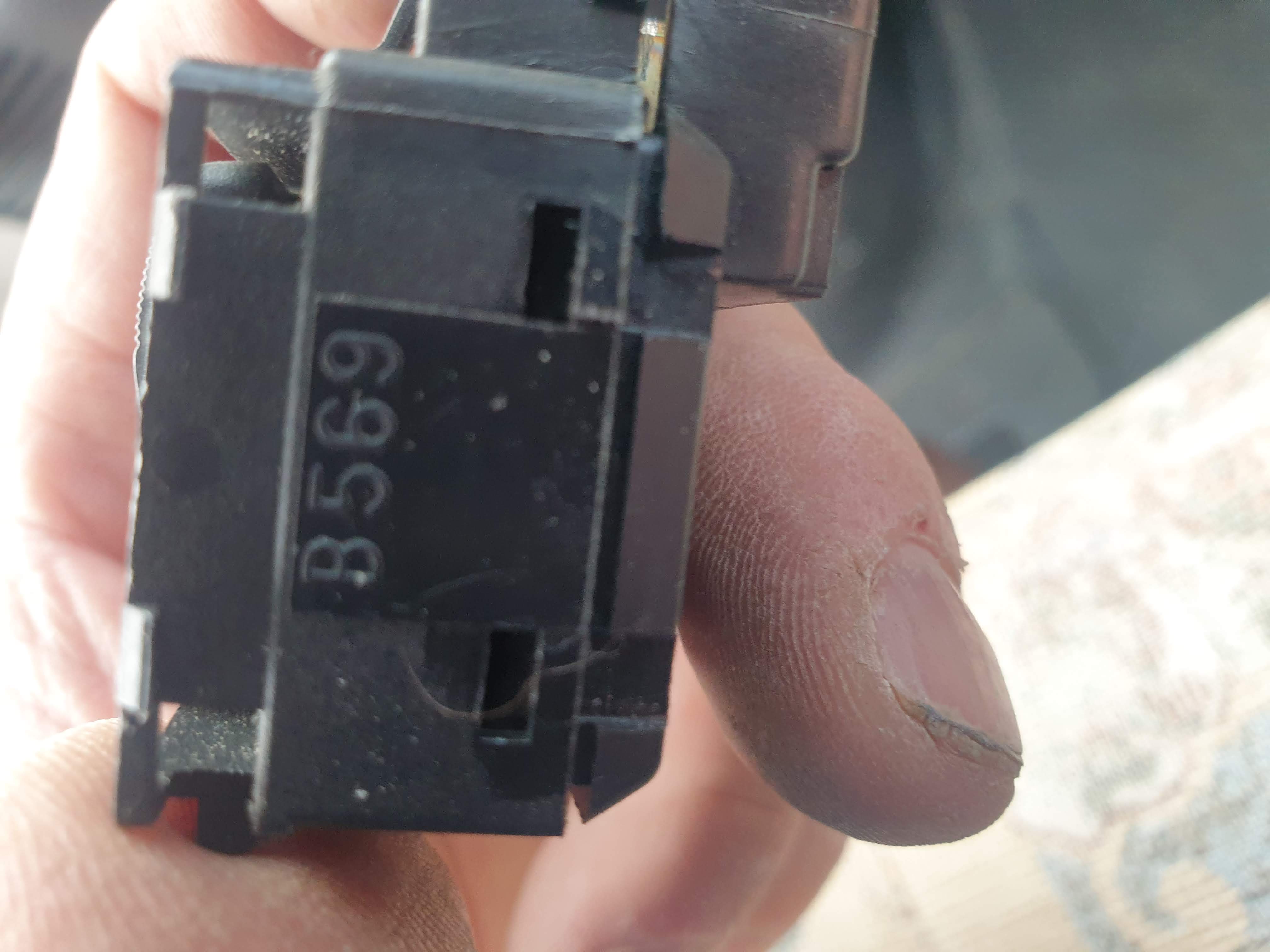

Hi
My passenger side window switch has broken in my 2002 Fiat Ducato Motorhome. I have contacted Fiat UK who told me this part is no longer in production and they have no stock!! the part number is 1310504808. Any ideas where I could get one from. I have attached photo's to see if that.

In a word - difficult. However the window switch is not special electrically. It has the configuration of Momentary ON - OFF - Momentary ON.
It may be possible to fit an alternative switch or cannibalise a new one to obtain a working insert for your old surround. How important are the aesthetics on the finished work? Better a non matching, but working switch.
Coastal Motorhomes offer an Iveco switch which is a possibility, see link.
https://coastalmotorhomes.co.uk/fit...ctric-window-switch-5801304492-2006-2014.html
