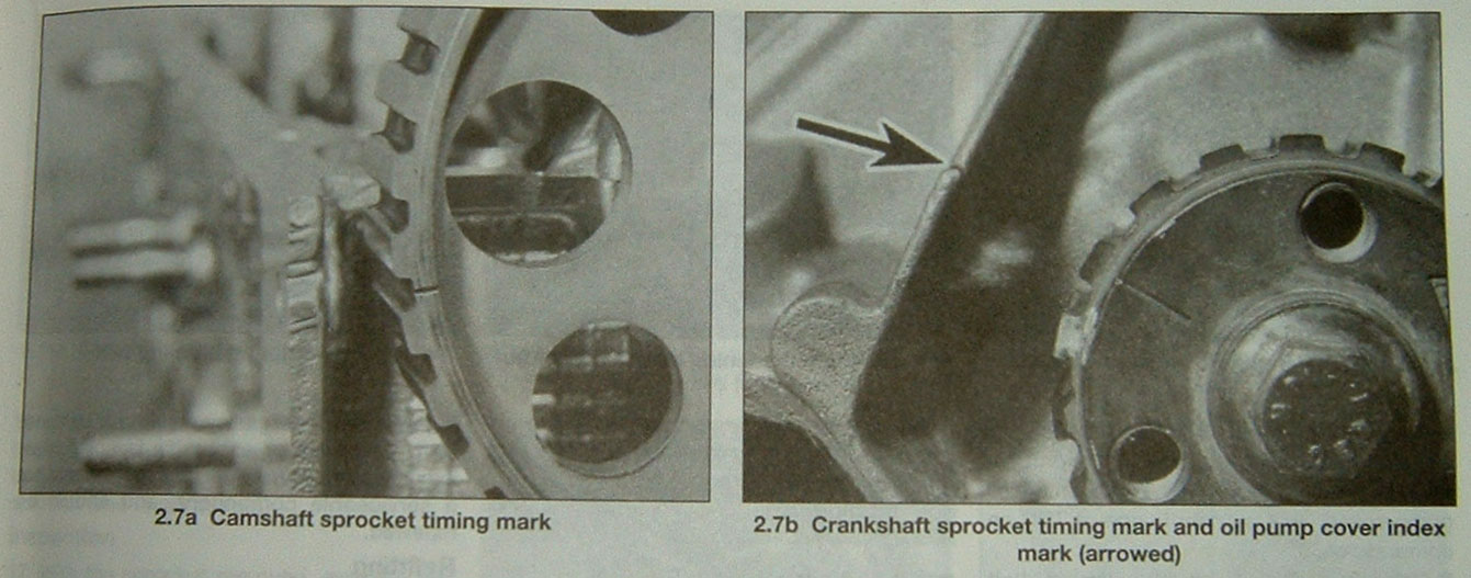

Oh right, you mean the mark on the engine rather than the pulley itself?
It's a bit hard to explain, there's a notch on the oil pump housing next to the pulley. See this attached pic, courtesy of the haynes manual and a digital camera ;)

There is a mark at the cam pulley, after removing the plastic shield. The other is "inside" the gearbox / clutch. Remove the rubber square plug if it hasn´t fallen off already. Align and fit a new belt. Please ask if any questions...

the flyhweel is on the otherside of the engine.. so you can ignore that. remove the alternator drive pulley and you'll see this:
you wont have red painted lines, but they are the bottom end timng marks.

if those marks are lined up, and the cam sprocket is - then the timing is correct.
the aux pulley has a dimple on the back of it - it alligns with a wee nubbin on the crank sprocket. you can just see it at the bottom of the crank sprocket.

If you line up the crank sprocket marks as in that photo, and also line up the cam sprockets - that should be the timing done, and sorted.
Turn the engine over by using a socket on the crank pulley, you should be able to turn it over (if not, take the spark plugs out). Turn it over a couple of times and then re-check the timing marks still line up.
The aux pulley has a slight indentation on the back of it, that indentation lines up with a small lump on the crank pulley. If you look at the crank sprocket and the aux pulley you should be able to see both the indentation and small lump.
