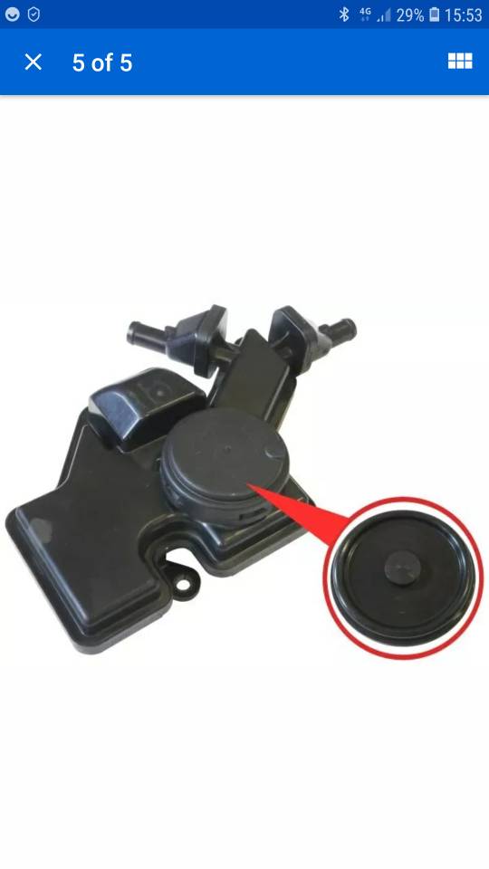

Often when I started the car with warm engine, there came an ugly smell of petrol and engine oil in the cabin. And whenever this occurred the car was slow and laggy, almost cutting out when I set of in first and second gear. It was driving me crazy.
But now I finally solved the problem,
it turns out that my PCV (Positive Crankcase Ventilation) was broken.
I’ve changed it and the car is like transformed, it now pulls smooth and effortless in the gears.
