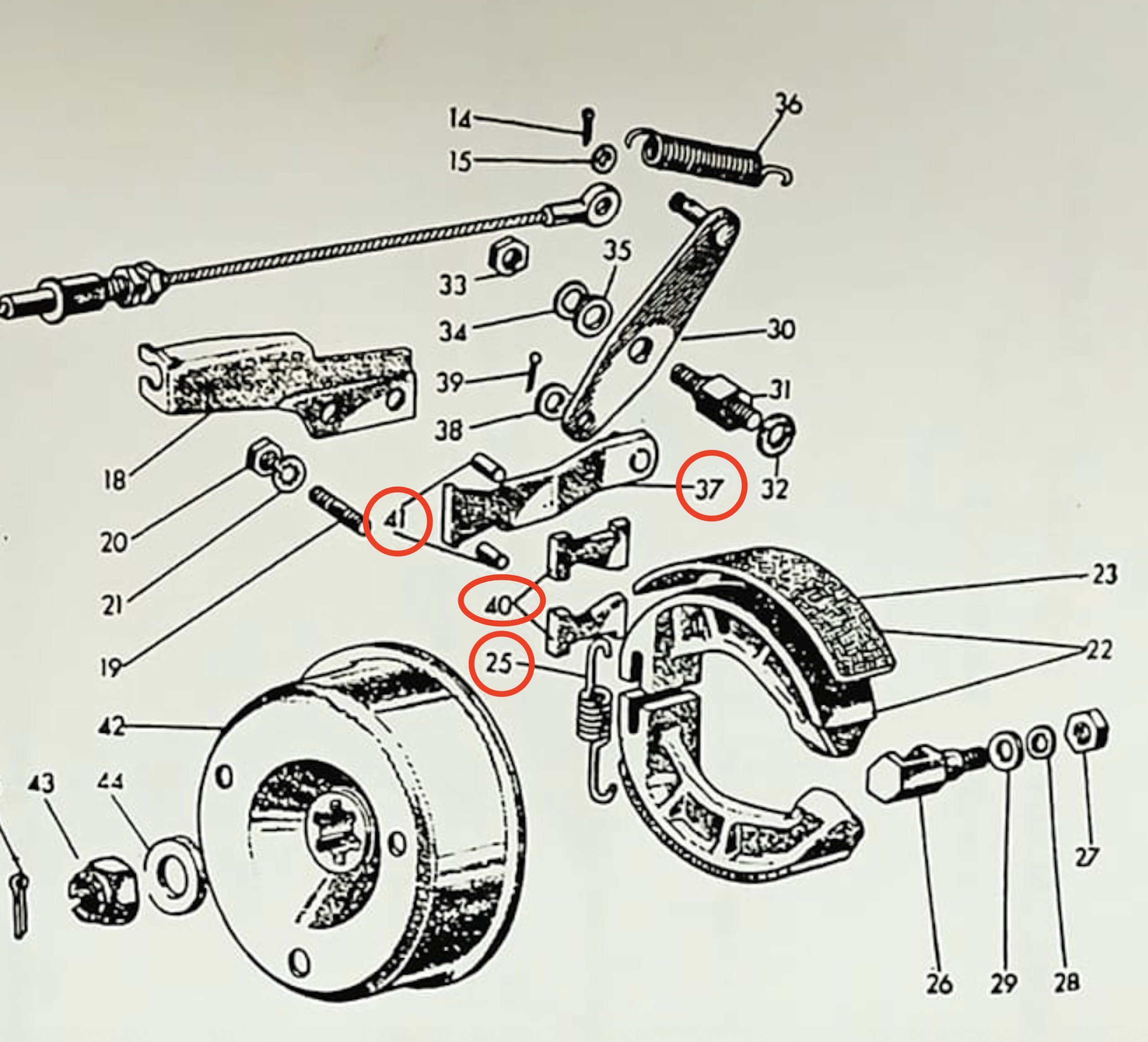

I have a seat 600 from 1961, which broke the handbrake.
The Seat 600 from 61 is the same as the Fiat 600 from 55 mechanically, I am attaching the mechanical sketch.
I would like to ask if anyone has spare parts.
Specifically:
figure 40 - two units
Figure 41-two united
Figure 37- One unit
Figure 25-One unit
Thank You

If not available is there any chance you can get the worn parts built up with weld and ground back to the correct slope, then use some similar size rollers, maybe from a roller bearing?
I know this sounds a bit basic, but if lightly greased on assembly it will certainly work and as handbrake is not something that gets a lot of use, it should last.
However have I misread the diagram , does it use a chassis mounted hydraulic cylinder to work this mechanism when pressing the foot brake, as I know some older Austin A40s and A30,/A35s etc used to do that?
A local engineering firm could probably manufacture something more robust if not possible to repair.
