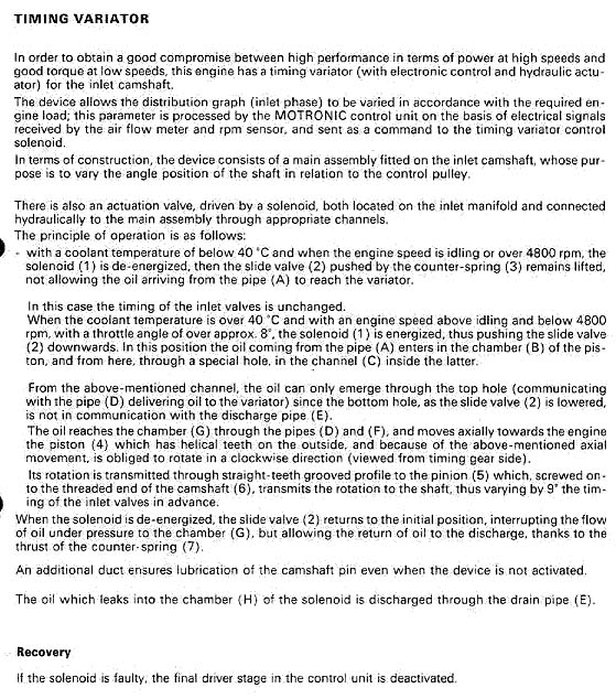

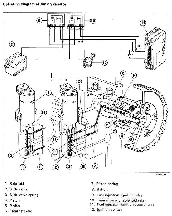

Look at the engine oil filler cap. If you have VVT then there will be a solenoid just behind the cap. About 60mm x 25mm diameter with the plug on top and fixed to the block with two torq screws.
If the timing is already out then the engine could theoretically cut out when the solenoid releases at 4800rpm.

I've had VVT problems (On my P97 147, work that one out). The engine just ran very rought when I came down from 4800rpm as the solenoid was sticking in. I stripped and cleaned the solenoid and put some valve train cleaner into the oil. SAve d me a £300 bill from Fiat just to look at it.
