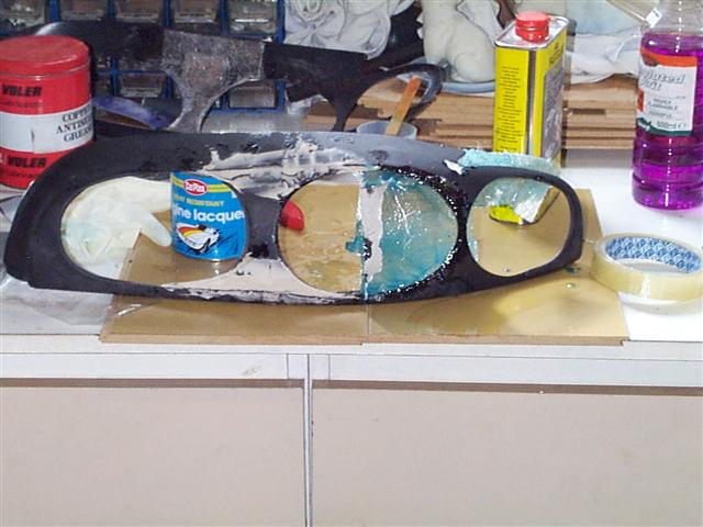

I never thought about taking any pics until I'd already moved the central headlight pillar, so i'll start with stage 2. All I did in phase 1 was to cut out the pillar and stick it back with a few tweaks with some GRP.

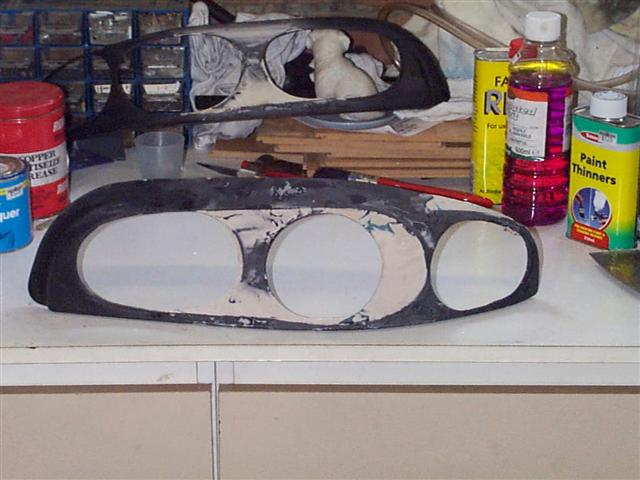

Next I opened out the indicator holes. I would have liked to make them a bit bigger but decided to keep a bit of the existing plastic to brace the next lot of GRP.
Anyone for shreddies? A bit of poly bag and cardboard = instant mould.
And the result...
If you are wondering why its blue... its cos I used an old brush with blue engine lacquer on :eek:

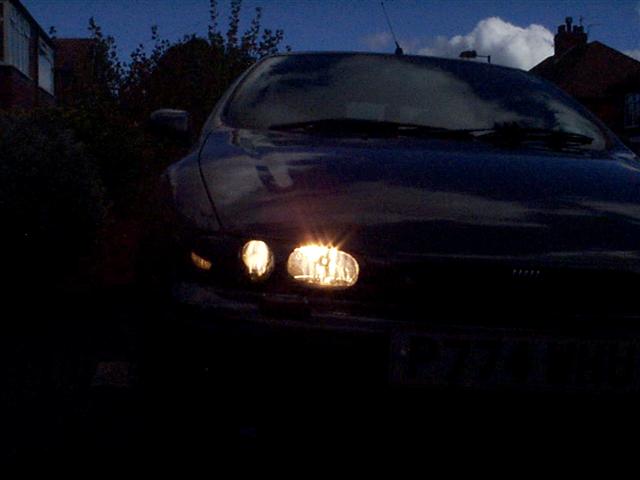

Couldnt resist a test :D

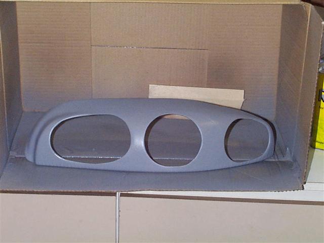

Smoothed down ready for priming.
Plastic Primer applied.
Hi-build Primer for final smoothing out.

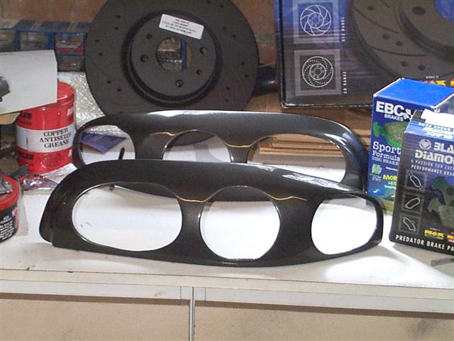

Rear one has been flattened ready for cutting and the front has been cut.
Polished and ready to fit. :D

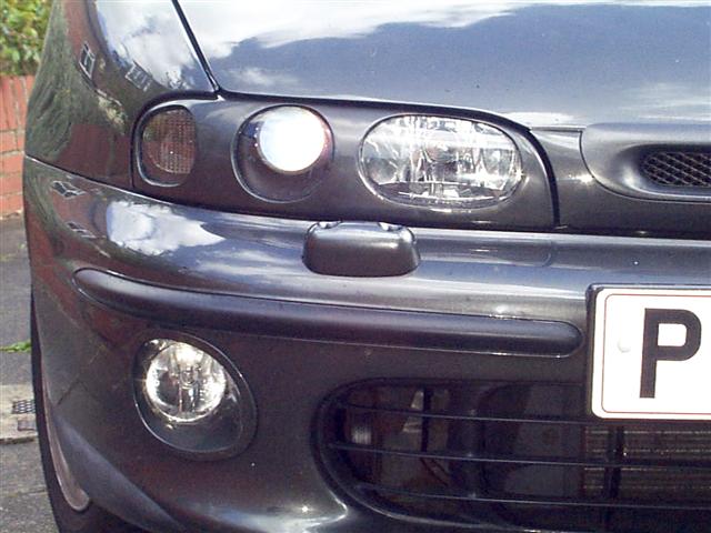

Thanks everyone :D They are on the car now. Pics to follow.
