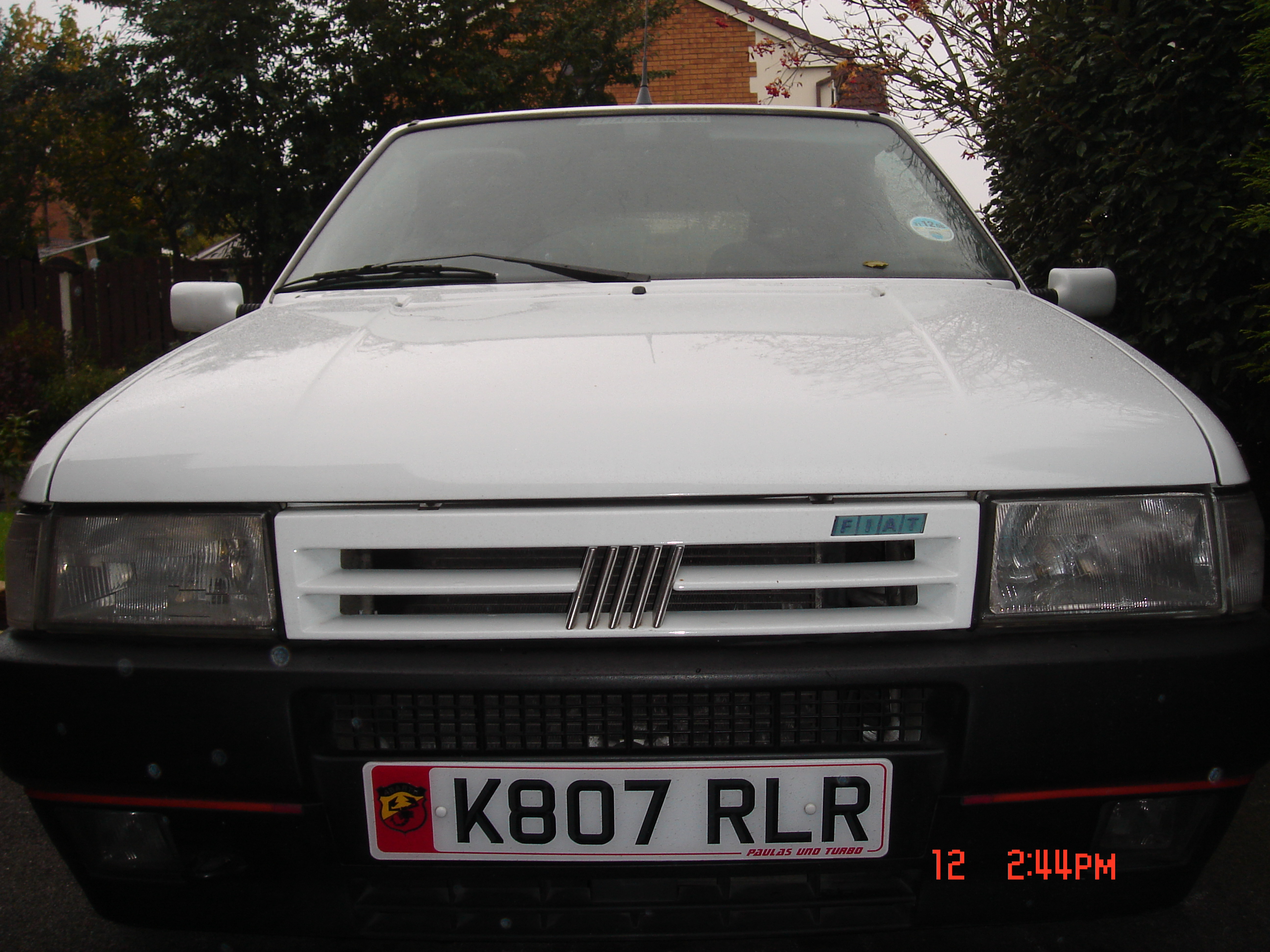

Hi uno lovers, i've just posted a thread and pics on turbo collective about bleed valves, as im fitting my new techniclutch and lightened flywheel before xmas and want to turn the BOOOOST!!! up, but theres to many valves to choose from, idealy want to fit under the cig lighter ashtray flap on the mk2's so is adjustable from the cockpit, then a friend of mine said the proper way is the performance actuator, which way do i go, what is everone using, your experiences, also thinking of putting a fpr on and have seen one on ebay with a built in pressure guage under uno turbo section, just that there seems to have been a few probs with the usual boost valve setting up overfueling etc, and that ones got the guage, anyone got one
