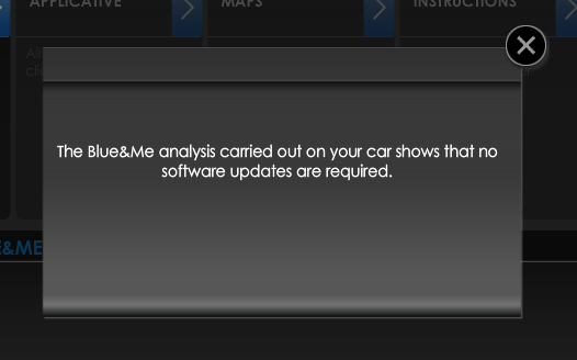

Here is how to update Blue and Me now that Adobe Flash has been disabled.
Install a linux virtual machine using these instructions:
stackoverflow.c_m/questions/65327754/virtual-machine-container-that-we-can-play-flash-clients-after-jan-12-2021
When you install virtualbox you'll need to install the extensions update so you can read and write to a USB stick: virtualbox.o_g/wiki/Downloads
Now you can run Firefox with Flash and access the blueandme.net site.
LOL, turns out there is no update for my Fiat. That sucks because it drops Bluetooth connections after a few minutes.
